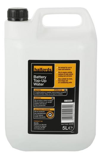

I know there are arguments that "proper" distilled water is better? but I've been using this stuff for years now, mixed 50/50 with concentrate, and it seems to work well. Even cheaper if you have access to a Halfords trade card.
