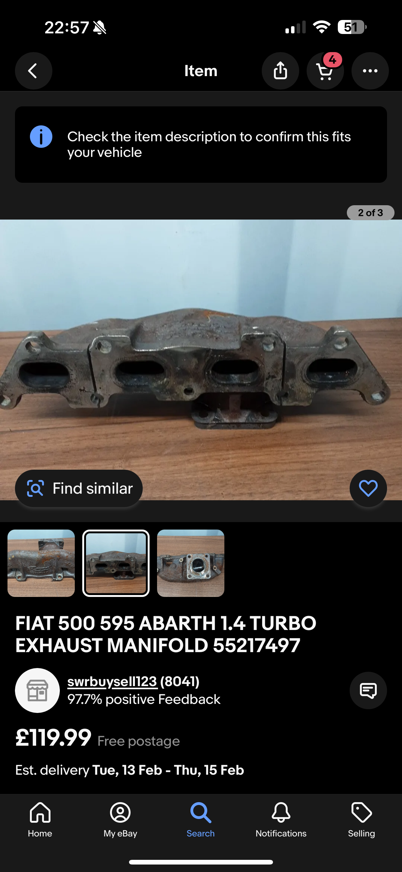

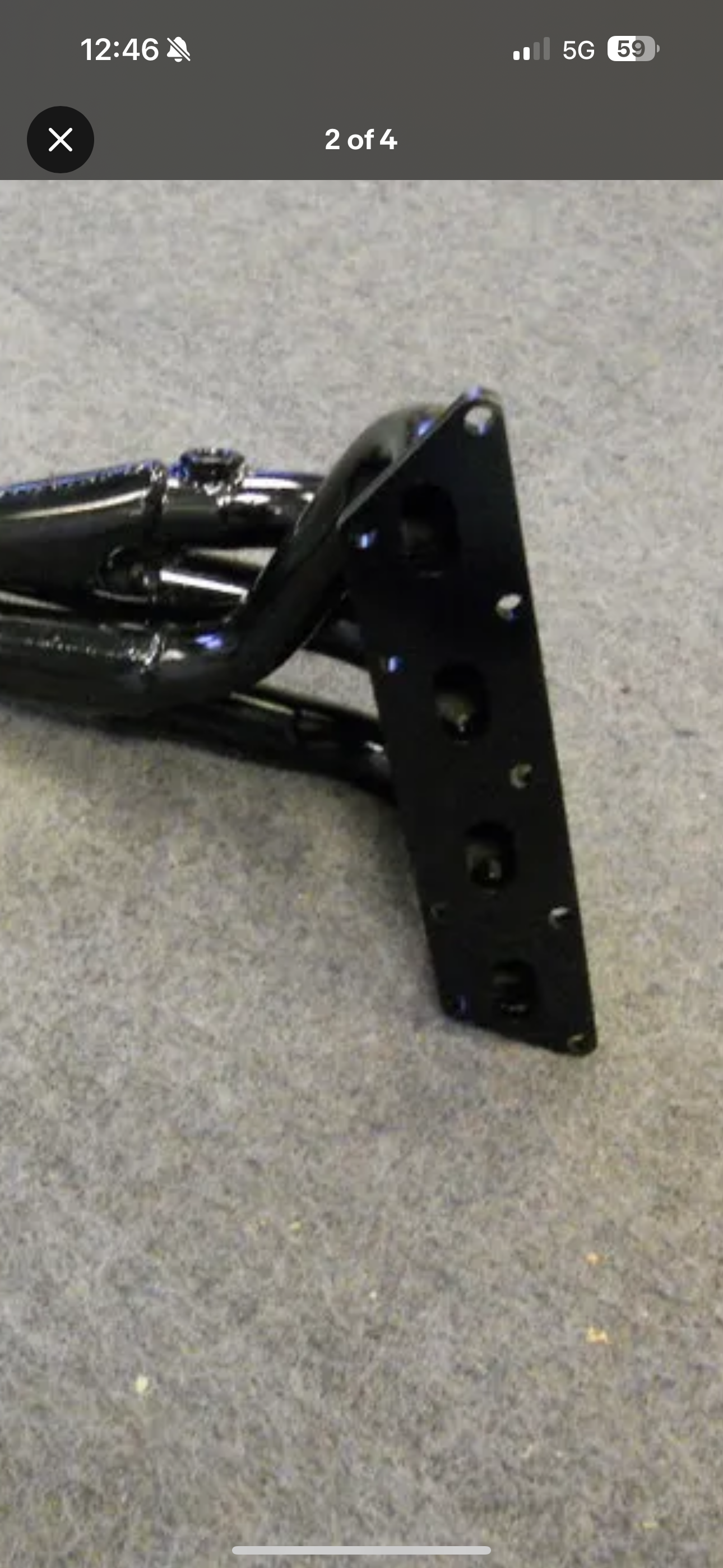

Hello everyone, been trying to wrap my head around a relatively cheap but effective way of fitting a turbo to my 1.2 16v Fiat Punto 188.
Looking at the NA decat manifolds I noticed the mounting holes look very similar to the bolting pattern on the 595 abarth manifolds. Any idea if they do bolt straight up?

The turbo In the abarth 500 is squeezed into a very small space and very lacking in air flow around the engine. As a result the engine while powerful was compromised in terms of heat soak and other issues. The exhaust manifold it very short, it is probably not the best design. The Mk2 punto has a much bigger engine bay than the abarth 500 so If you are technically able to do things like fitting a set of of throttle bodies, and you're comfortable with aftermarket engine management etc, then why not just get a nice stainless down manifold and have a turbo mount welded on exactly where you want/need it. also much lighter than the clunky cast iron thing posted in the picture above.
