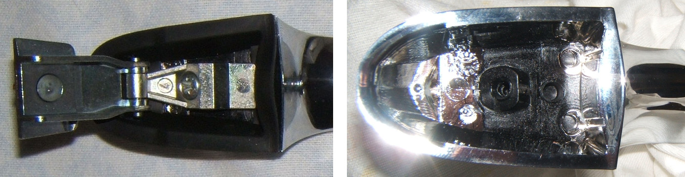

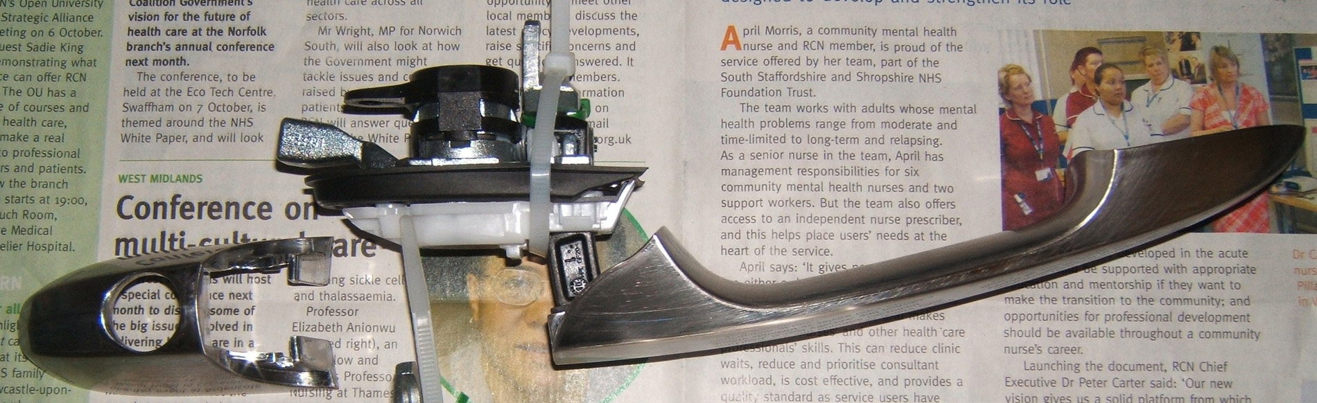

First remove the front hinge and weather seal, this is just one Philips screw.
I used cable ties to hold the handles in the open position. You can then paint in all the gaps with ease.
