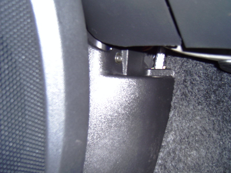

There is 1 screw to unscrew to take the trim off so u can then run ur cable to underneath where the pasenger seatbelt is which is here:
Once the screw is removed the whole strip is only on clips so just pop off.
