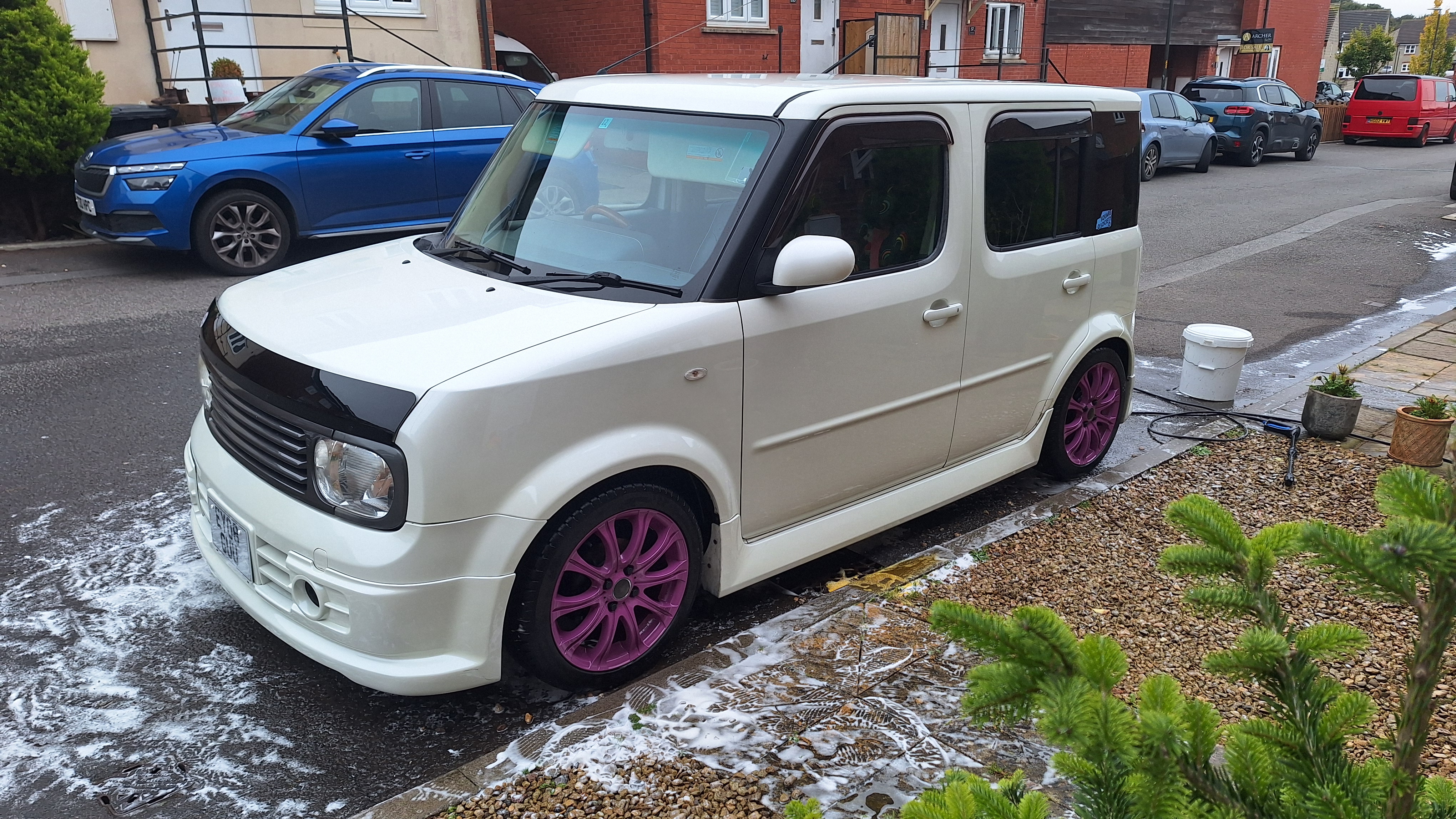

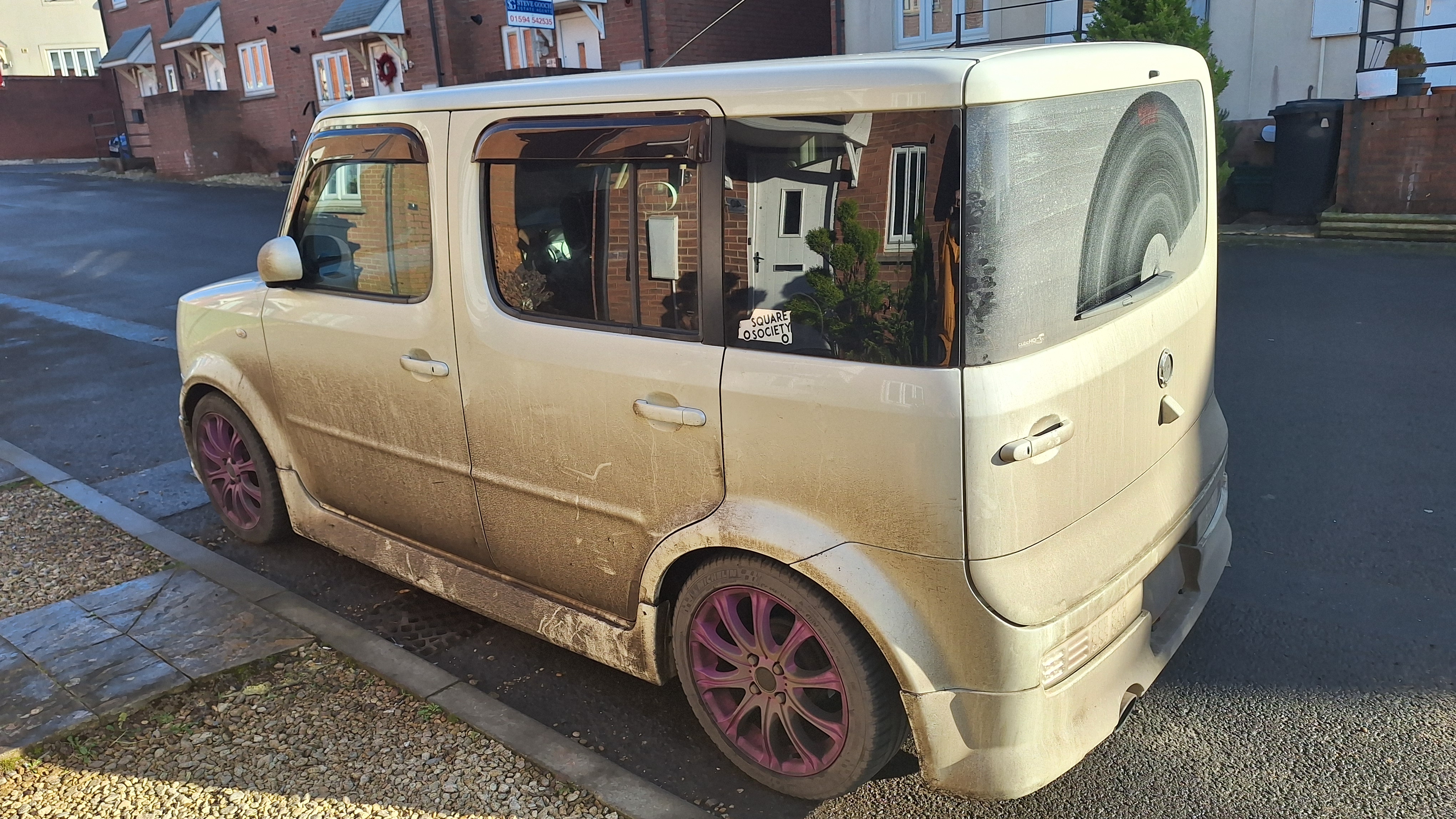

So got it some proper tyres now the weather is turning.. Back to my faithful Michelin PilotSports. But we have moved from 195/45 to 205/45
But decided I hate the black too much to have them just put on so took them to a local place for a colour change.
Went to change wheels and found a punctured tyre 🤦 so had to steal the TE off the Suzuki for a week. Which the Mrs hated but I think looked awesome
Anyhow, your either gonna love this or you are gonna hates, I doubt there will much in-between on this one....
I really need to wash car for full affect.. soooooooon. But I'll just say, they are purple and look way more purple than how pink they look in the pics.
Sorry not sorry, I love it! 😂
