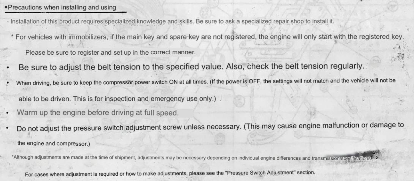

It is very odd, I wonder if there was a loophole somewhere it was needed for re. Japanese inspections.
My reading of the warning about not using it would be it seems it was mapped for boost...so switching off will likely make it run rich but that's a total guess.
That is my exact same opinion @StevenRB45 - the fuelling will be off and its probably pulling timing as well. It makes sense to me now I read the manual and thought about how its all working. It doesn't have a bypass valve or anything so all the air is going through the charger whether its on or not, driving it without it on is also going to be like pulling through a huge restriction. But also means it is genuinely really important the clutch lets go at idle and on decel and that its not designed to be off. But I'm not worried, its working properly now its on all the time, and I don't see how not having it on would damage the charger.
I've just taken it to fill up petrol, first proper drive and I need to tighten the belt a smidge. It squeaks on start-up and every so slightly under load I can hear it slipping. I expected this mind, I didn't want to overtighten it.
With regard to the on/off switch, its saying its there for install and testing. Seems many don't have the switch even. I am very glad I read this and tested it though, drives so much better now that it ever has, on or off - and as previously said, pretty sure it would damage the charger with the clutch engaged all the time.

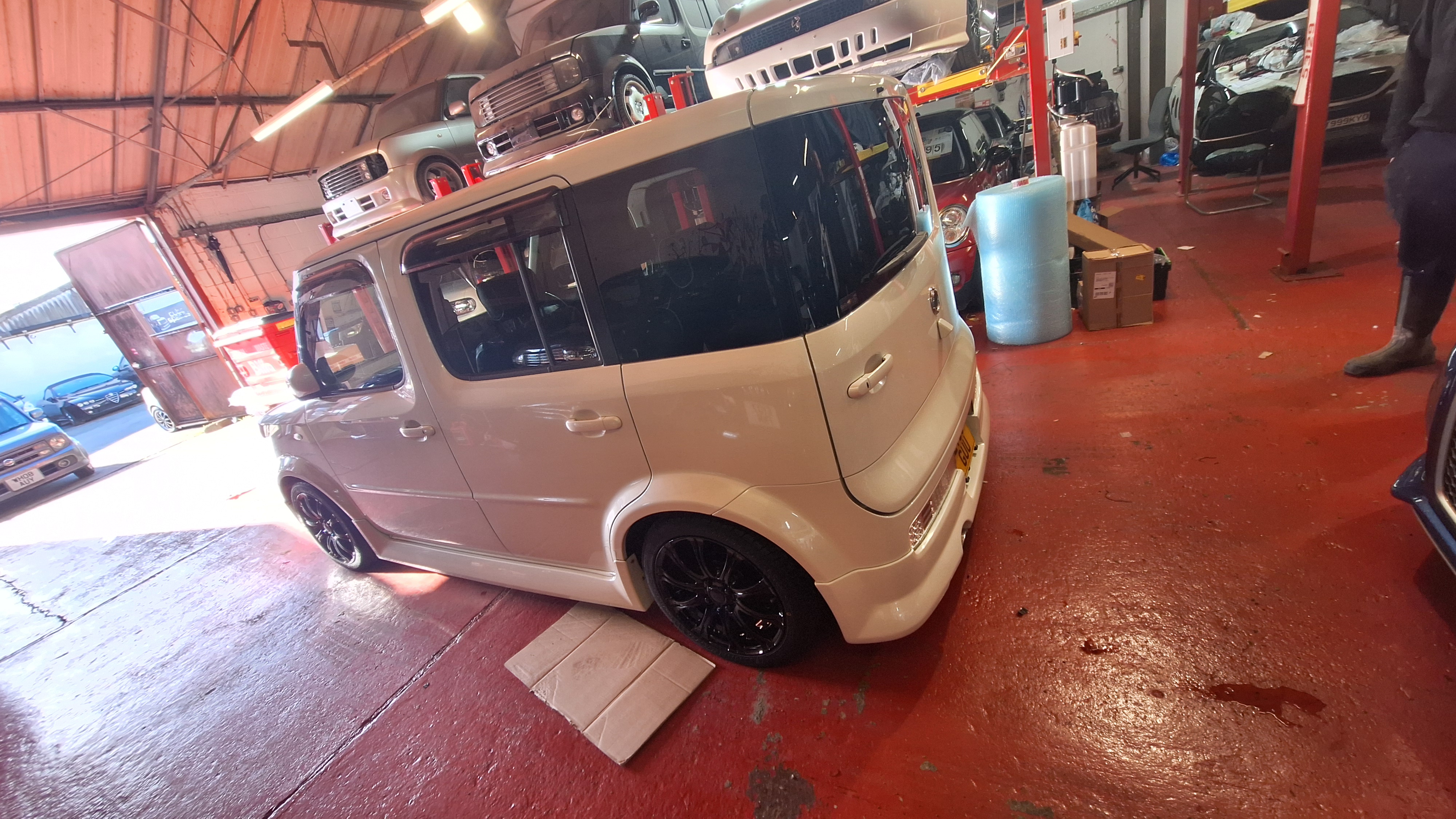

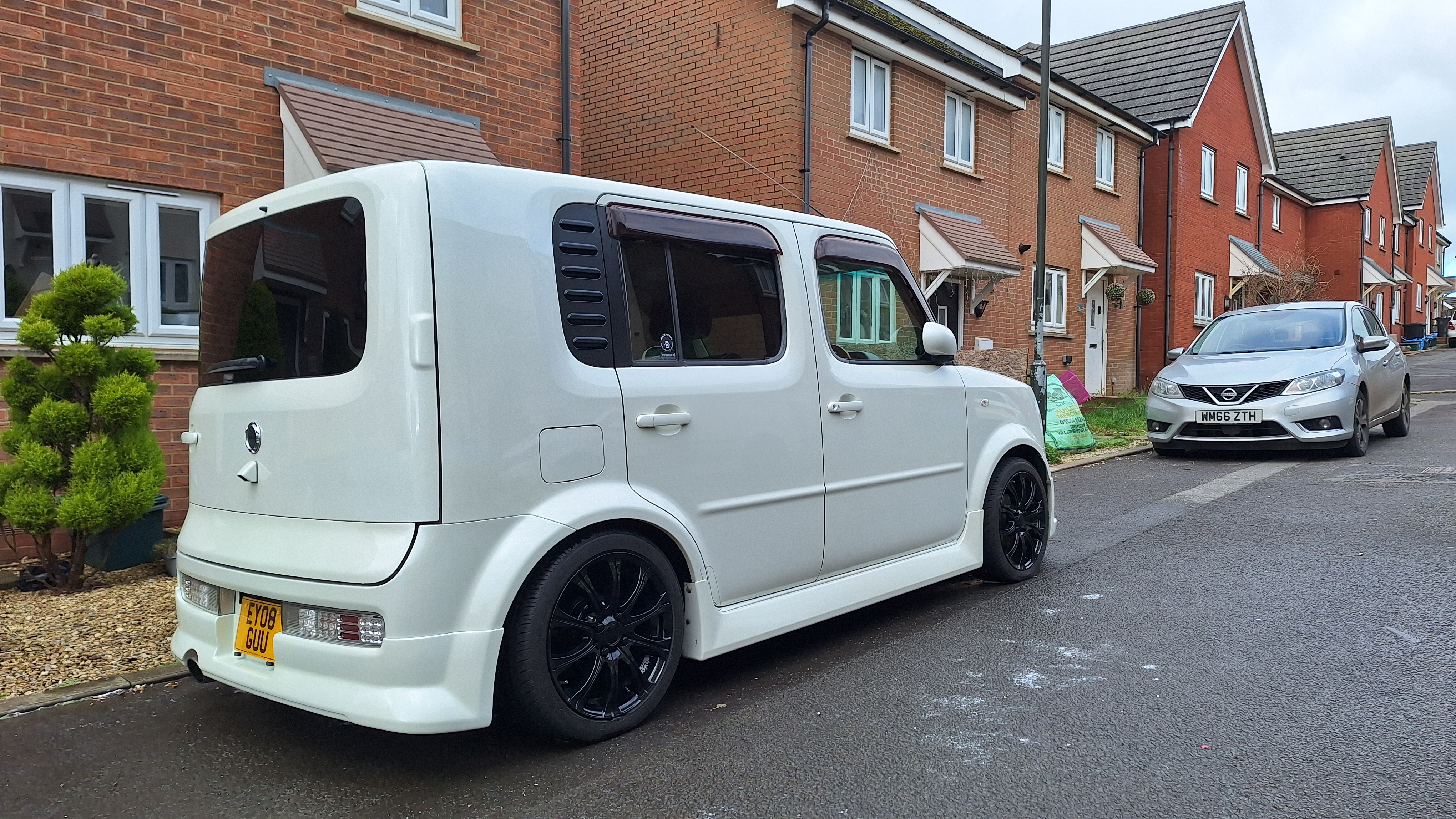

So got it some proper tyres now the weather is turning.. Back to my faithful Michelin PilotSports. But we have moved from 195/45 to 205/45
But decided I hate the black too much to have them just put on so took them to a local place for a colour change.

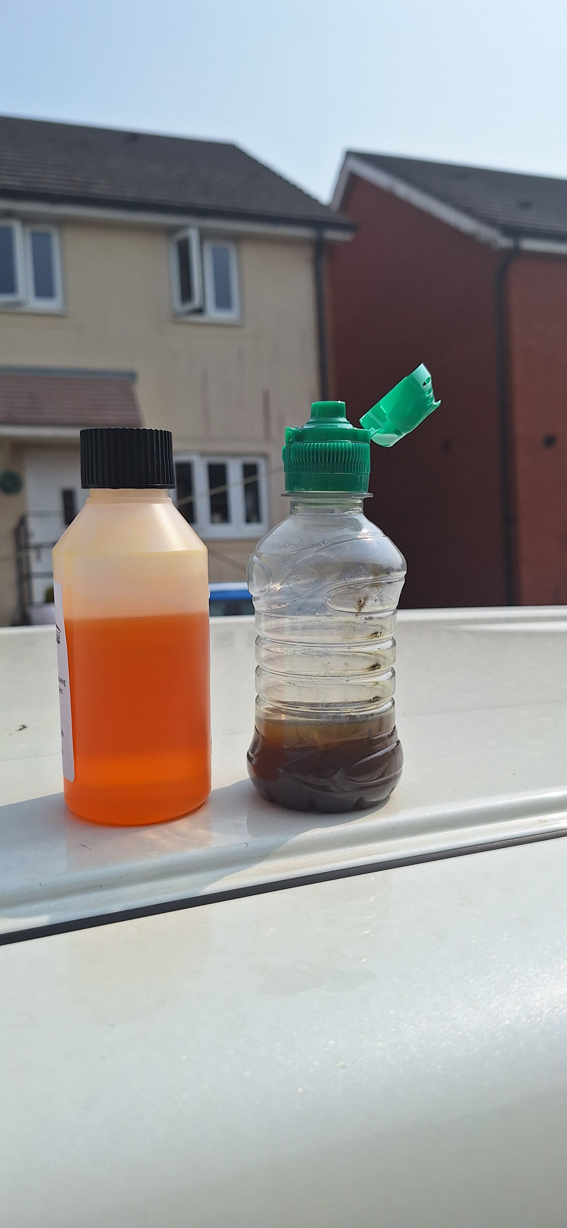

I did oil and filter and air filter recently, i was going to do the cvt gearbox oil change at same time but i was time challenged that day and on checking the oil it still looked brand new so I left that for a later, warmer day. Whilst under there though noticed both inner CV boots were not too hot and one had just started flinging grease and that the rear engine stabiliser dogbone thingy was also on the way out, and a very feint knock i decided was probably a drop link so swapped both them too.
