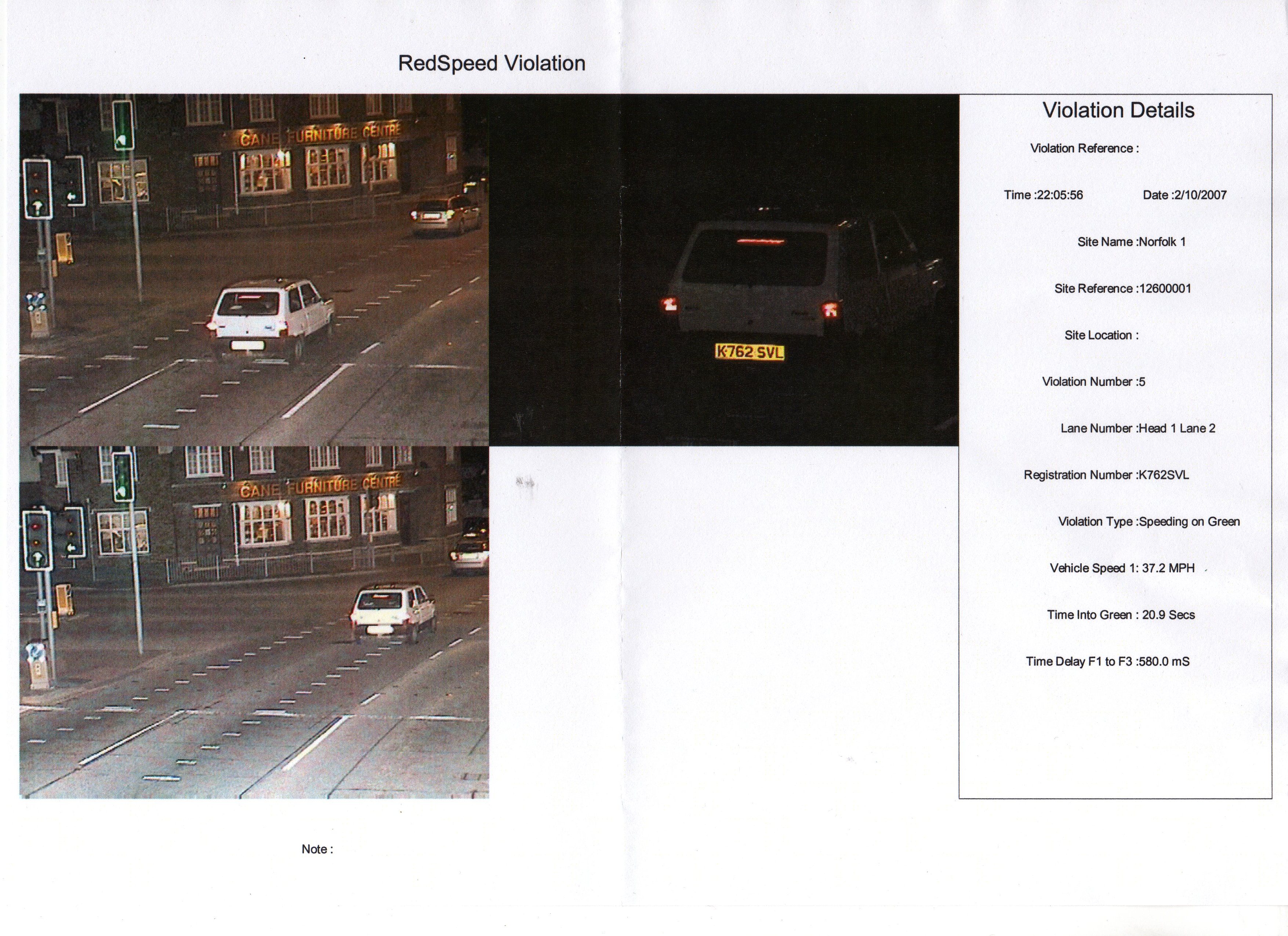

Hi all. Had a slight laps of concentration on 2nd Oct and got flashed by one of the 2003 red light / speed cams traveling at 37 MPH.
I have got a copy of the photo's taken, and have worked out my speed to be 34.7 MPH. Does anyone know if this is worth contesting, and if I've worked out my speed correctly?
I've calculated my speed using the secondary check line (the white lines at speed cameras) Which have been confirmed to be placed at 1meter appart at the site I was cought.
The following I found on the internet:
'Calculate distance travelled by multiplying the number of lines (between the two photo's) by the distance apart (e.g. 8 lines is 8 x 2m = 16 metres) and divide this by 0.6 (or 0.5, 0.7 etc., the time between the two photo's) to bring it to metres per second. Multiply the result by 60 to get to metres per minute. Multiply this by 0.0006214, the conversion factor to get to miles per minute. Finally multiply this by 60 to get to MPH.
Using the 16 metres figure, as in the example above, comes out at 59.654394 MPH.'
and using it and changing it to 1 Meter rather than 2 I got the following.
  1. 9M / .58 = 15.517241379310344827586206896552 Meters per second
  2. 15.517241379310344827586206896552 X 60 = 931.0344827586206896551724137931 Meters per min
  3. 931.0344827586206896551724137931 X 0.0006214 = 0.57854482758620689655172413793103 Miles per min
  4. 0.57854482758620689655172413793103 X 60 = 34.712689655172413793103448275862 MPH
Looking at the pic would everyone agree that I covered 9 meters? or 9.64meters which is what is covered if I were to have been doing the 37MPH.
Thanks all.

Well, I agree with your maths. It looks like you'd covered 9m, assuming 1m increments, and 9m in 580mS works out at 34.7MPH, on my calculator at least.
Is it worth contesting? Hmm. It looks as though you *were* speeding, and by more than the 10% margin allegedly allowed for speedometer error. So even if you can prove the Cash Machine is incorrectly calibrated, you're still in the wrong. And let's assume you were doing 37.. if your speedo is anything like mine, 37 in real money (GPS) = mid forties on the speedo.
Yes, we hear of cases getting thrown out on technicalities, and tales of prosecutions being withdrawn if you ask for a calibration certificate for the camera in question.. it's really up to you if you feel lucky (or have a barrister as your best mate ;)). If you contest it and still get done, they'll just hit with a bigger fine to teach you a lesson..

I compiled the following formula myself to verify the formula you found...
Use the following variables:
d = distance travelled (meters) = 9 (we are assuming 9 meters)
t = time between frames (ms) = 580
d/t*1000 = meters travelled in 1sec
d/t*1000*60 = meters travelled in 1min
d/t*1000*60*60 = meters travelled in 1hr
d/t*1000*60*60/1000 = speed in kmph
Simplified:
d/t*3600 = speed in kmph
We know that 1 kmph = 0.621371192 mph, so...
d/t*3600*0.621371192 = speed in mph
Simplified, the formula is:
d/t*2236.9362912 = speed in mph
where d=9 and t=580
speed in mph = 34.7
to me though, that pics looks like you were over 9 meters but under 10 so i tried with 9.5m...
where d=9.5 and t=580
speed in mph = 36.64 mph
Still a little out, so i rearranged the formula to figure out the distance the camera assumed you'd travelled...
s = speed in mph
d/t=s/2236.9362912
d=s/2236.9362912*t
d = 9.65m (where t=580 and s=37.2)
I always worked on the principle that they allowed you 10%
ie. 30mph - 33mph
40mph - 44mph etc.

How hard were you braking?
The camera works out your speed before taking the pictures (otherwise it would flash everyone) And that will be the speed on the ticket.
In both pictures you are braking and presumably slowing down.
After the flashes you checked your speed and it read 35mph. Given your speedometer reads 80mph when you are doing 70mph. This implies 35mph equates to an actual speed of about 31mph. You had probably slowed down a bit by the time the camera flashed and you checked your speed, so lets say the 2nd flash went when you were doing 32mph.
This suggests your first picture was taken with you travelling at 37mph and the second at 32mph so the average over the 9m will be about 34.5mph.
QED ;)

I know that technically its suppost to read your average speed between the two pics. I was braking through both pics, but not to hard. It was the the bottom of a hill, and being auto dosen't have much engine breaking, so was just generally breaking.
I know you can ask a police man for a calibration certificate for a speed gun. So maybe for this aswell. If you say your Panda, due to age/wear and tear etc your speedo is out by 3mph. Then show them your calculations. Could work
I took the fine and points in the end. As a young driver I couldn't afford the 6 points I could have got if I appealed, it went to court, and lost. The car does over read by 10% even though it had only done about 17000miles at the time.
I would have fought it if I wasn't within the 2 years - 6 points and a ban zone on my lisence.
Apparently the camera 'calaberates itself automatically' daily because its digital, but I said thats rubbish because it can still miss read. At the end of the day the secondary check lines are there for confirmation, and they confirm otherwise in my favour.
I'd strongly recomend that anyone who gets a letter though the door gets the pictures and works it out manually! Surprising how wrong the cameras can be.
