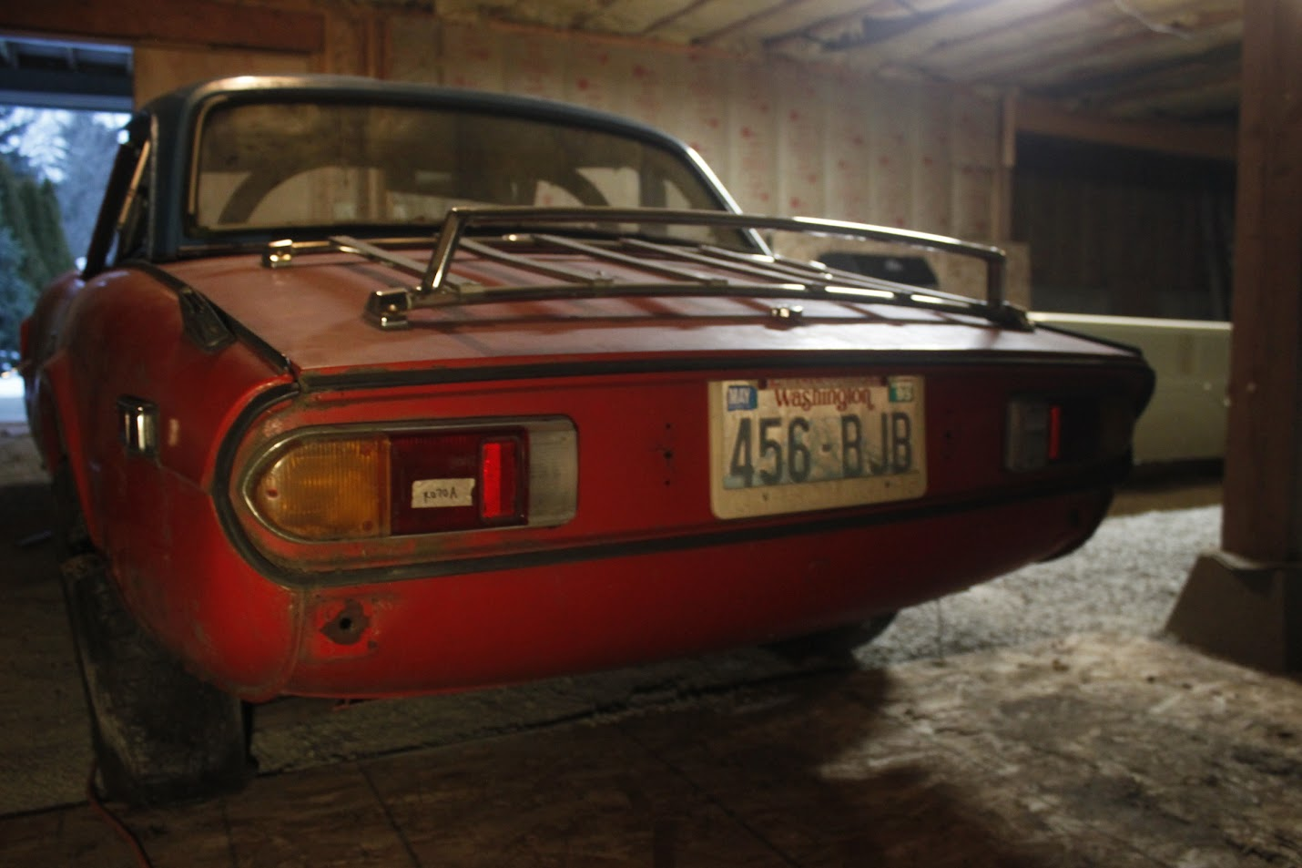

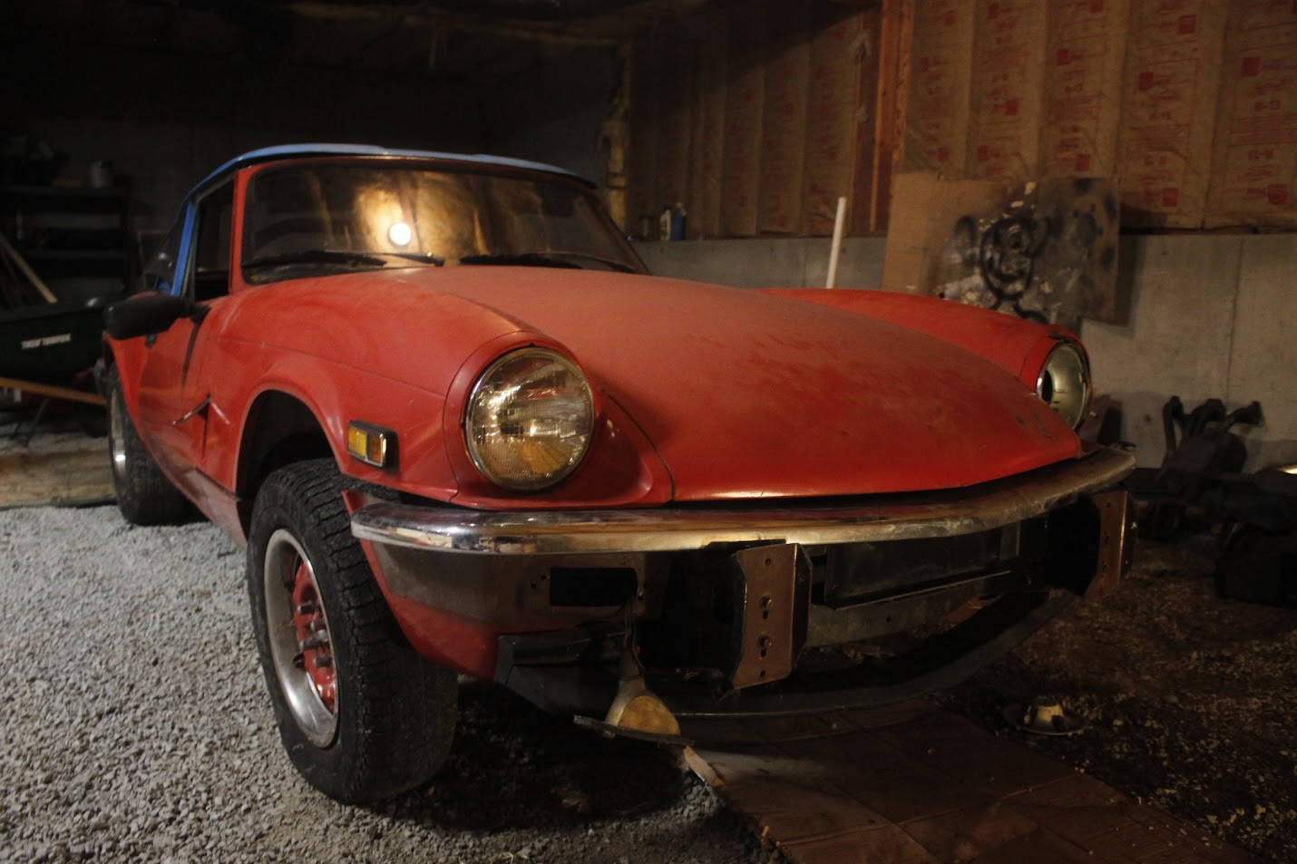

Also, I need to get this guy road-worthy first:
I will be putting this in Member's Motors soon so you guys can see more details.
