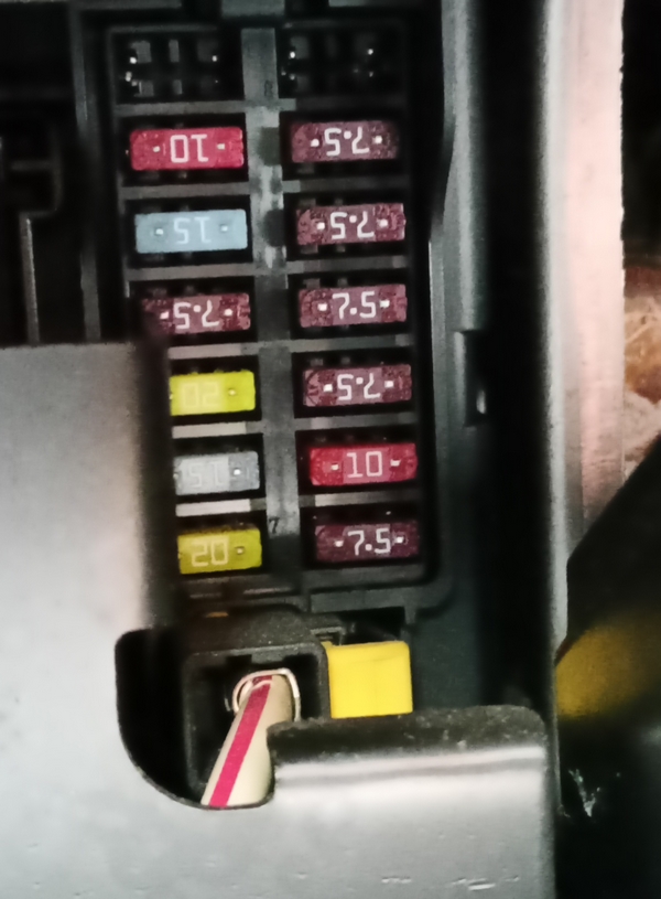

I was having too much fun with the radio and blew a fuse, the one on the radio itself is ok. I searched these forums and google but can't find the fuse. It'll be one of those in the gloxe box, any idea which one?
Ok.... I was browsing this on the net and it sent me back to here.
My question is, the wife's 2012 Punto has had no interior light for ages. I replaced the bulb twice thinking this was the problem. When I open the door ( N/s or O/s) the dash binickle the little bit with the mileage, etc lights up.
So the sensors in the doors work.
It has not got a rear hatchback light neither. So after almost three years spent trying to find the fuse that controls it ( so I can either replace or check it.
Where is the fuc&???!!
3rd fuse on left apparently.
Thanks! I'll have a look at that one. My manual just doesn't list any audio fuse at all. There will be a reason for this, but its something like they forgot!
It explains in the link that the Italians did a flip reversal of the interior fuse boxes in the manual meaning they mirrored it. The actual layout for U.K. versions was different to the manual!! They love to keep you guessing eh😂

Try fuse no 9 - 7.5 amp…. Interior lights
That was the right one, thanks. I had to put in a 10amp fuse rather than the original 15amp because that's all I had spare.
