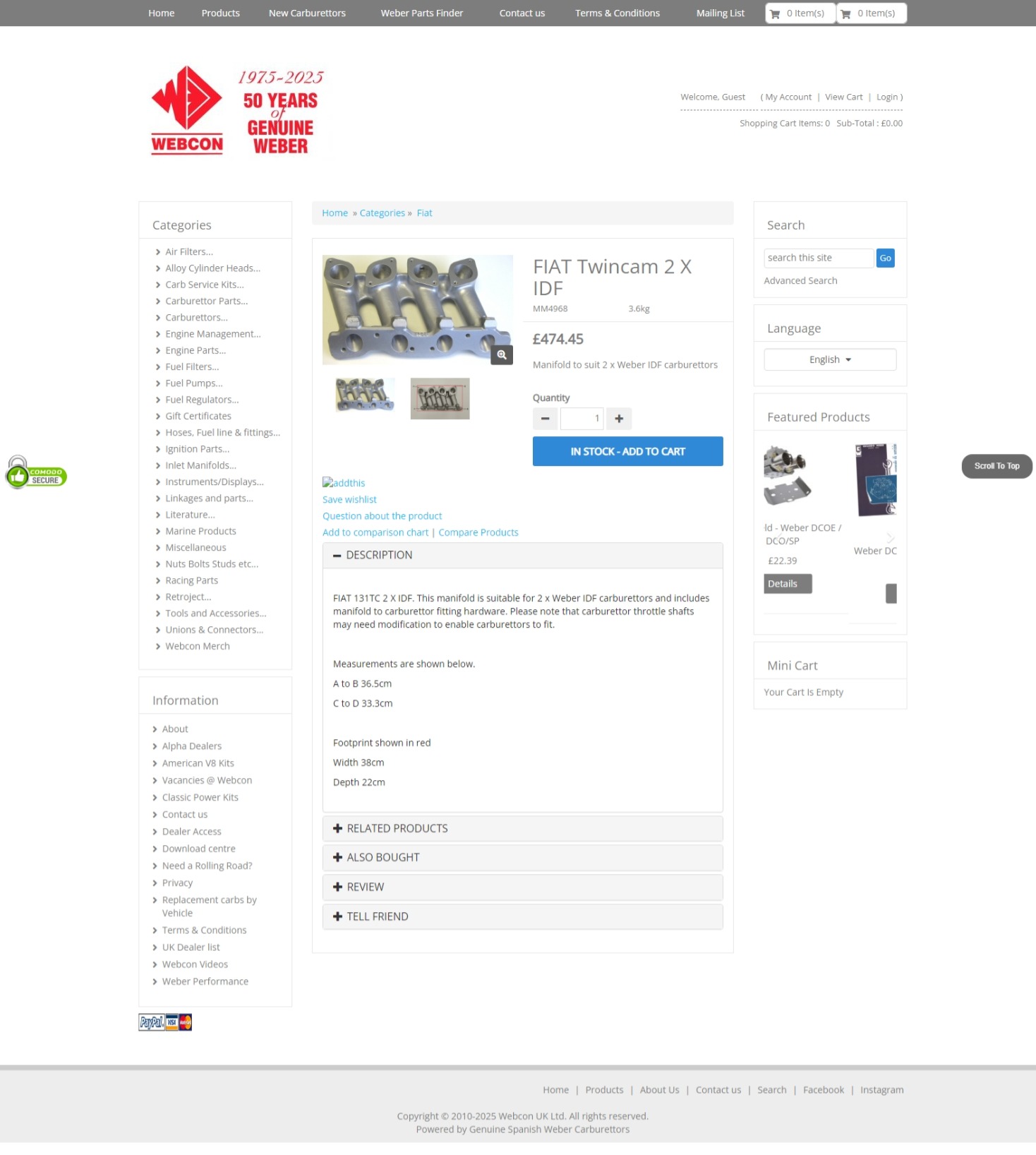

Webcon in the U.K. offer an offset inlet manifold: -
Iirc, they used to offer a full kit including the correct 40 IDF's (or 44 IDF's if you preferred, kit ref. PF1201) but now seem to just offer the manifold and mention the problem with the throttle shafts- they do helpfully provide dimensions of their manifold so you can measure up to check it's suitability.
However, throttle shafts can be shortened or alternatively perhaps even replaced with the correct one's - they do stock lots of Weber carb parts.
So, not impossible for someone who know's what they're doing...
Re - rebuilt engines/tuned engines - one of the U.S. major parts suppliers (I supplied a list of these suppliers to someone on here some time ago) for the 124 Spiders lists Fiat T/c engines of various capacities both fully rebuilt or indeed tuned from c. $5000. From the description of the work they carry out, it seems like do a comprehensive job and iirc, they'll supply a dyno sheet for the engine. They usually require a core engine to be supplied (in advance or possibly? afterwards to get a refund of the core deposit), but given shipping costs and currency exchange rates this is really only suitable for U.S. residents.

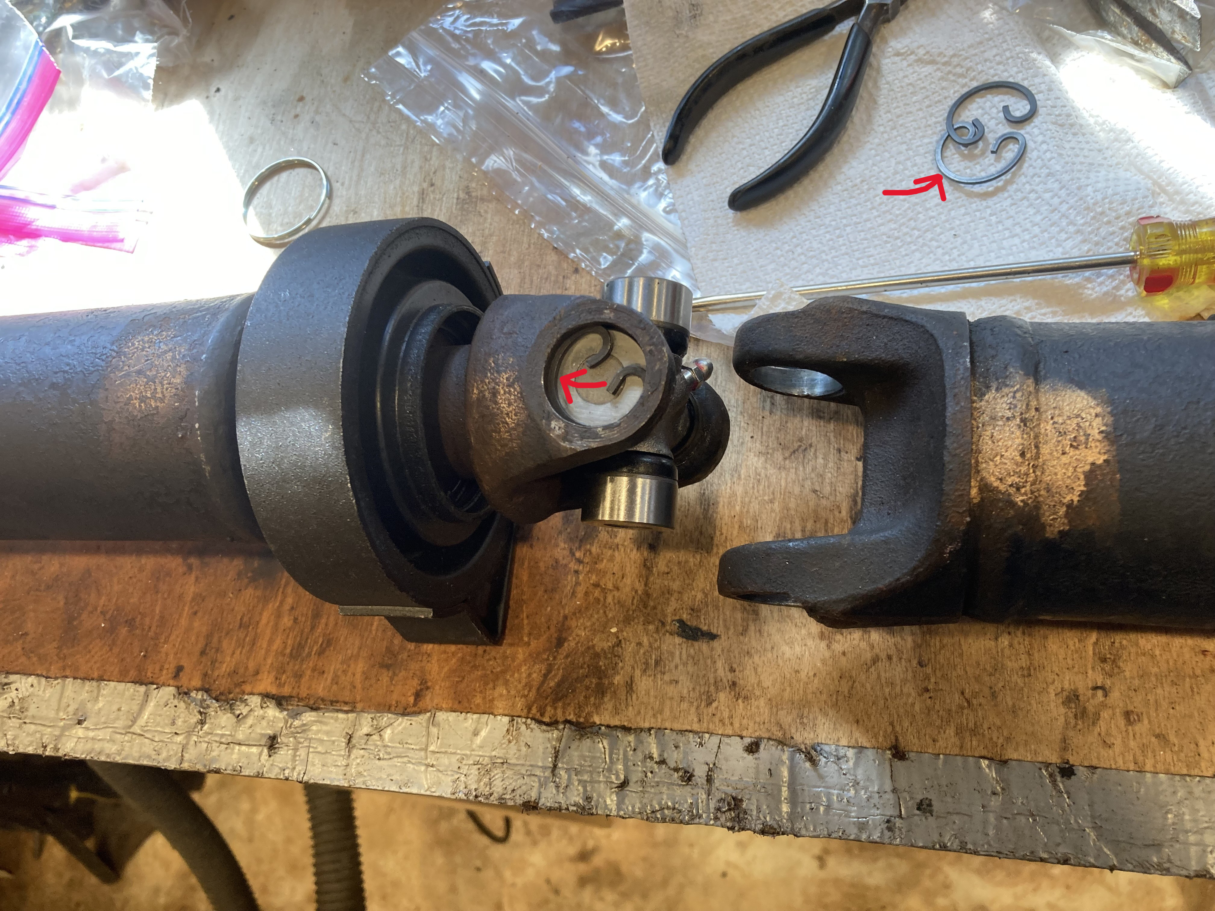

Some types of clip seem to be ground flat on both sides (avoids the potential problem I described) plus they seem to fit more securely in square grooves.
(I've seen some u/joints that even used selectable different thicknesses of clip to adjust clearances, but not on Fiat's, so you're o.k.).
I'm not sure about how well the clip is fitting into it's groove at this point (red arrow) compared with the width of the loose clips on the bench - it might just be the angle of the shot? No harm to double-check before you store the shaft and possibly forget about it?
*Sorry to hear about your back issues but well done for getting the driveshaft back together while suffering.
(am similarly afflicted myself, want to work but just can't at times).
Yes well spotted - i wasn’t quite done with seating the clips when I took that shot.
I could probably fully rebuild an engine to standard spec. or even slightly 'hotted-up' for a fraction of this cost, but there again I'm not paying me for my time.
Great info. I think it would be very difficult to shorten newer carb spindles, the one carb has a welded on washer/seal as there is no space for a nut! I did manage to remove this and reweld it (had to to fix a siezed bearing). The spindle bearings also have seals to prevent air being drawn in.
Finally the pair of spindles have to be precisely aligned to ensure the butterflys and fuel pumps operate simultaneously.
