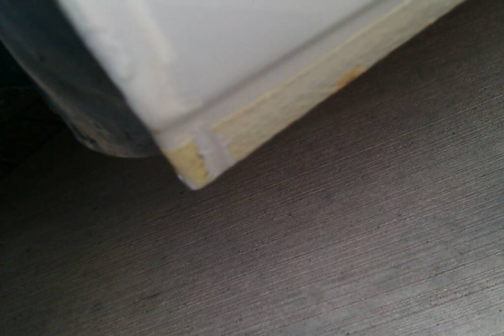

Just discovered this :banghead:

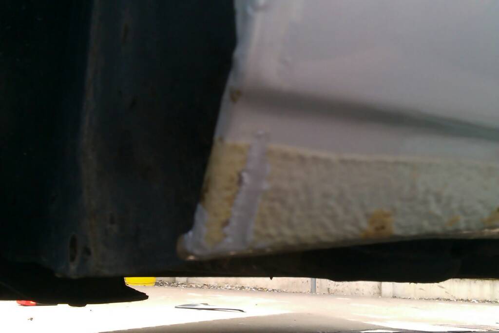

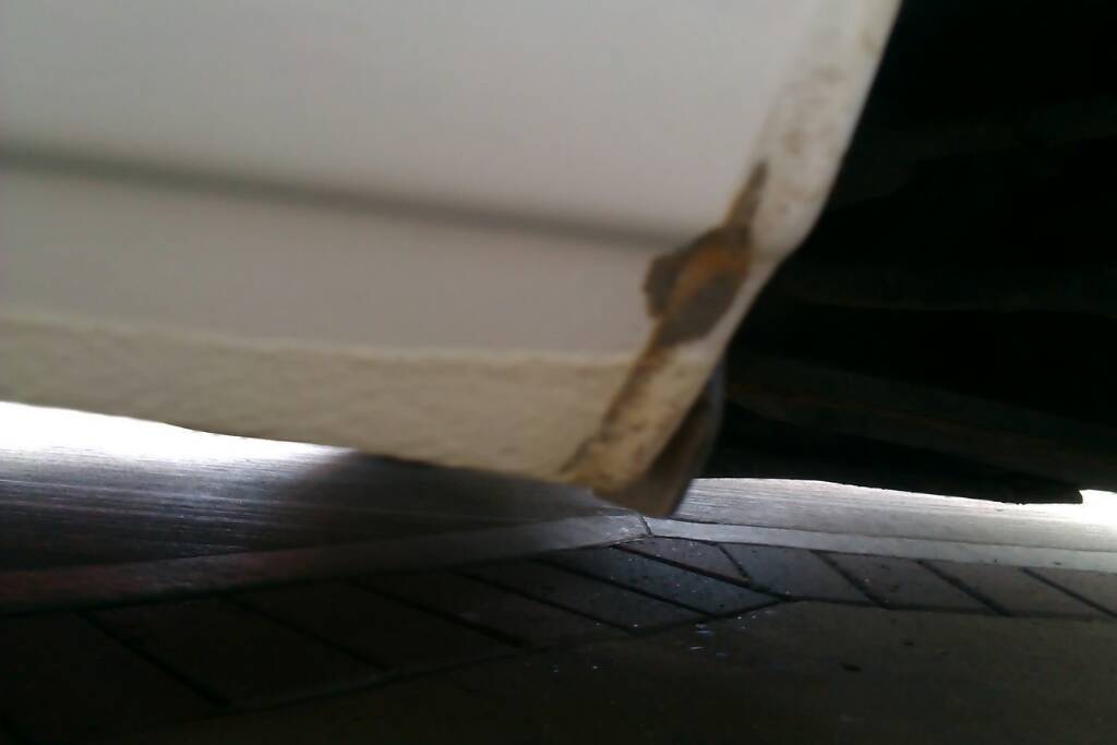

Well been busy since i saw it i cleaned any (very light) surface rust away using Bilt hamber DEOX Gel having first picked away any loose bits
Cleaned any residue off with body solvent wipe
i thhen used a bit of gray primer
Then some touch up paint just need to underseal the relevant bits once the paint is fully cured,
then refit them thinking of using some Tiger seal OR silicone to hold them in place and stop them flapping about
Ohhhh Andy, why show me this. After the carnage i had trying to get them on. I'm sure you remember as you were the one i kept pestering :rolleyes: Well i get my pressure washer right in the cracks whenever i clean her anyway, so fingers crossed i blast out all the shi*e that causes this....
