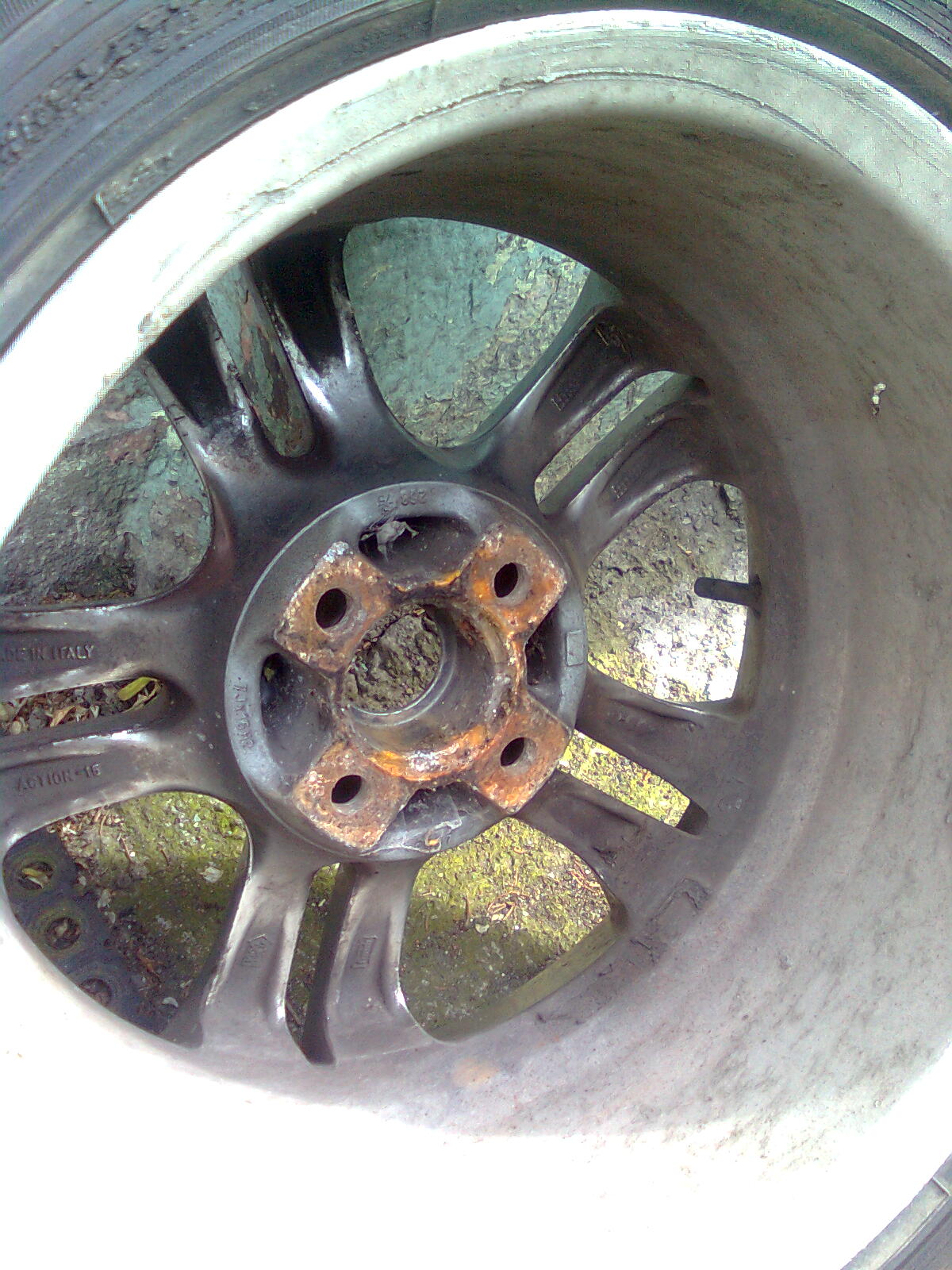

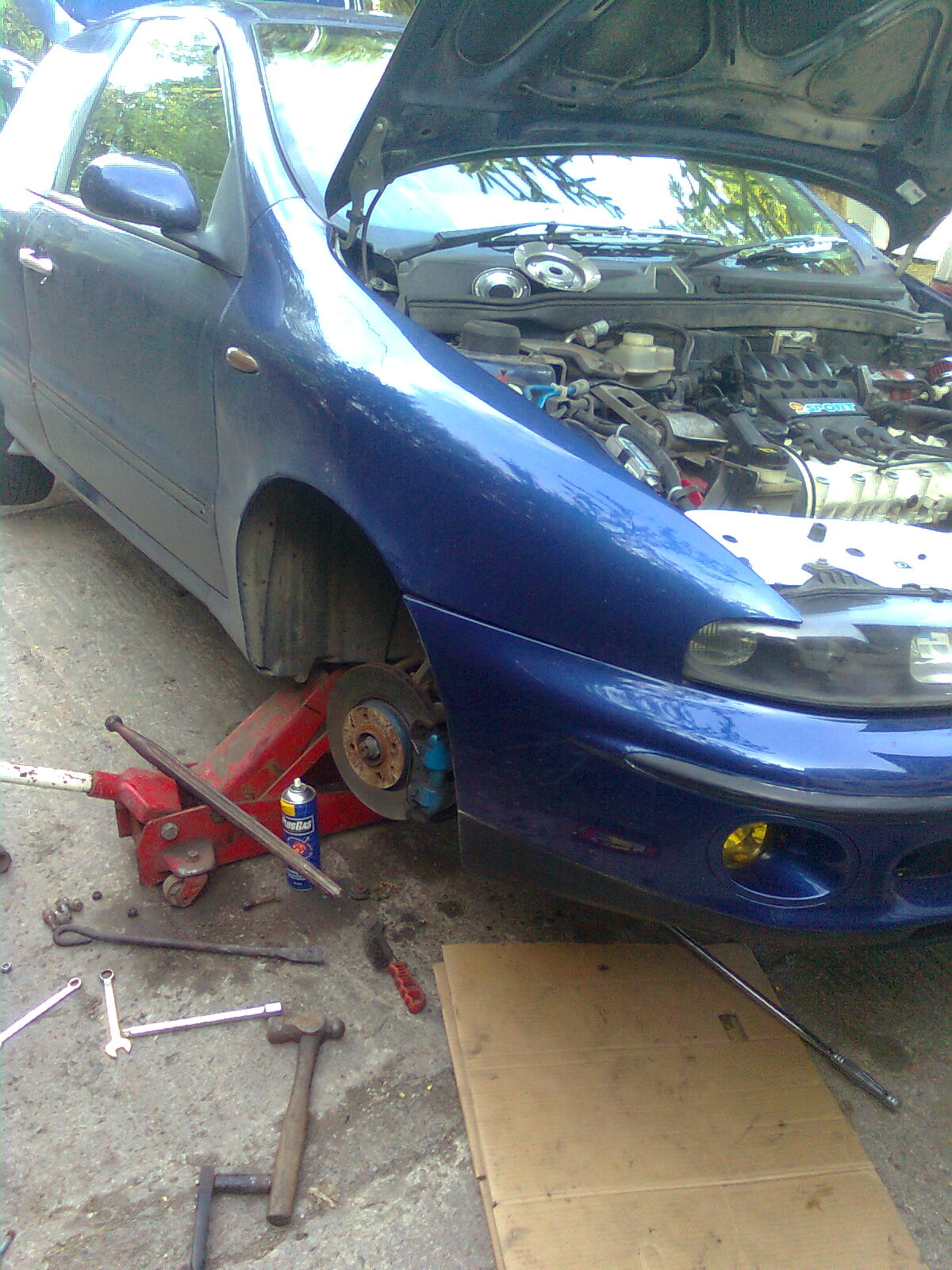

Twas havin a gander through the Sei forum and I found a post on spigot rings. More importantly on why you need them. Well remember my gearbox from the first page? Heres the reason it ended up like that...
Yep, no rings
for a miserable £7 it could have saved all that unnecessary catastrophe along with saving my trailing arms and arbs (rear arb and trailing arm need replacing)

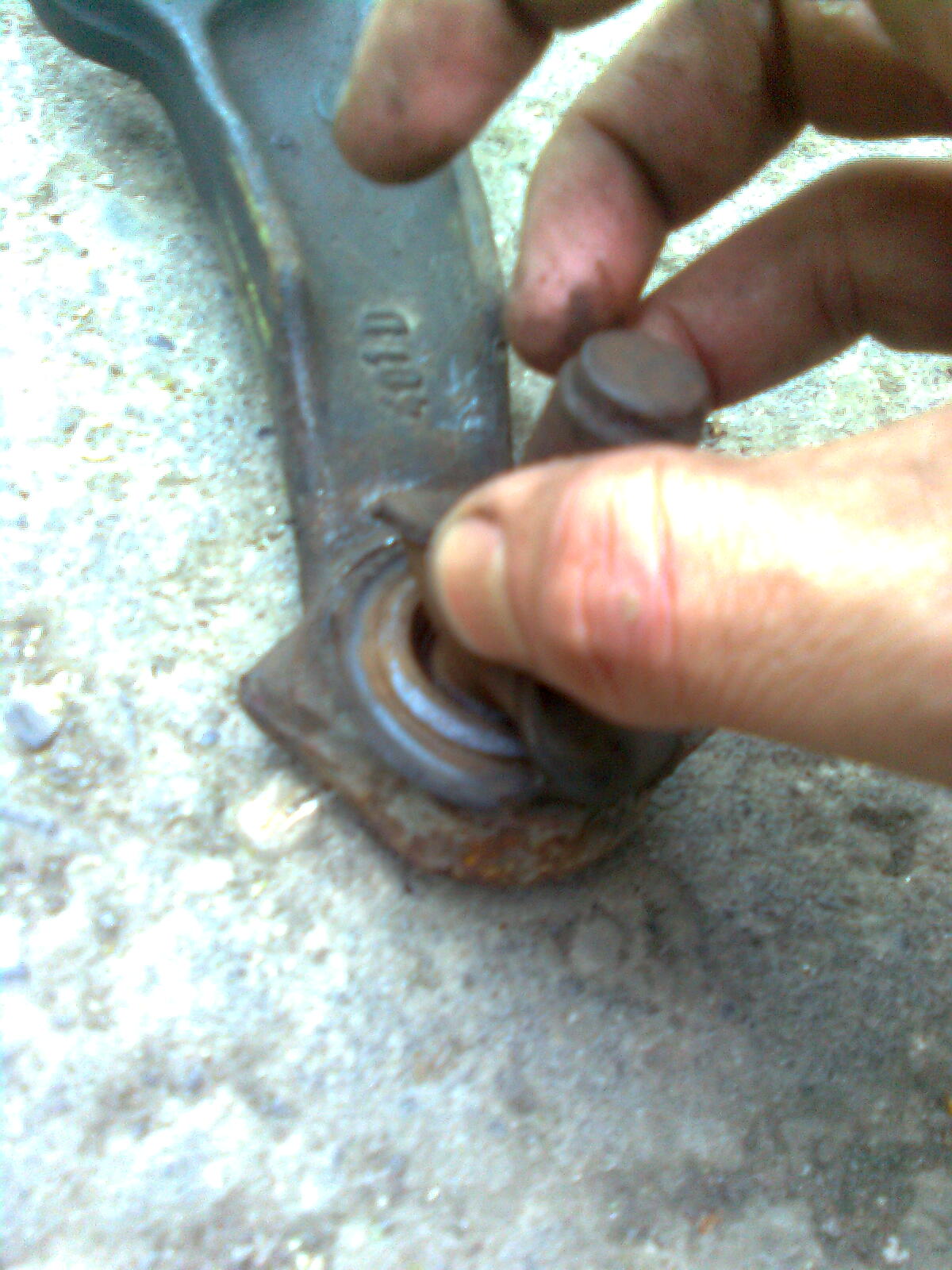

Wondering why I'm showing that wheel? I had to replace the set I pillaged off another car here
But I've done it right this time
And with a set of wobblies that solved that

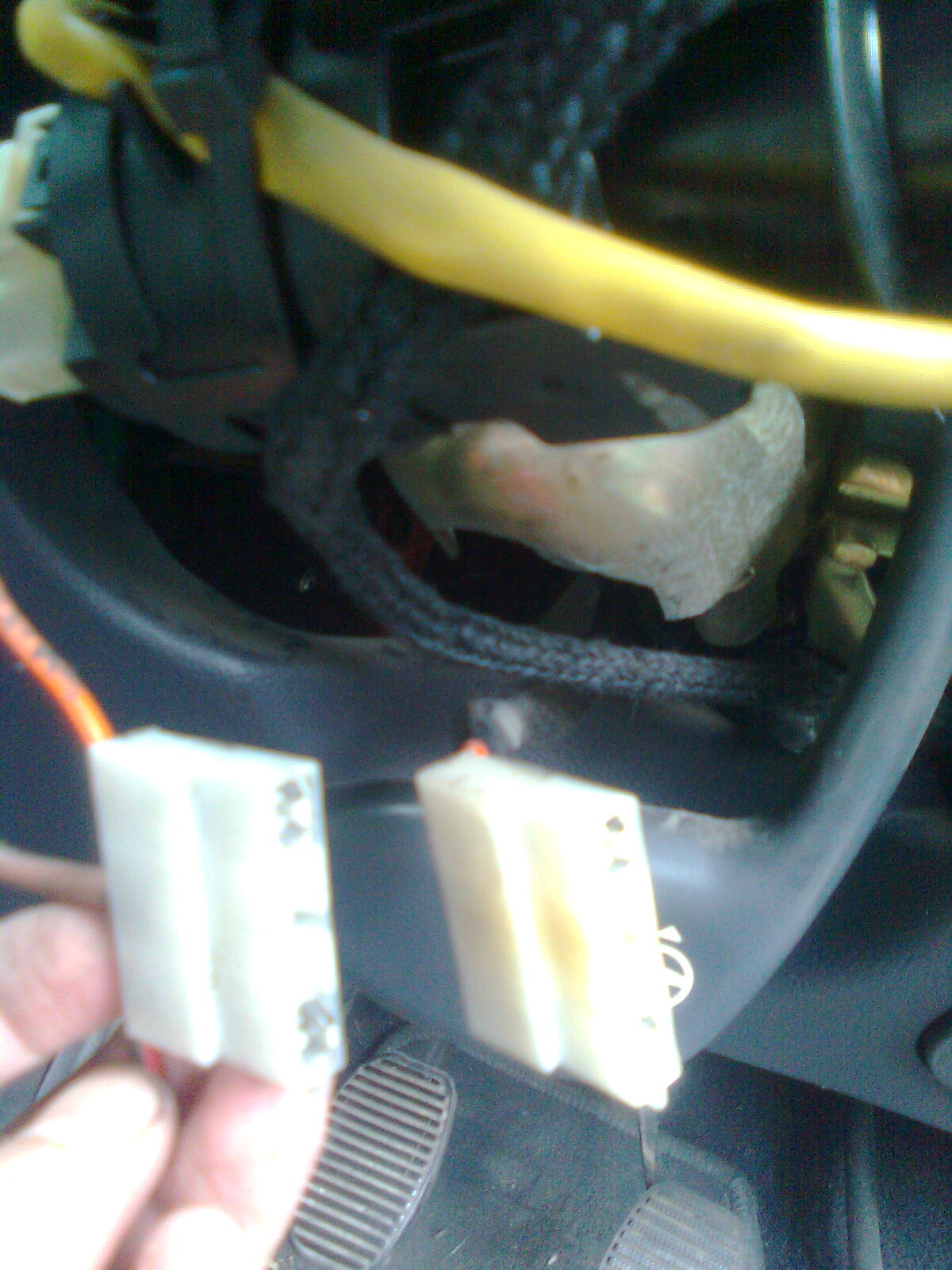

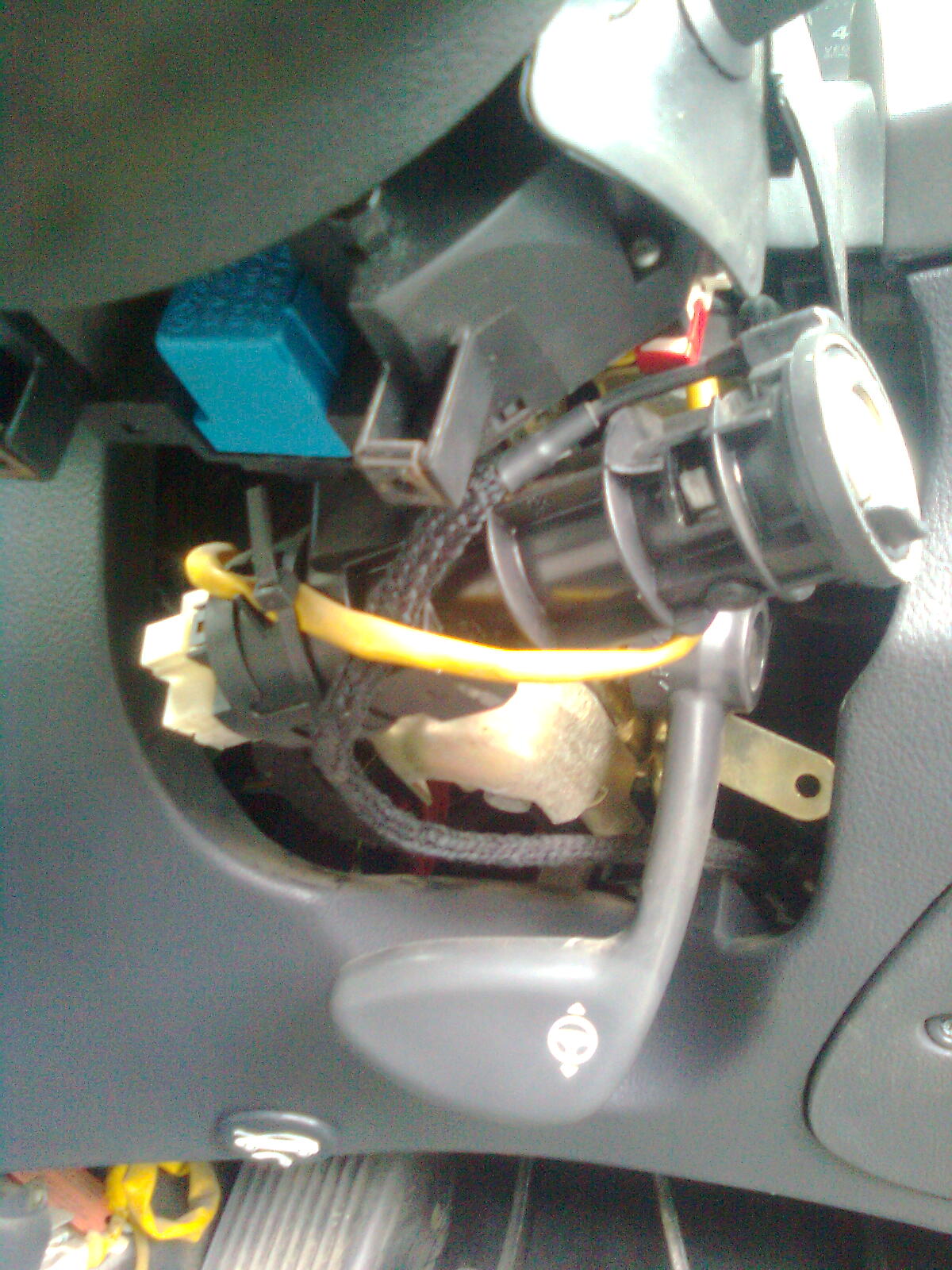

If you didn't know, when you fiddle with the stepper motor ie use washers, the car will have very poor idling at startup. Wit high lift cams its almost impossible to keep it running after startup. So I decided enough is enough
First is to whip the trim off...
I had to source another plug. Not an issue
You can guess what I'm doing by now

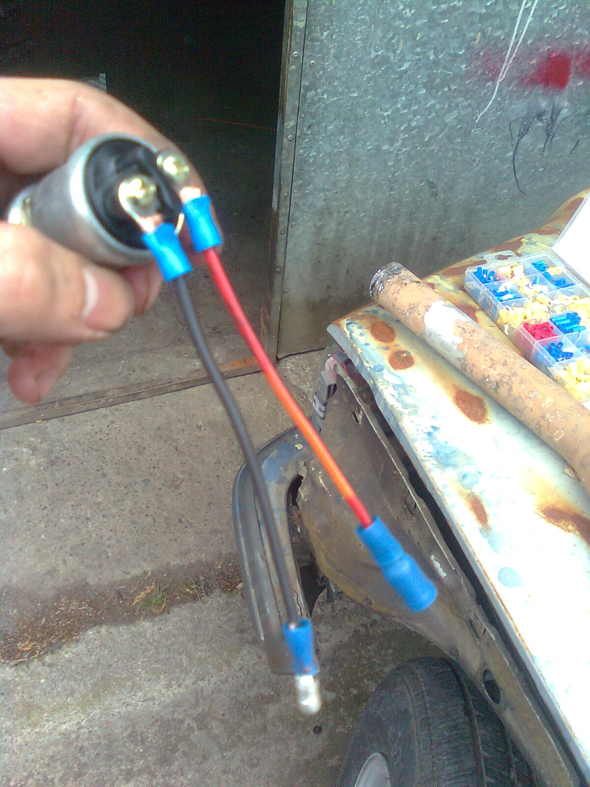

A certain wire is not required, so out it came
Now to expose the wires by moving the jacket...

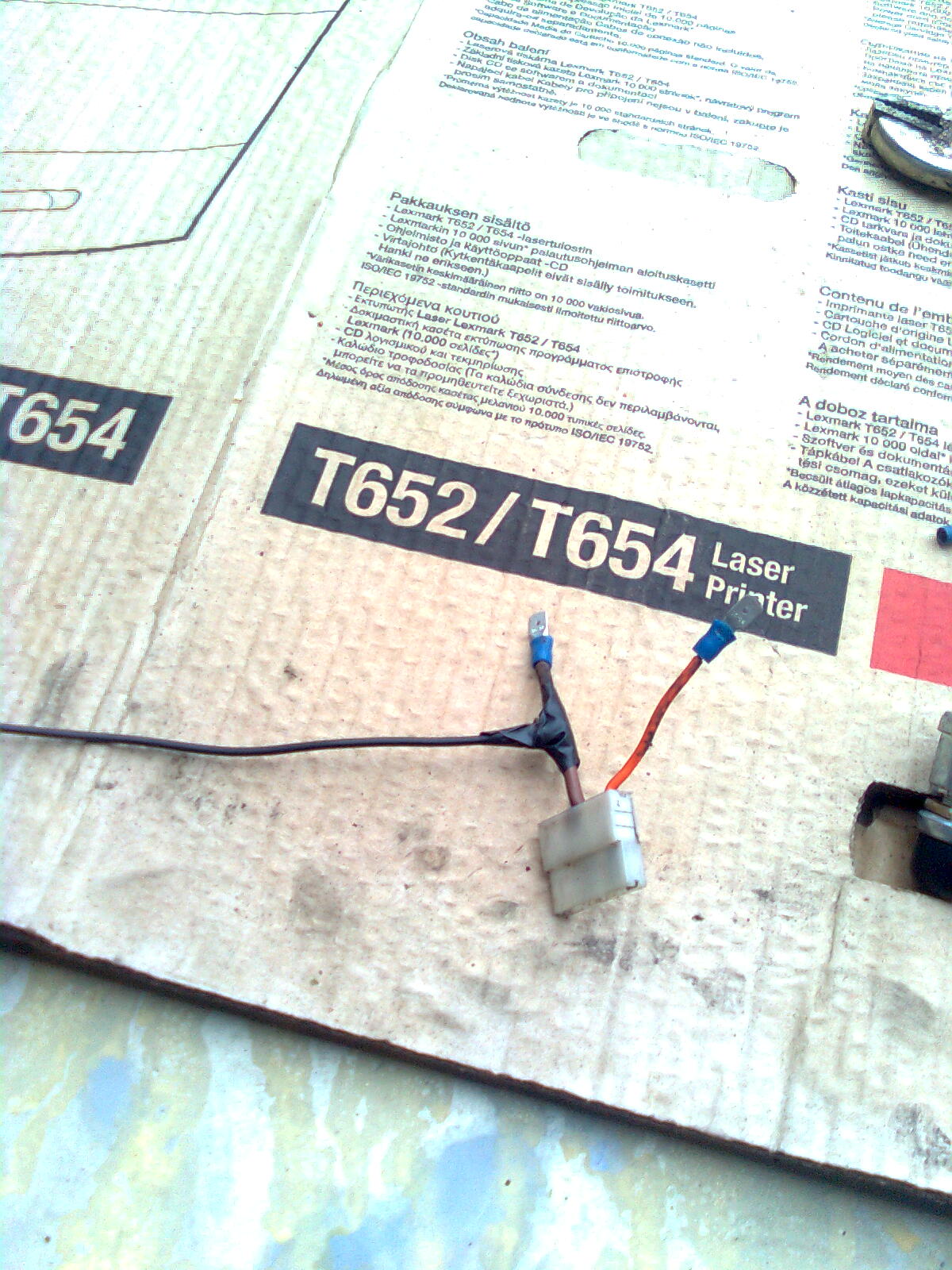

Now some connectors would be nice
And some extra wires. Make sure its the same thickness and has a proper contact with this wire
Seal it up!
Then cut it in half
Now what about the other halves?
Good to go
out with the drill
A big bit I may add... End result
