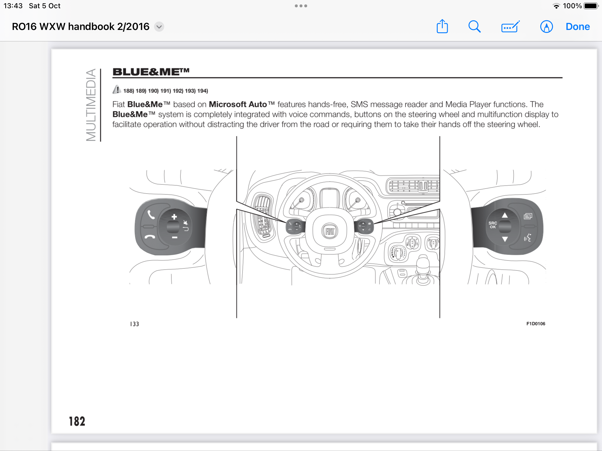

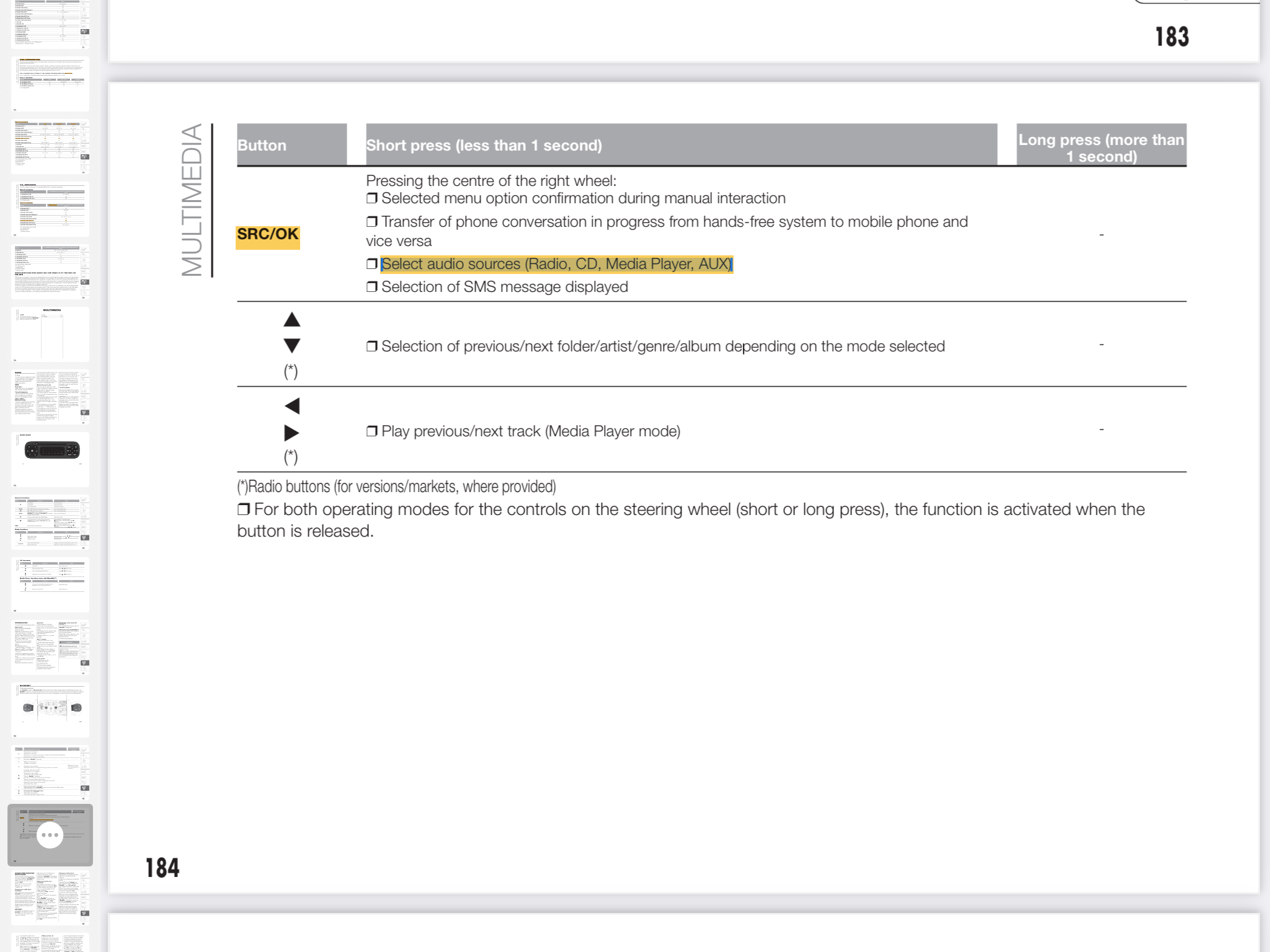

You must select “Media Player” for the USB not “AUX” (shown on the radio display screen)
You can select 4 audio sources (Radio, CD, Media Player, AUX) using the SRC/OK button on the steering wheel (RH side) by repeatedly pushing it, or you can press the “Media” button on the radio itself
Hope this works
If not then it’s Plan B or C…
