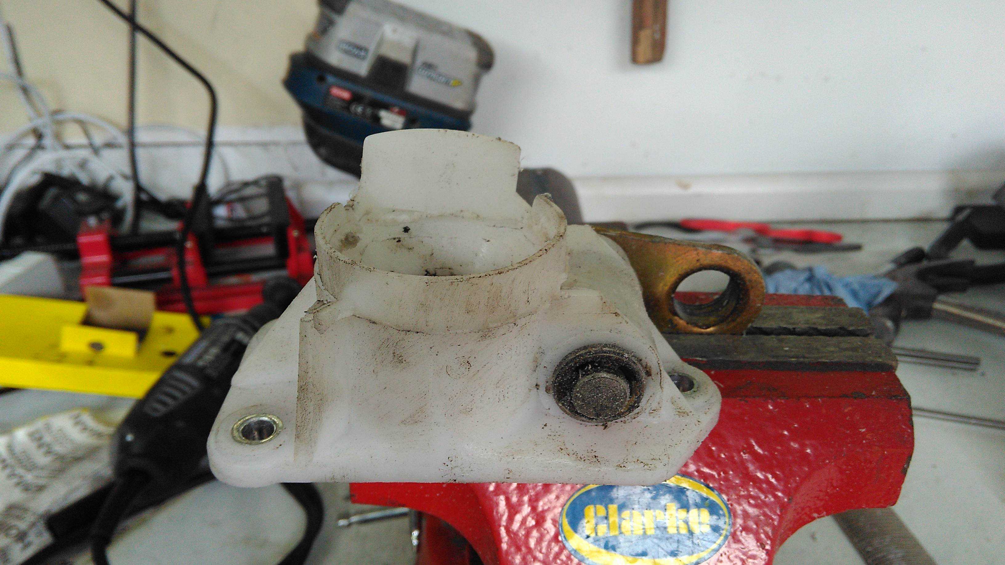

Preparing the plastic unit

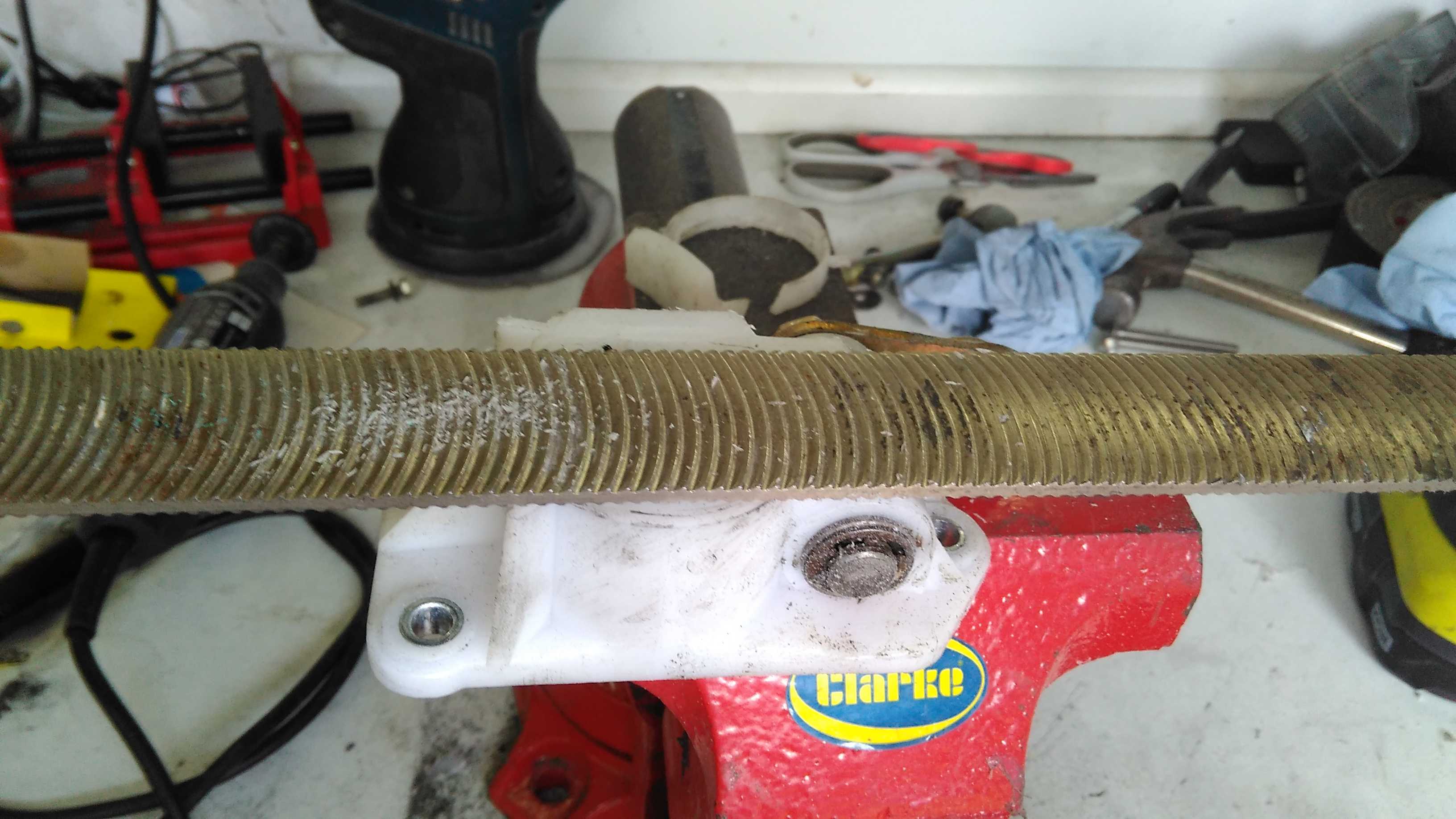

Now you need to cut the extended flange from the white plastic unit...

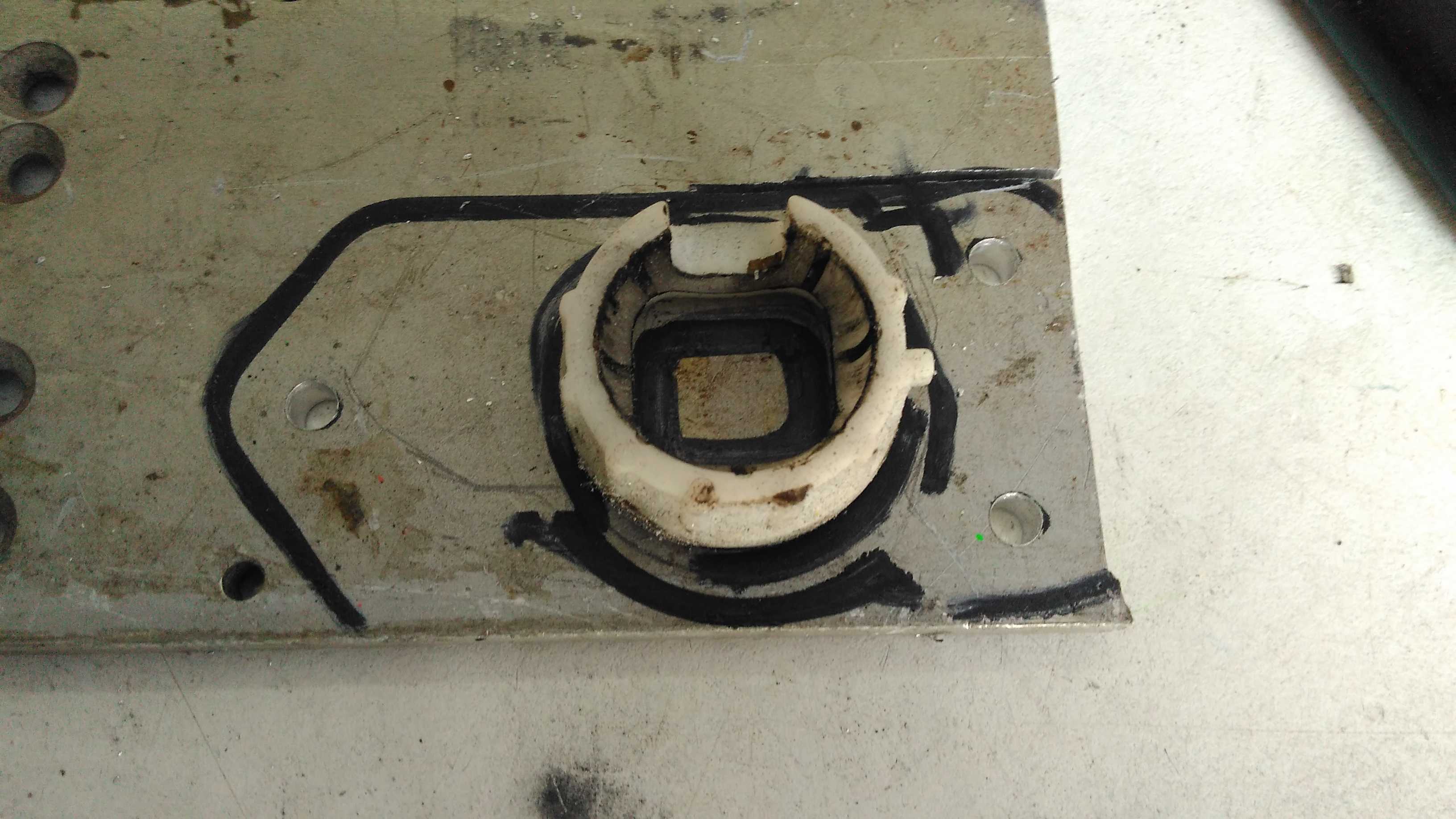

Now put the bracket on your plate and draw round it and mark the holes

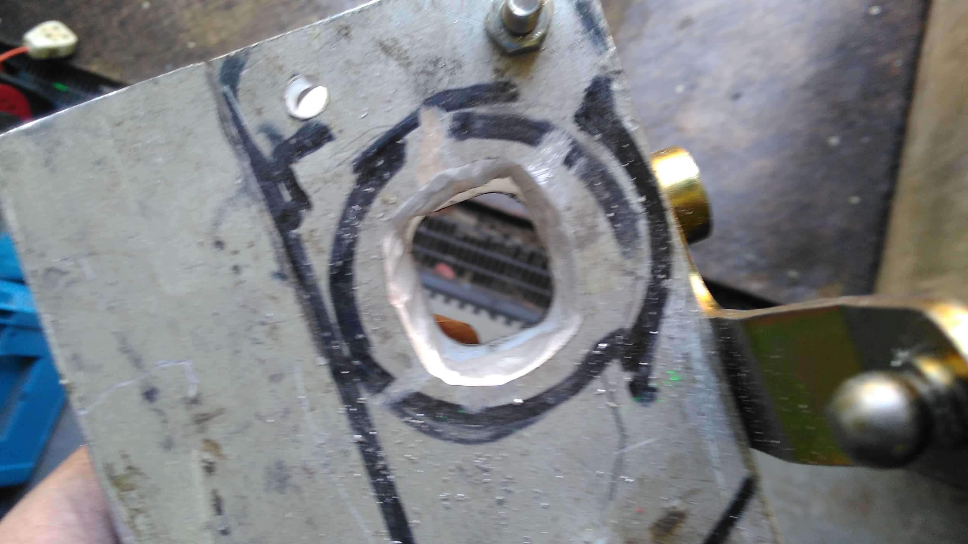

I then drilled out the holes and bolted the bracket upside down so I could get a good approximation of the centre on the main hole.
Then I used the small base unit to check it again
Then it was time to cut out the plate to shape

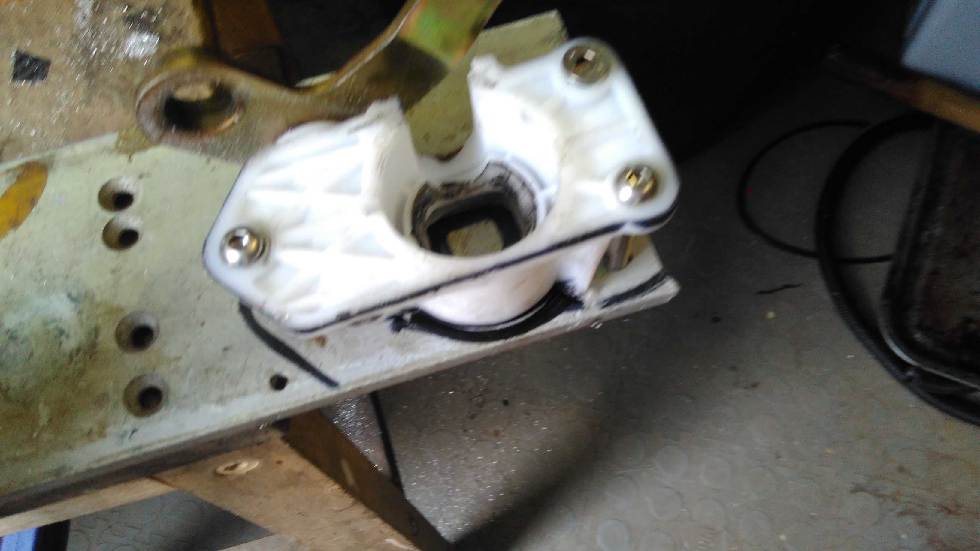

(notice I bolted the units together at this point so I could check that the gearstick did not foul on the plate)
Then fit it - JOB DONE !!!

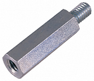

(depending on how your plastic linkage is mounted you may need to get some bolt extenders) such as these:-
