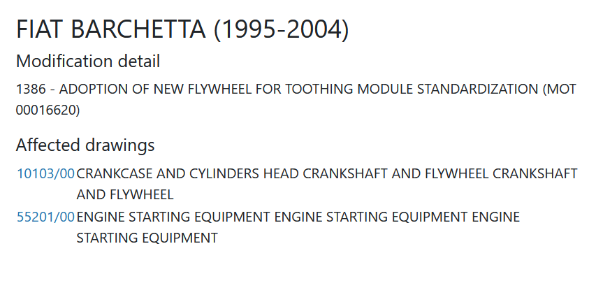

If we want to know what was changed with a particular modification we can click on the number, in this case 1386:
Now ePer shows us that the modification affected two sets of drawings. The two diagrams seem sensible as, presumably the starter motor had to change to work with the new flywheel, so let's drill down to the the starter motor page:

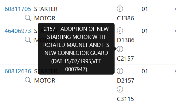

Here we can see that there have been a few different starter motors over the years. Our modification number is seen in the first two items, firstly with a 'C' prefix and then with a 'D'. The ‘C’ signifies the point at which a part ceased to be used and ‘D’ from when it started to be used. I think C comes from Italian cessaro meaning ceased and D from doppo meaning after. So the user of starter motor 60811705 ceased with modification 1386 and use of part 46406793 started with that modification. We then see that part 46406793 ceased being used with modification 2157. If we hover over the little 'i' in a circle (or tap it on mobile) we can see details of a modification on this page:
So the next new starter motor came in in July 1995 with a particular Ricambio number, 7947.

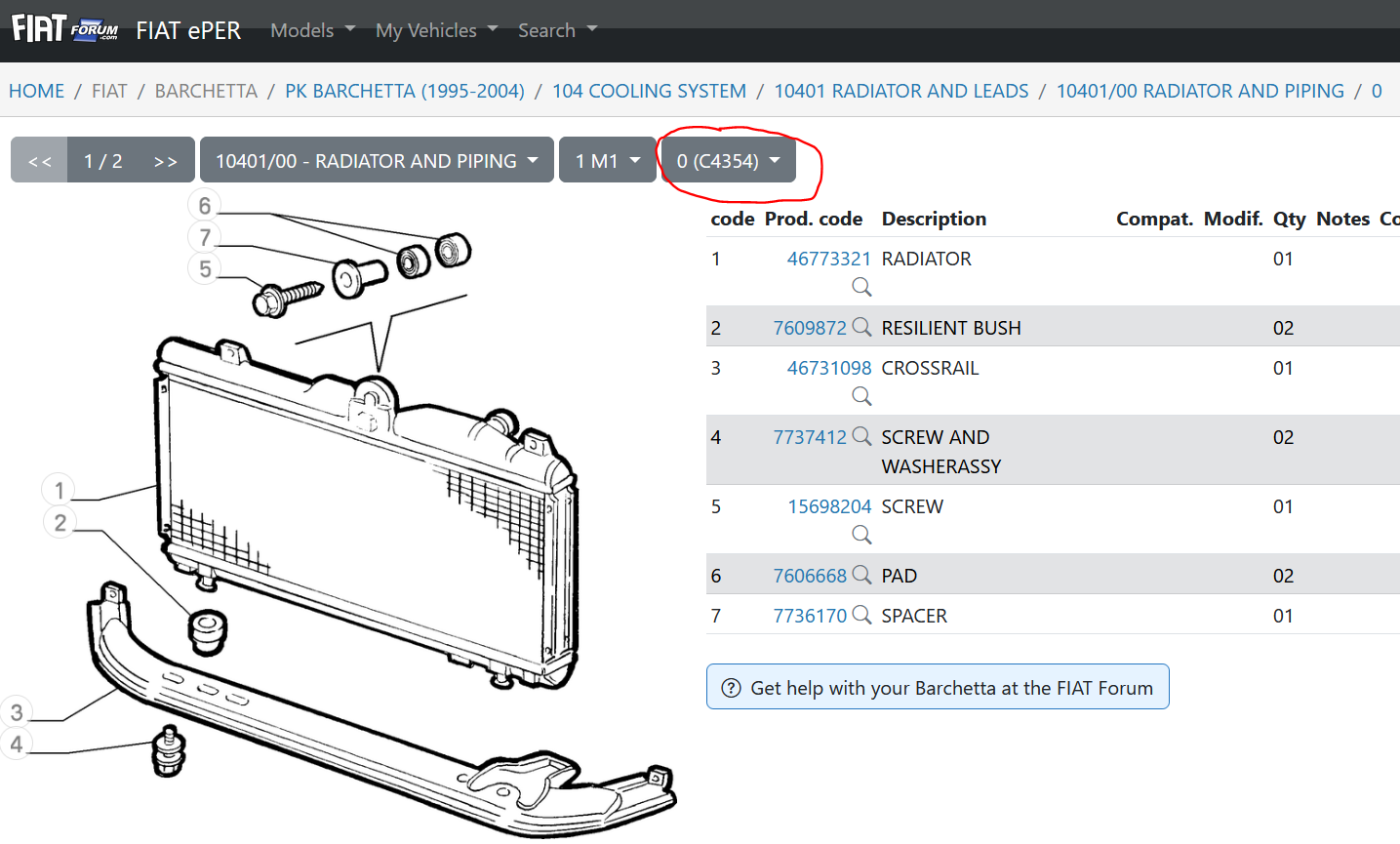

Where a modification makes a very large change to the vehicle it may not be possible to re-use a drawing or the number of parts affected is large. In this case a new sub-category is created You can see this on the Sub categories page such as this example where the new engine for the B meant new parts diagrams were needed:
In this case you won't see any mention of the modification number on the actual parts list but you will see it noted in the drop downs at the top of the page:
