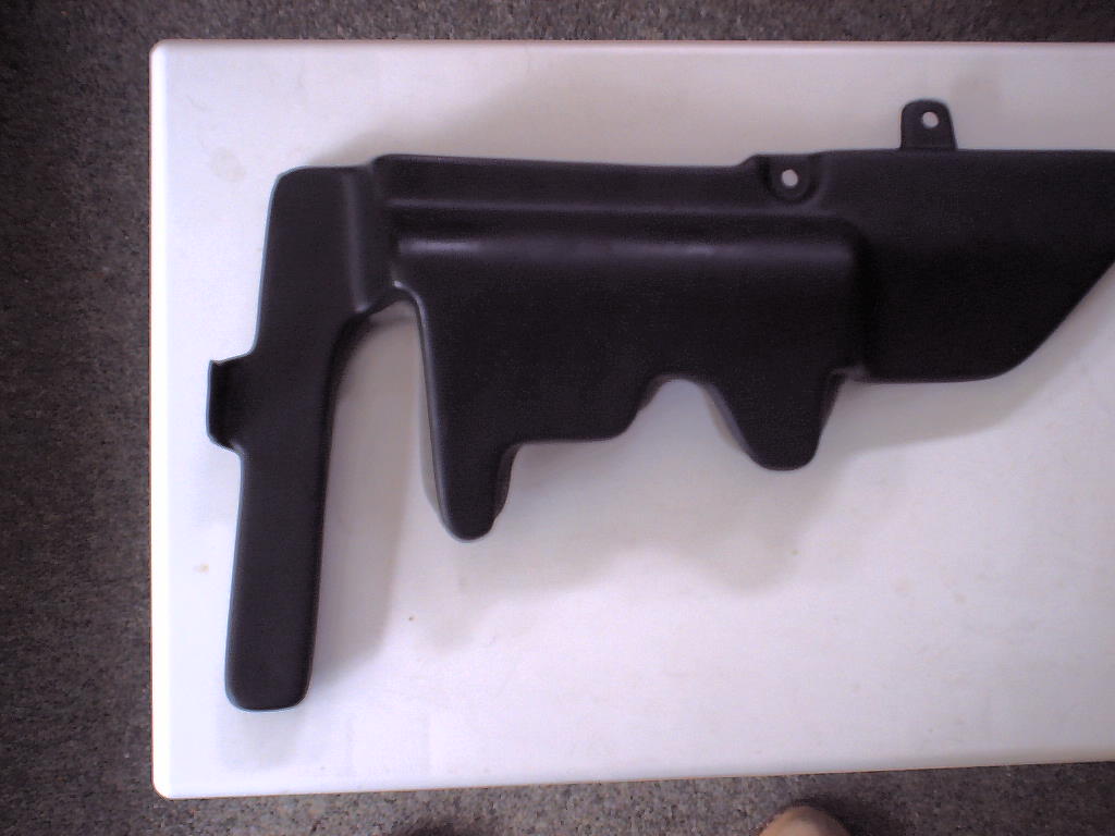

On the same idea of the pedal not getting fully up and getting a full shot of fluid then make sure there's nothing simple like the above the pedals sound deadening panel getting in the way and preventing the pedal getting fully up
Mine was really getting in the way so I took it out and threw it away.
Can you see where the pedal was scraping against the panel every time. That caused me a lot of moving clutch bite problems when I first bought the car due to this interference
It may be totally different for lh drive. Try putting your foot underneath the clutch pedal and making sure it gets fully up
