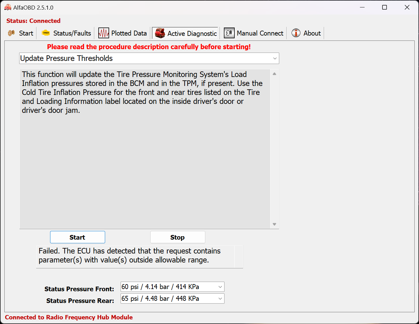

Using AlfaOBD on a 2022 Fiat Ducato Series 8 no matter what values I enter for the tyre pressures I still get told that they are outside of the allowable range. Is there any way of determining what the allowable range is or bypassing this message?

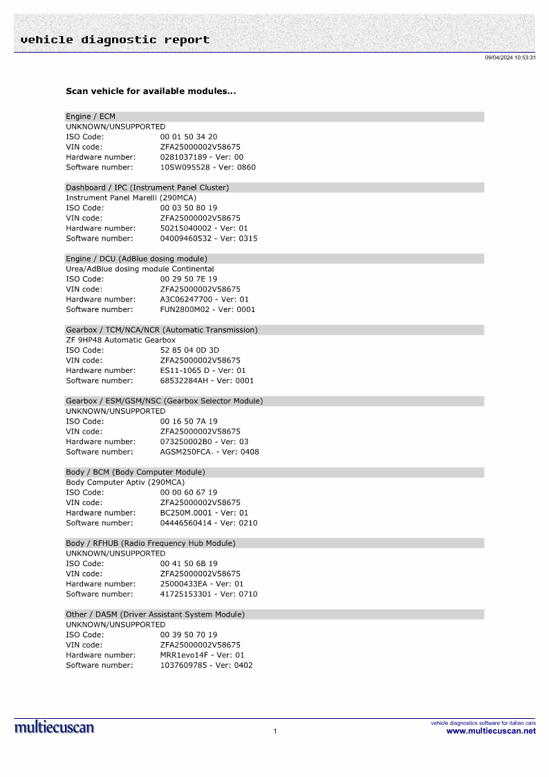

Otherwise no solution as yet, the general consensus of opinion seems to be that the settings are in the RFHUB (Radio Frequency Hub Module) but AlfaOBD won't let me adjust them and MultiEcuScan doesn't support this module.

The Fiat recommended tyre pressures for my 2022 Fiat Ducato are 4.5 bar front and 5.0 bar rear or 65.0 psi front and 72.3 psi rear on Continental VanContact 4Season tyres. I've worked out by trial and error that the TPMS warning set points are set at 80% of these values. So I've been using cold tyre pressures of 55 psi front and 62 psi rear which improves the ride and doesn't give any TPMS warnings.

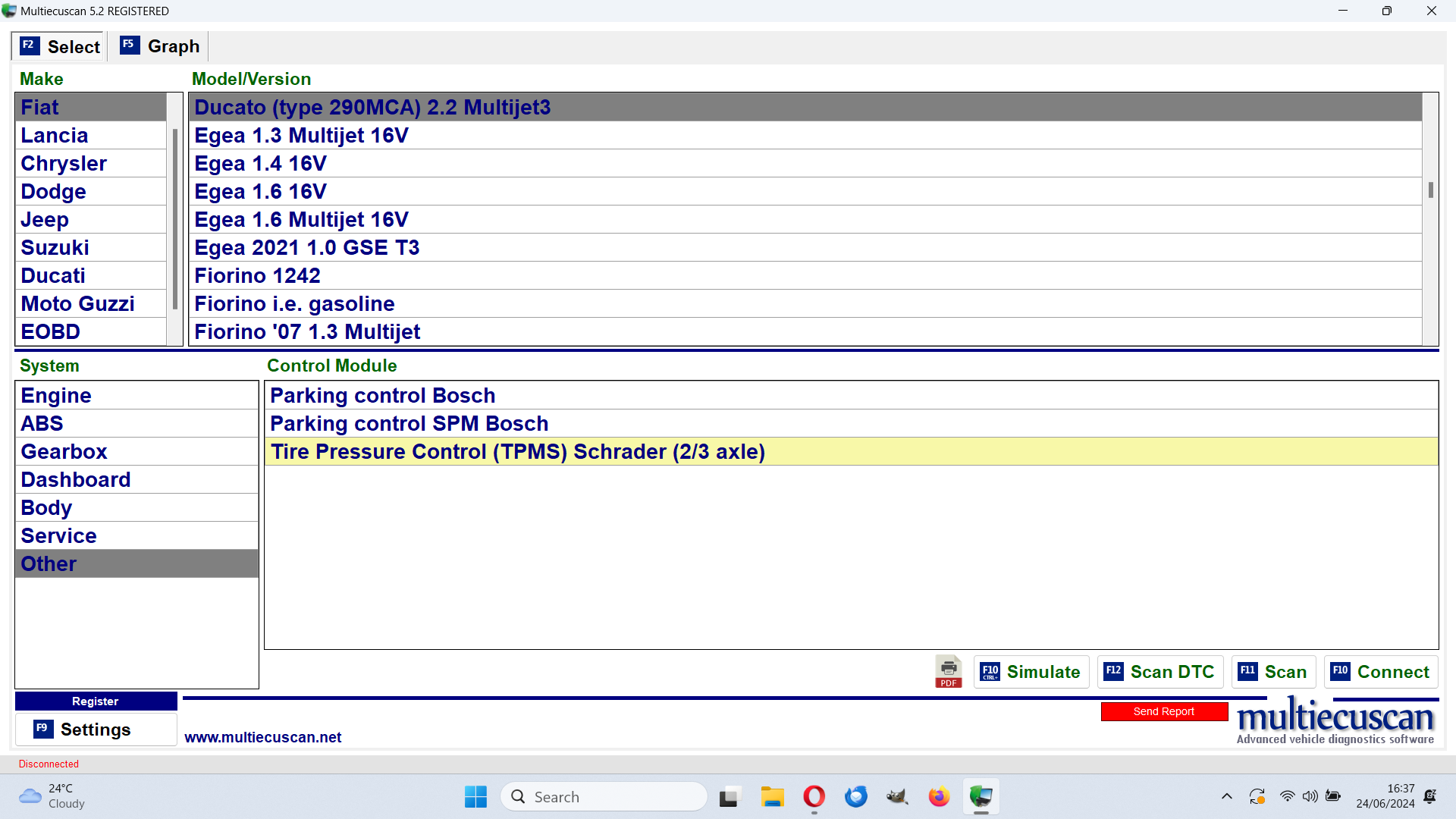

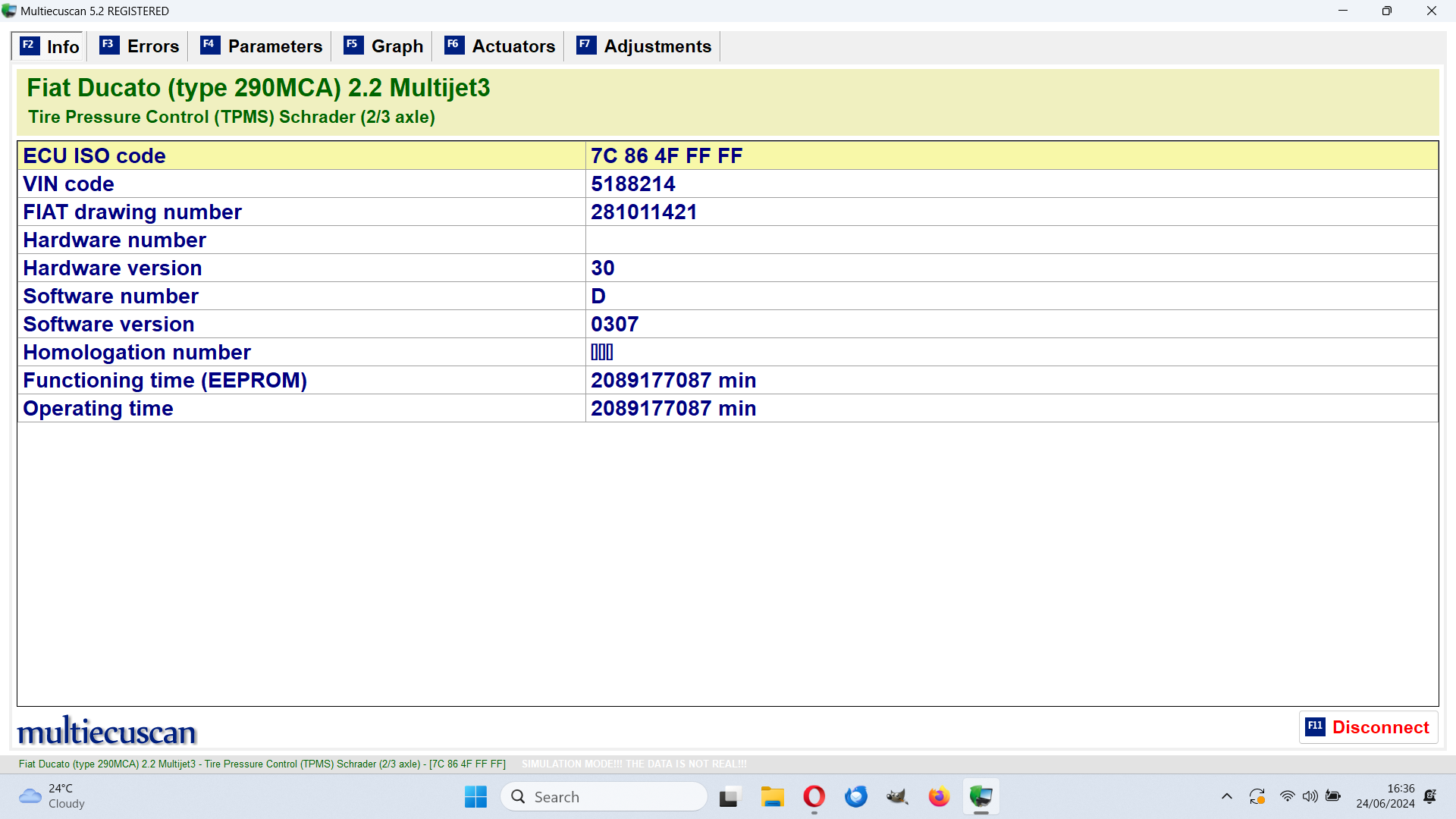

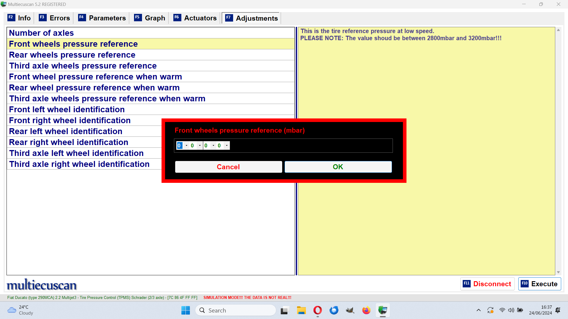

Using the simulate mode in Mes i was able to acess the TPMS in both X290 multijet2 and multijet3.
Yes, but everything changed for the Ducato Series 8 (2022+) and the TPMS isn't available separately as you've shown. It's now supposed to be in the RFHUB which isn't supported as in the MultiEcuScan report below.
Well then i'm one of the lucky ones with a 2017 twin egr model no SGW no TPMS (other than Tyrepal) no blocked LPEGR cooler yet and a Multiecuscan that works. Unfortunately with no actual newer model on my drive i have to resort to the simulate mode.
