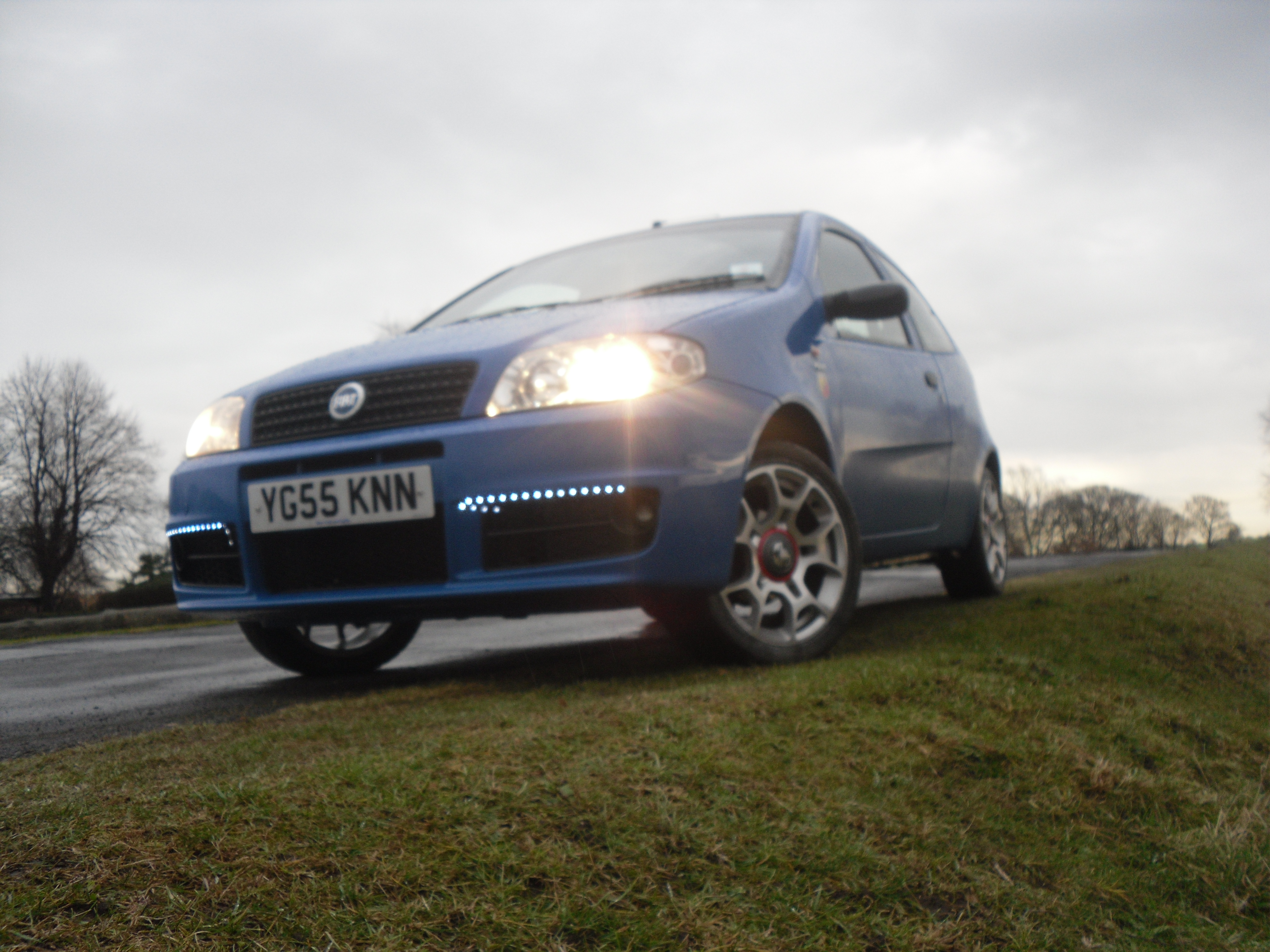

here is mine with 195/45 r16s
here is russ' with same size
so unless u buy lowering springs they will sit like this

If you MATCH the rolling radius to YOUR CURRENT alloys the gap will be IDENTICAL.
I presonally recommend 16" alloys with 195/45 16 tyres

Both mine and Colin's have identical rolling radius to the standard Fiat wheels and identical suspension set up. (y)

No, will sit identically to how yours is at the moment (y)
It will only look differnt if you put too larger or smaller tyre on. :D
Both me and Colin have different Specification's of Punto's i believe. Yet we have identical ride heights.
