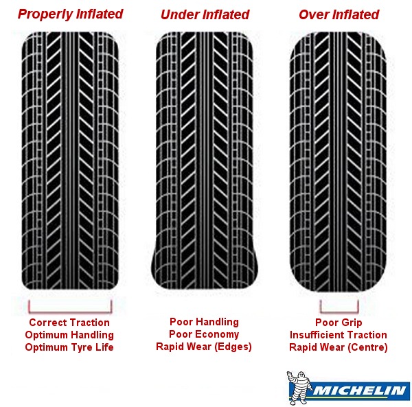

Implications of tyre pressures here:
Note, Under-Inflated tyres are More likely to suffer a 'Blow out' because every time the side wall comes around to the bottom it flexes and over time this flexing will heat up the sidewall making the tyre more pliable and this increase in tyre material temp will also increase the pressure of the air within the tyre until Pop!
