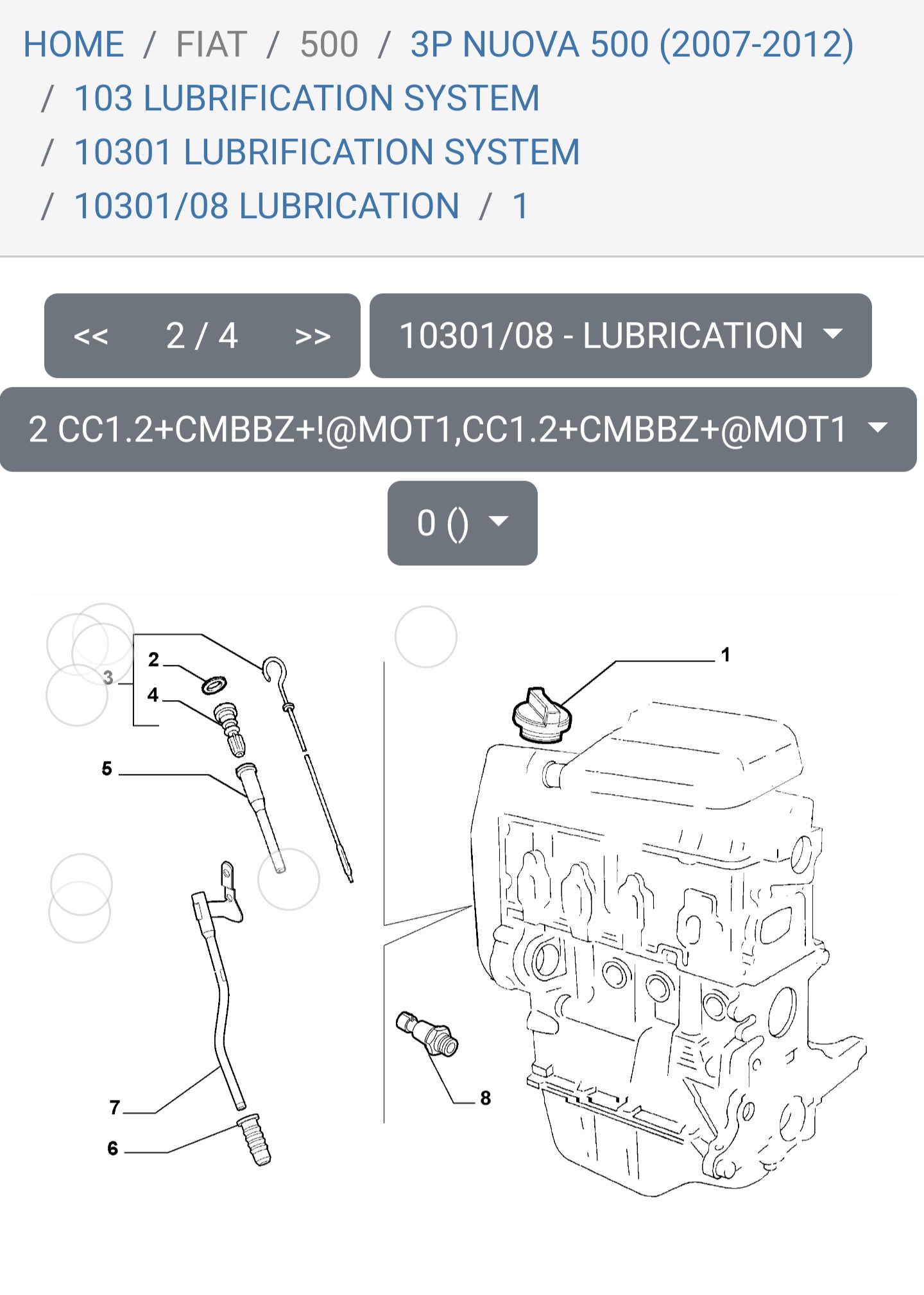

Look near the oilfilter.
Or check E-per. Check youtube, but don't ignore it or try to solve it with different oil or whatever.
gr J
Thank you very much E-per did have the info
It is number 8 in the attached photo
I won't ignore it
So far my plan is
1) sensor
2) oil cooler if exist 🙄 ( as this happens only when oil is above 96° Celsius, at 95 no problems at all )
3) pump intake
4) oil pump
5) thicker oil ( if it is really something with the engine )
