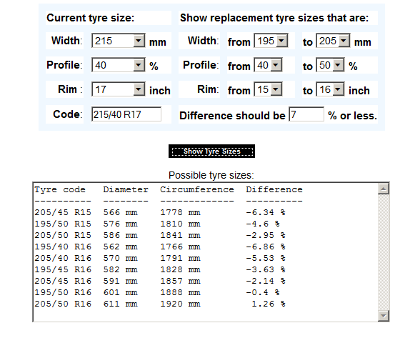

I have been using this site to check out different wheel sizes for a 'cheap' winter tyre option. The 'more complex section' is pretty nifty. As you know having better grip with wider tyres does not translate into better handling.
