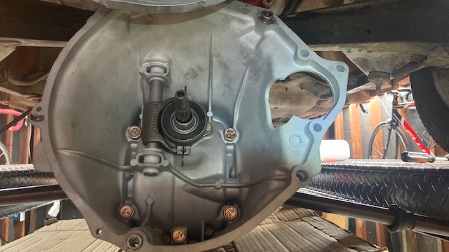

New transmission is in and the noise and thumps are gone. @ Goldnrust, I think I may indeed also have a tired or worn rear wheel bearing, but everything is holding up nicely now - maybe a job to investigate this winter. It zips right along!
FYI - to anyone who might buy a replacement transmission for the Giardiniera from MrFiat, they appear to be bellhousings from a 126 (bis?). That's fine, but the starter motor bracket shape is effectively flipped upside down. This means my beautifully machined adapter plate no longer matches properly... but the rest of the bolt holes line up. Pics attached. Maybe someday I will swap the bellhousings but for now it's time to drive the car and enjoy.
