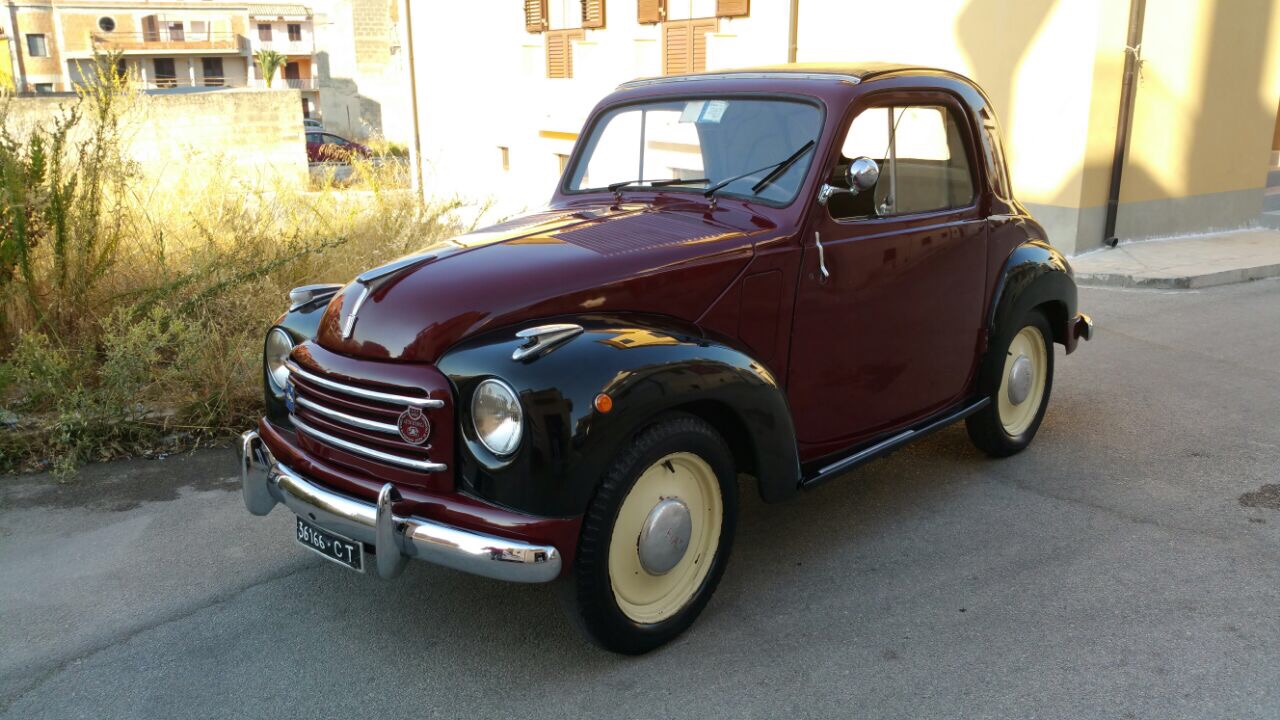

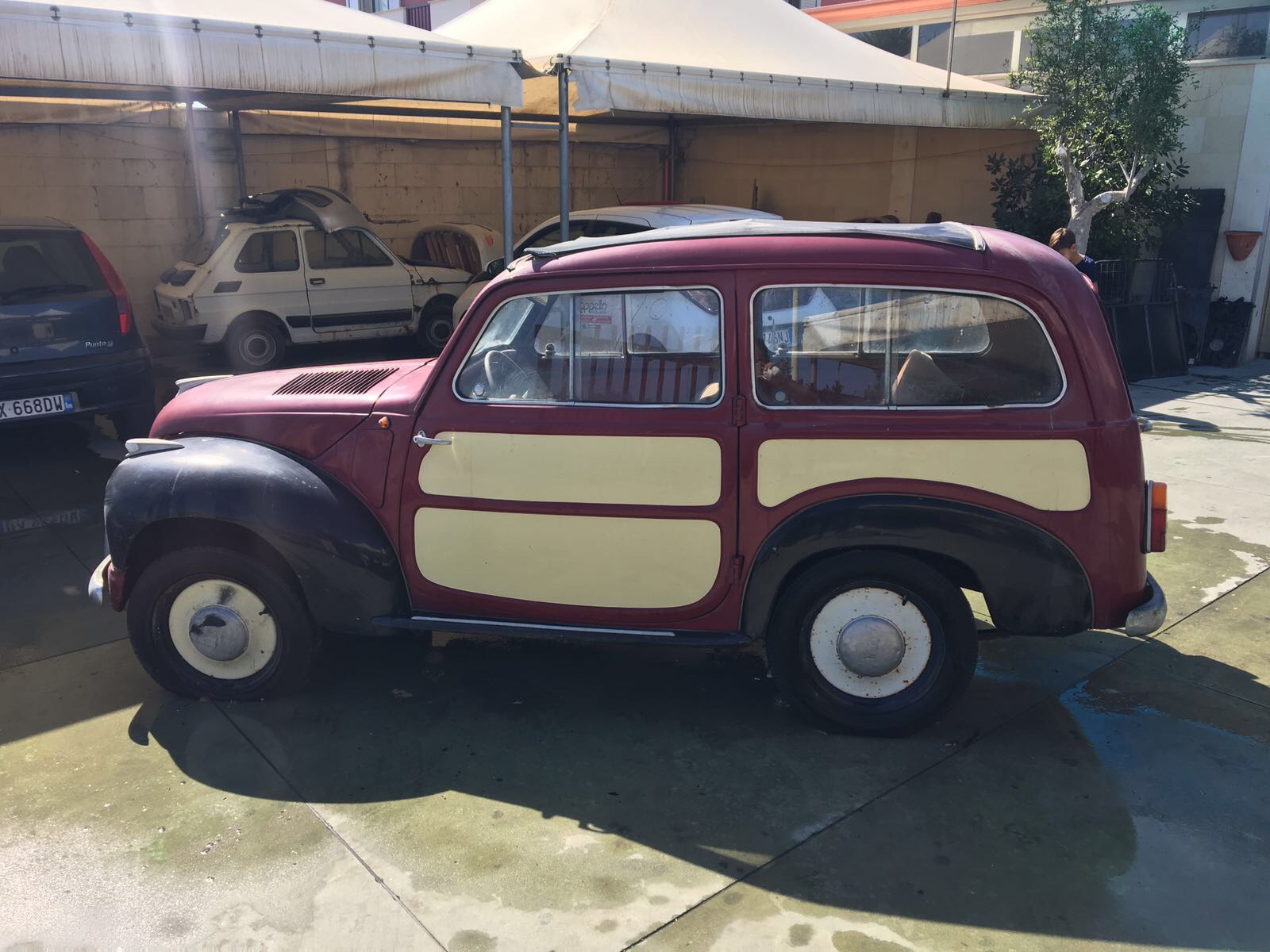

I own 2 Fiat Topolinos down in Sunny Malta. One is a Giardiniera Belvedere which is being restored and a Convertibile which is fully restored.
One one of them I have good oil pressure which tends to lower when reving up.
Does anybody have this problem or know why this happens, or what can be done.
