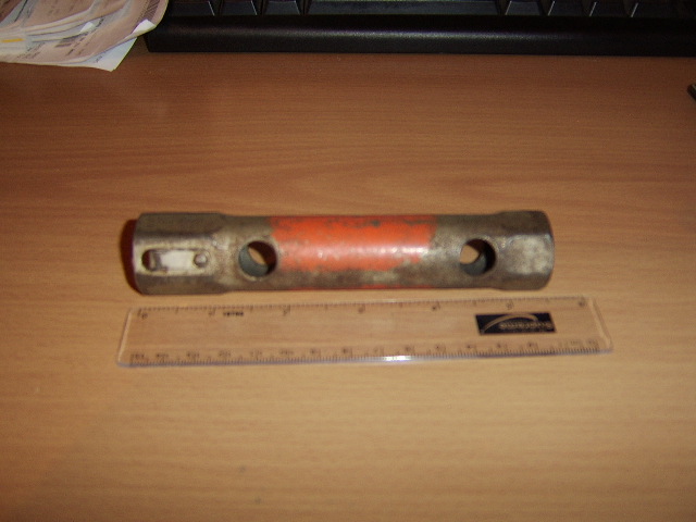

Peter, have you seen (below) this type of spark plug wrench, it was for VW Beetles, (made by Dowidat, No. 47 VW, the VW jack handle could be used as a T-bar) back in the day :) As you can hopefully see, it had 2 spring clips to grip the spark plug body just below the hexagon, the other end fitted the wheel bolts (nuts?).
Al.
