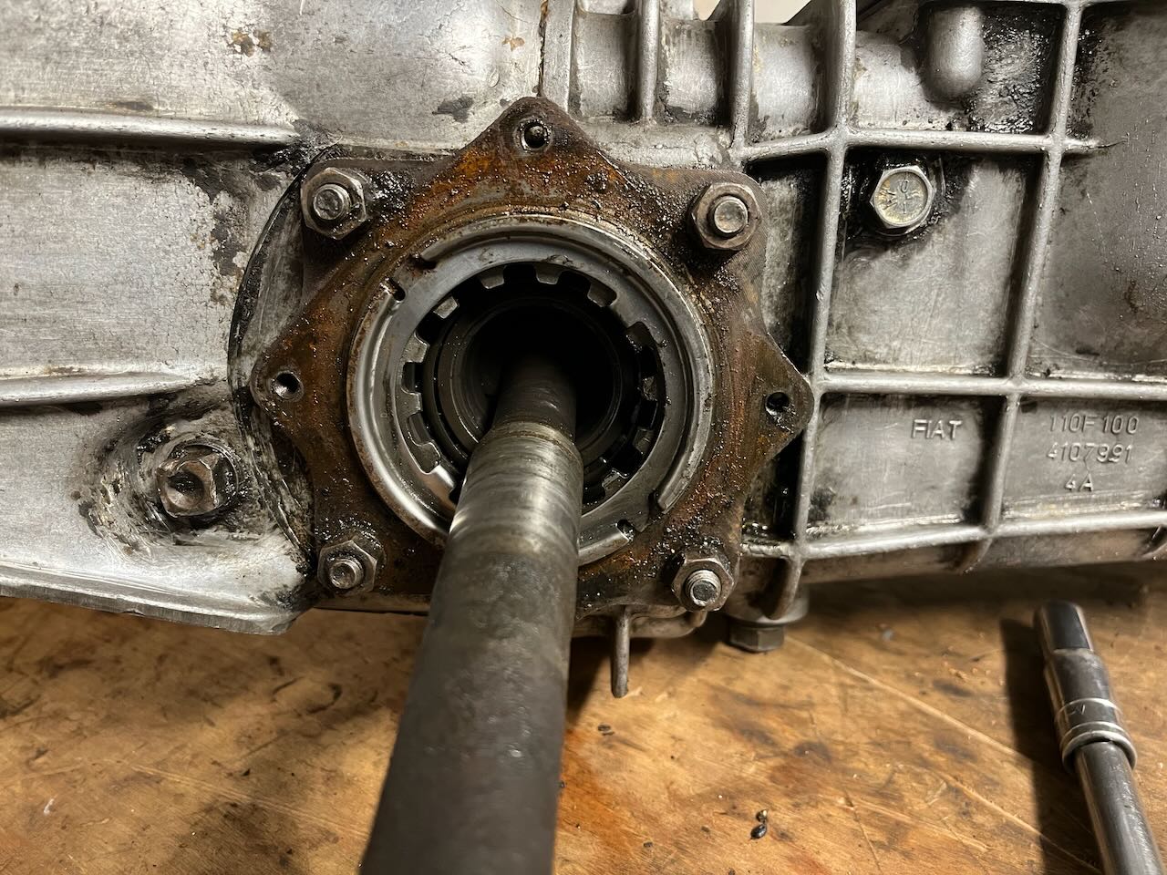

The only real 'setting' in the 500 gearbox is the preload on the differential bearings, which also is used to adjust the mesh between the pinion and differential crown wheel. The bearing races are held in position by a thick metal ring which thread into the bearing housing and turning these rings is what makes the adjustment.
When you remove the rubber boots from the axles, you will find a thin metal lock washer, with tabs that locate in the teeth of the adjustment ring. Remove this, and then mark (paint pen / nail varnish) the position of the adjustment ring to the bearing housing. As long as you don't try to move the adjustment ring there's no reason it should come out of adjustment. When you remove the 4 bolts that hold the bearing housing to the gearbox case, then you can carefully slide/pry the bearing housing out from the case, and then remove the bolts holding the bell housing on and separate the front half of the gearbox.

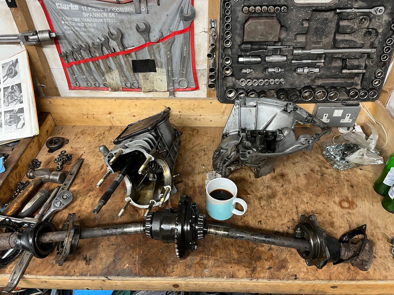

Have you got a Haines manual or similar, that can guide you through the process of how to remove the gear set?
Hopefully these couple of pictures makes it more clear how the bearing housings come out.

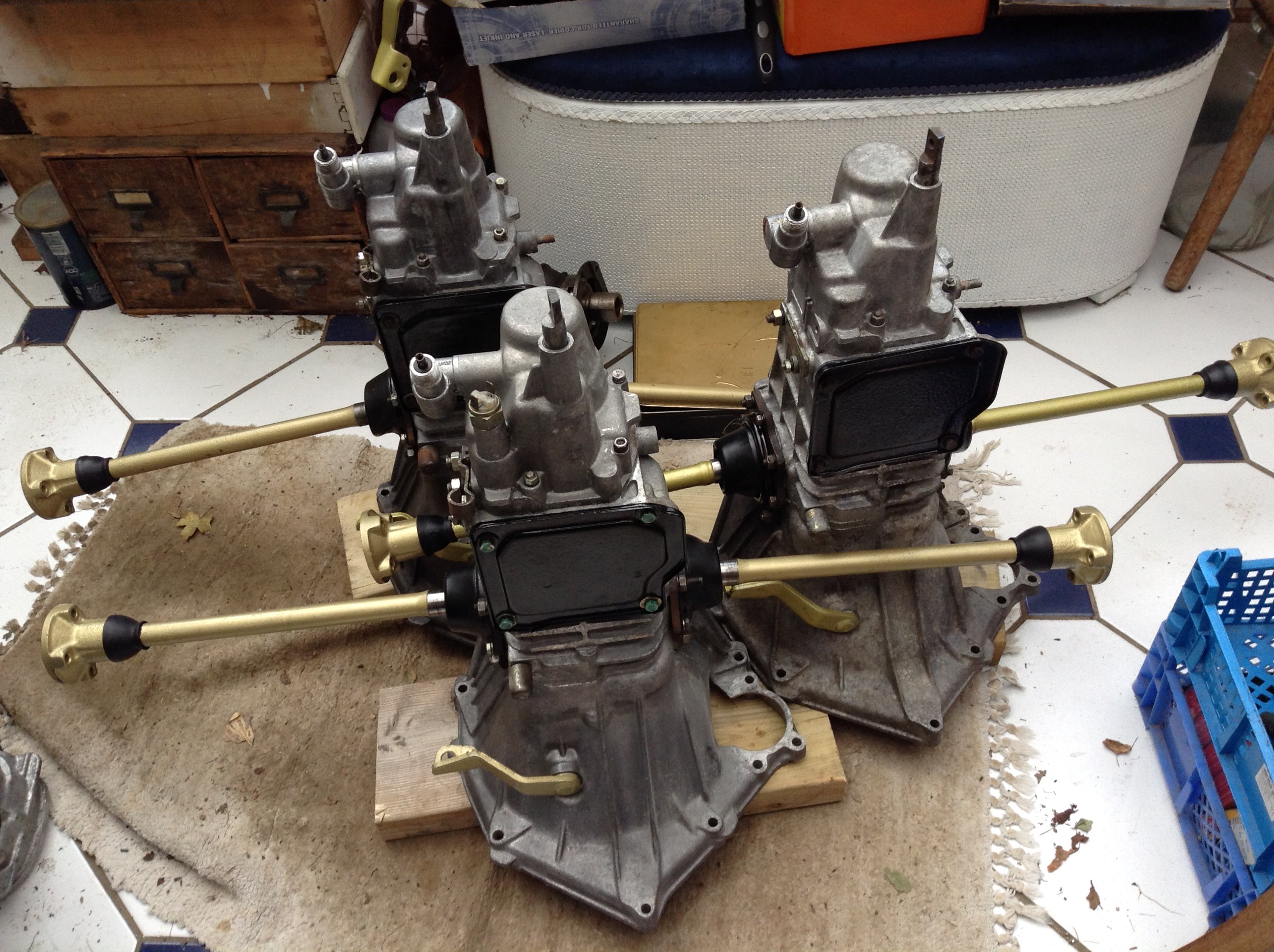

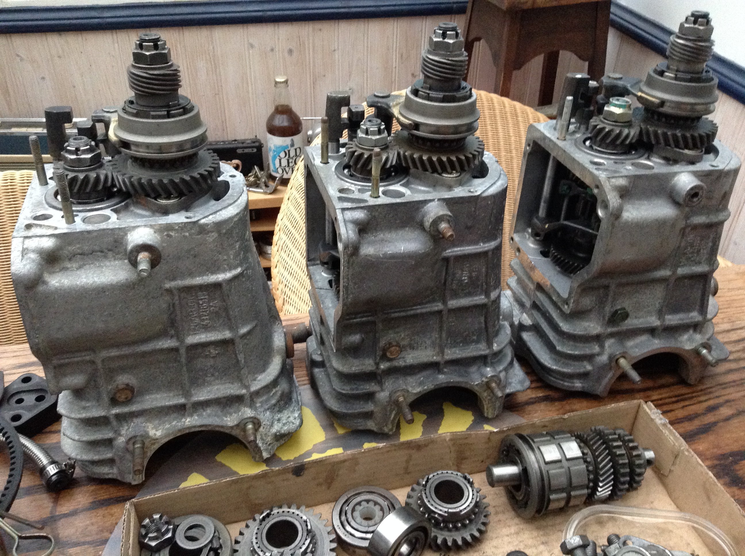

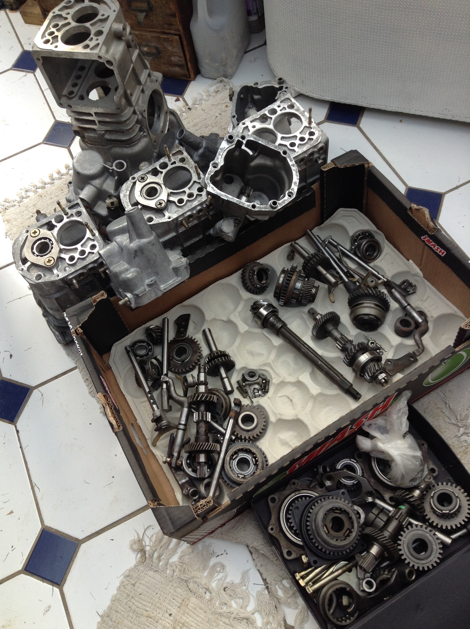

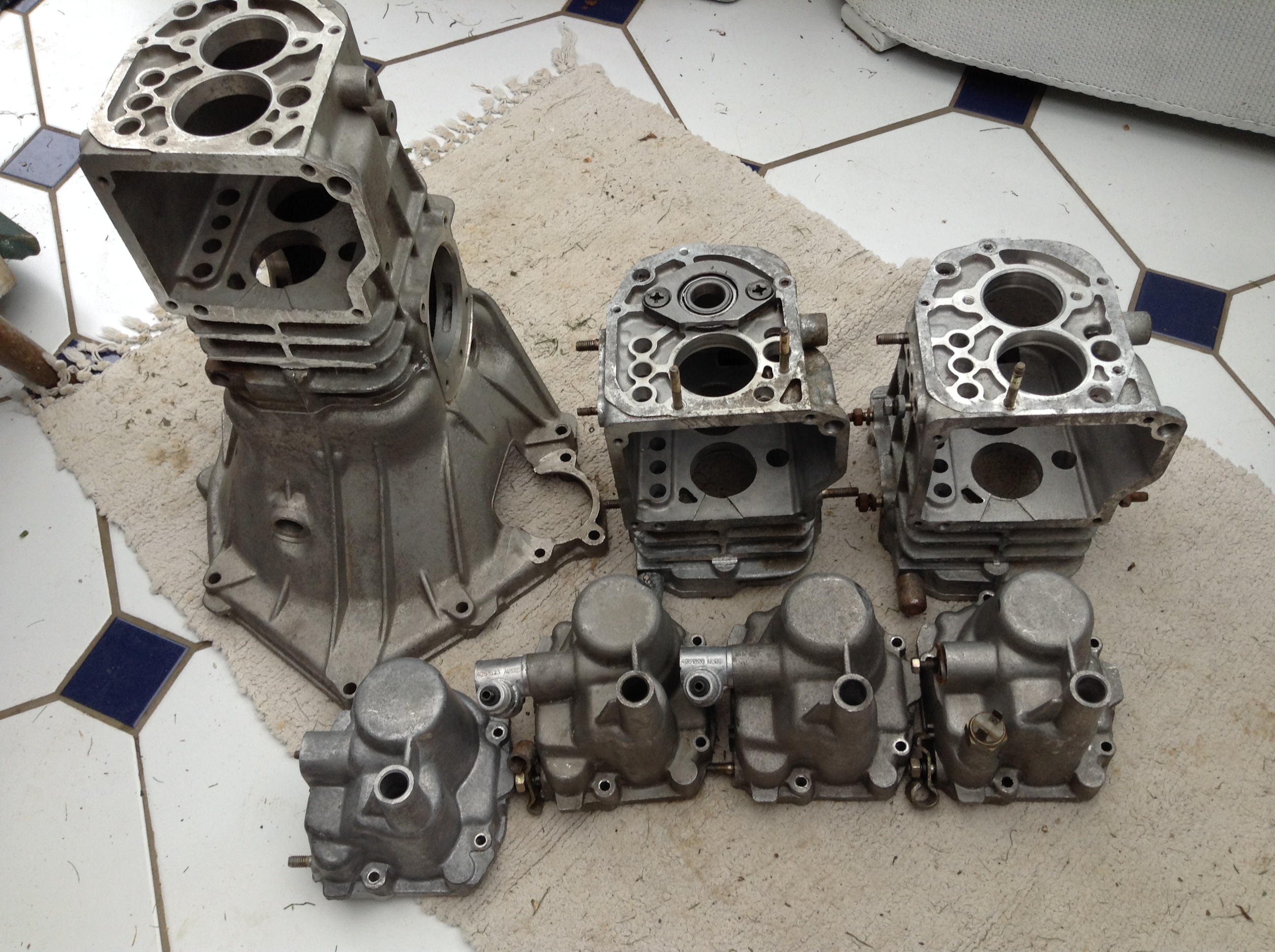

I went in at the deep end having never tackled the Fiat gearbox before. I got fed up with tripping over the seven 126 gearboxes I had here. I knew some had problems so with the Haynes manual to guide me I stripped them all down at the same time then initially rebuilt three good gearboxes then with a few new bits another one later.
