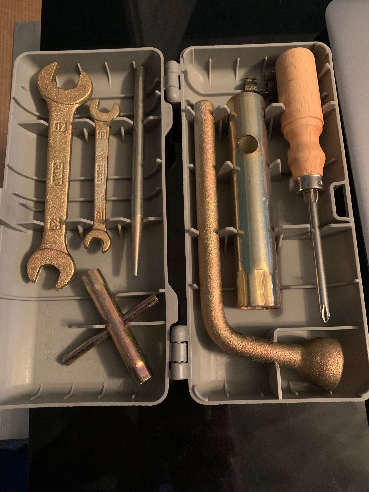

I've worked on Fiats from the 60's - 80's and have never seen a pliers of any type in the car's toolkit, but all have had the little 8 x 10mm box spanner with the T-bar (the ends of which are crimped/squashed? to prevent it falling out). Also there were 2 styles of wheelbrace, one type had a large screwdriver end and was designed for removing pressed-on hub caps (chrome or stainless steel) on cars so-equipped, other type is like your wheelbrace , plain end for cars without hub-caps or bolted on hub-caps. Also there were 2 lengths of plug spanner supplied, your's seems to be the longer type.
Is there any date of printing on your Fiat 500 Shop Manual, iirc, this date used to be on the last page before the rear cover?
Al.
There is a small box spanner. I suspect the reason people don’t remember them is because they always seems to go missing! I think most of the ones on eBay I have seen, it’s missing. No pliers in my one either. You know me I do like a bit of originality.;)
I suspect there's 2 reasons why these little 8 x 10mm box spanners go missing.
1. The 10mm end can be used to remove the idle jet for cleaning at the roadside (I seem to recall many here continue to have running problems often traceable to a clogged idle jet :) ). Also the 8mm end can be used on the points hold-down screws in order to adjust the gap at the roadside. I reckon that most motorists are so elated at having got their car running again at the roadside, that they just drive off, leaving the little box spanner behind on the road. :D
2. Believe it or not, this same little 8 x 10mmm box spanner was also included in certain classic Ferrari models' car toolkit - have you seen just how much a complete toolkit for e.g. a 250GTO, 330GTC,365GTB4 etc. sells for (or should I say is being asked for :p ). Admittedly the Ferrari issued item has Ferrari stamped on it's side, but that's a moot point - what was stamped once can be stamped again, iow, where there's a will, there's a way. :devil: So it could be that classic Ferrari Owners and Restorers have been stealing them out of any old Fiat toolkits they've encountered in the past. :D
Al. :)
original box spanner present in my kit, amazingly. As to where it goes; I studied many photos and this seems to be the spot. It's not anchored by anything and there doesn't seem to be an option to do so. However, I like Alfadeke21's suggestion of hiding it in the spare wheel.
RE:- Box Spanner
The box spanner is in the correct spot, but, for complete originality
(in my work,I used to have to check that all tools were present and correct, must have opened and checked 100's of these toolboxes when new and s/hand),
the box spanner needs to be rotated 90 degrees clockwise so that one end of T bar goes through the small cut-out/notch in the box near to the hinge - I realise this will look 'wrong' as it distorts the plastic mounting lugs for this tool - but that's how they were from the factory when new....

I have a couple of toolkits. One is pretty much brand new and never been used.As per the pic.
The only item I've used from my "run time" kit is to remove the spark plugs to swap them over (y)
