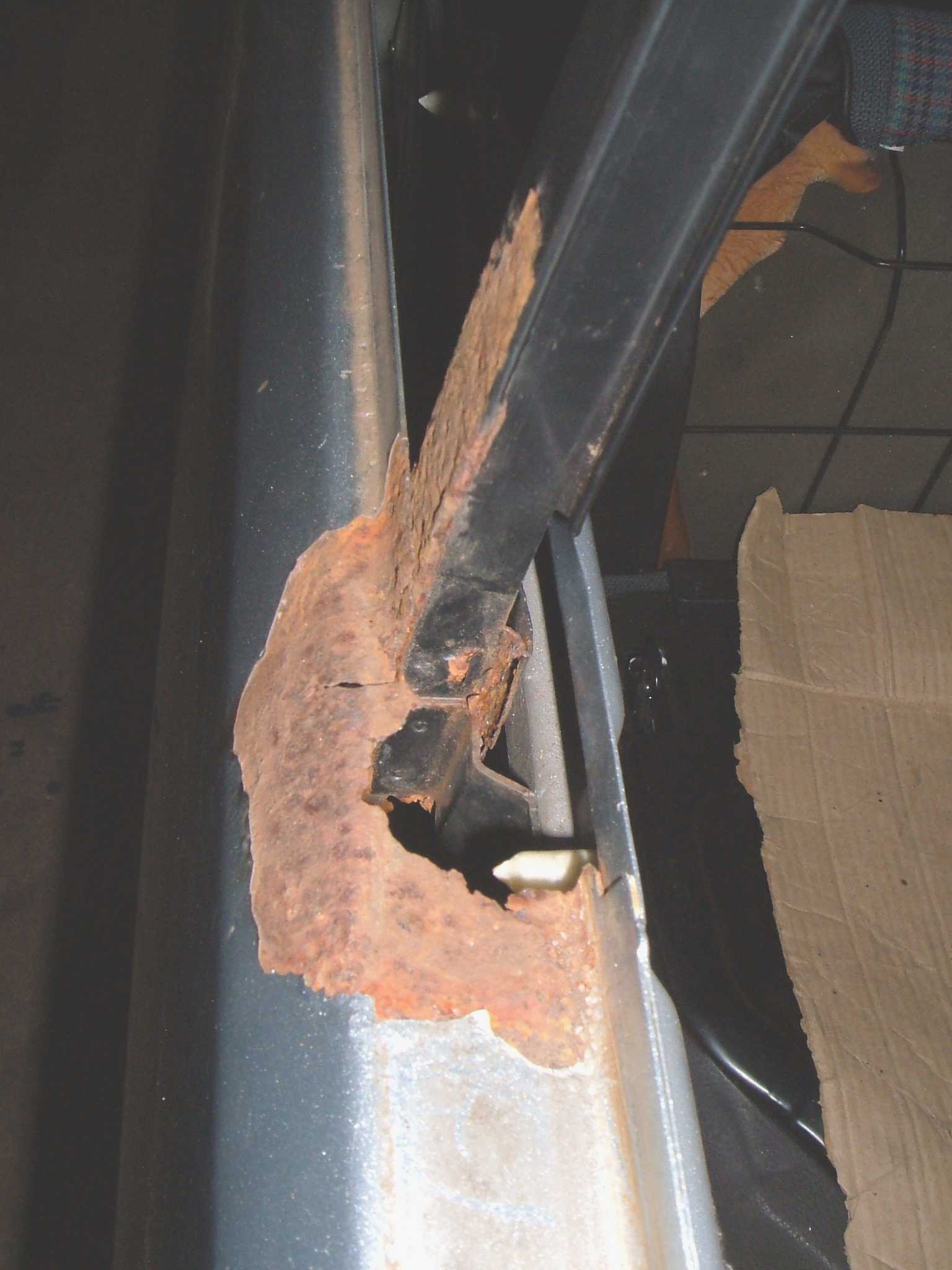

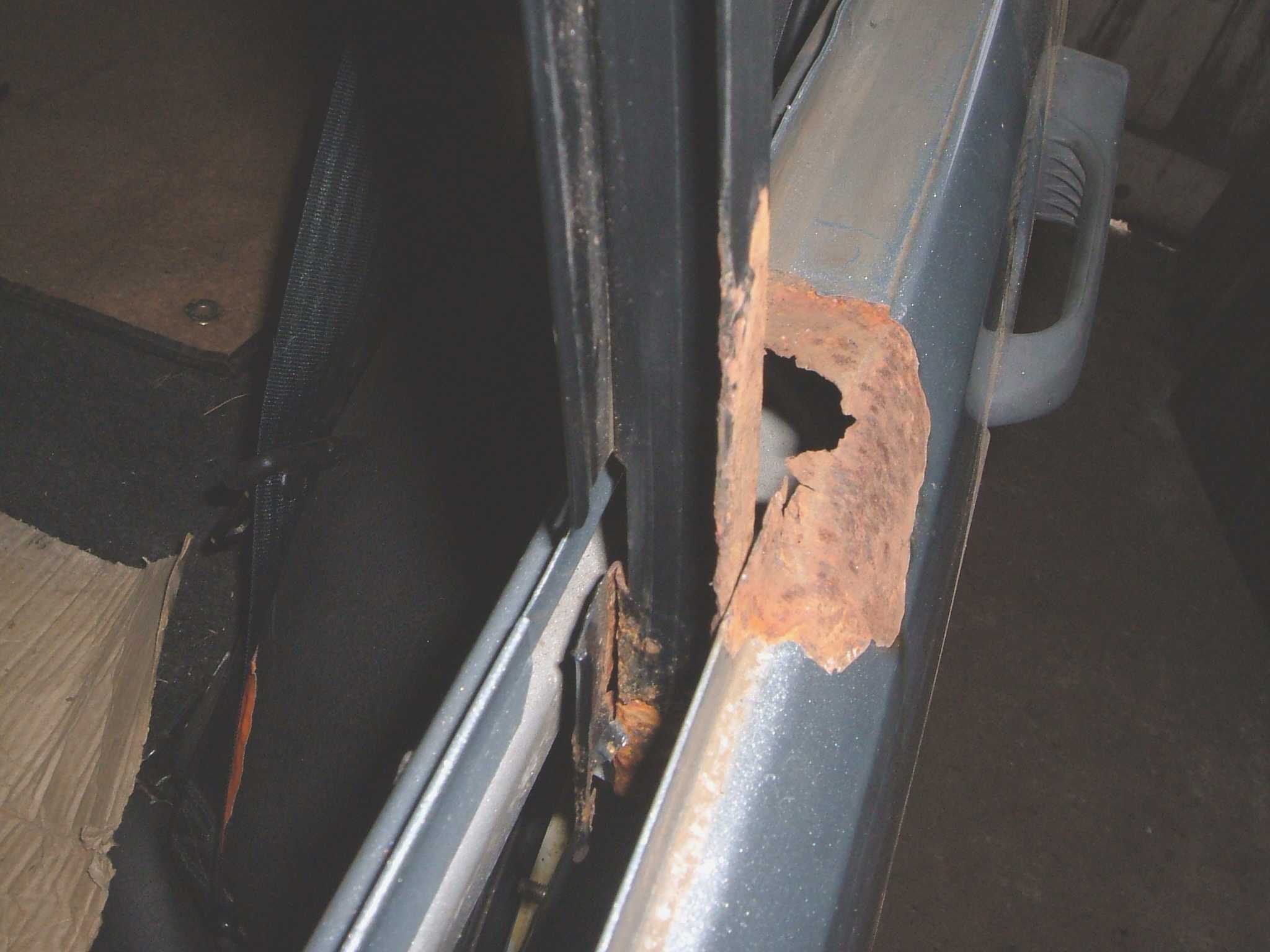

below two pics of the LH door problem after all glass and rubber taken out and the channel/ finisher screwed back in place. i think the rust starts on the ledge first and over time creeps forward and then engulfs the channel as well.

Both my 1992 tipo and 1991 spares car have rust in the same place on the same door.. Whatever that's about! All the other doors are fine. There are pics in some of my other posts. No developments with my car, it is on the back burner for the moment. I stripped down the offending door on the spares car ( I will try and take a few pics at the weekend). Did not really want to take the door off the 92 diesel and leave it exposed to the elements as things are fragile enough already with it!
