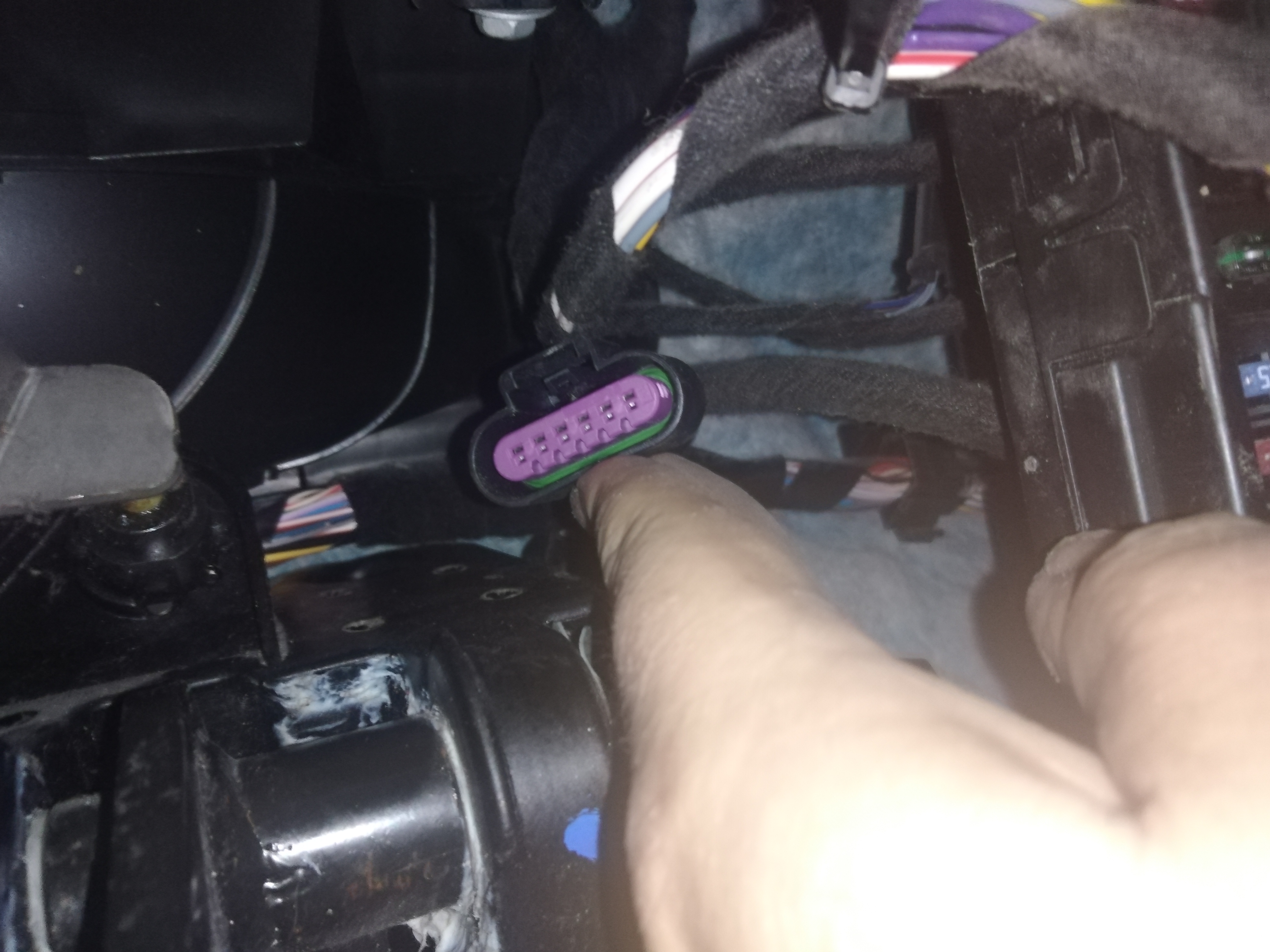

Can I take down the body computer to give me visible access?
Not easily
It's fixed into place in different ways
Some use 3 bolts not too bad
But my current car has 3 aluminium rivets which need to be cut then replaced
Most of the wires will have to come off for it to move

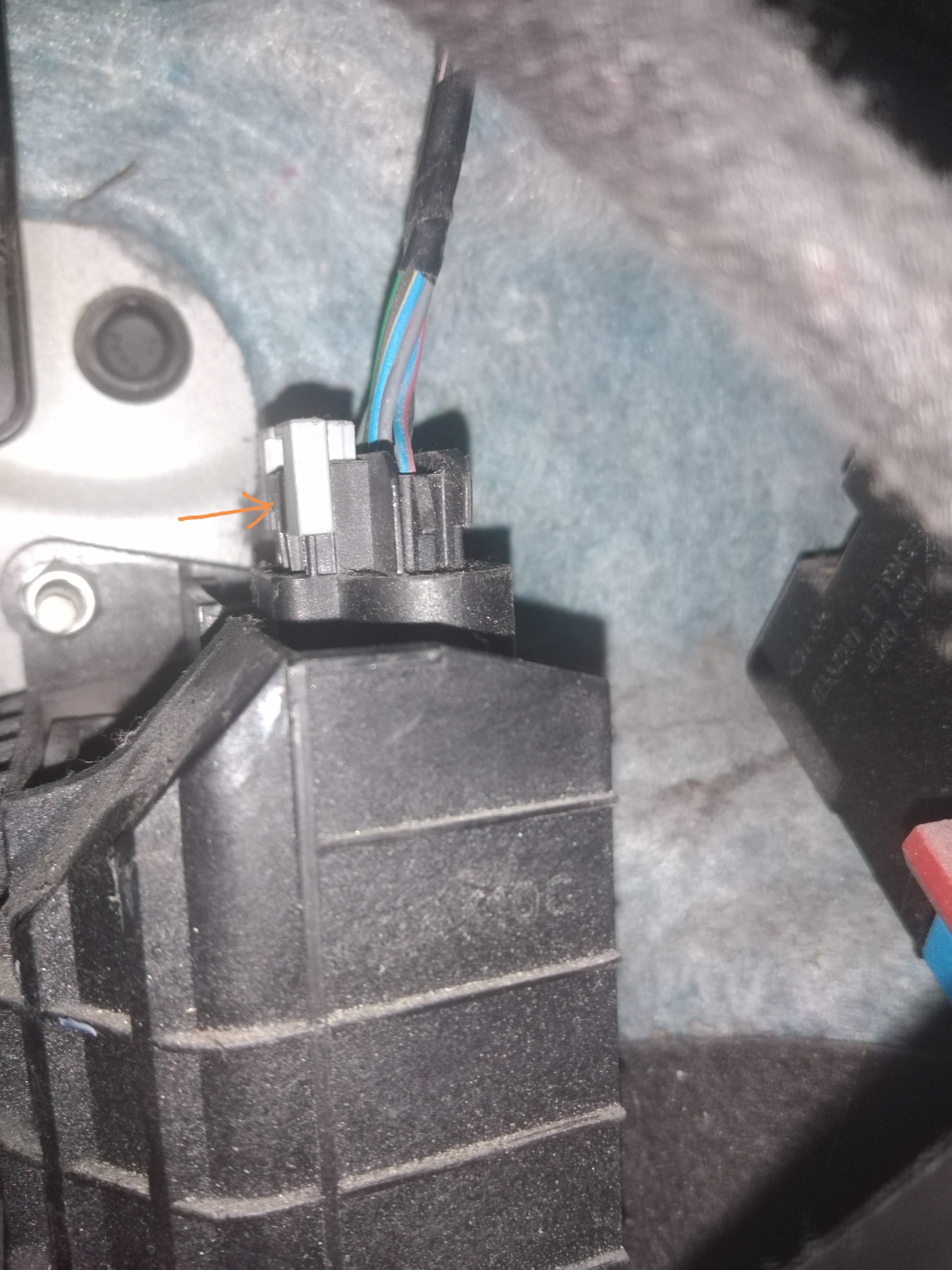

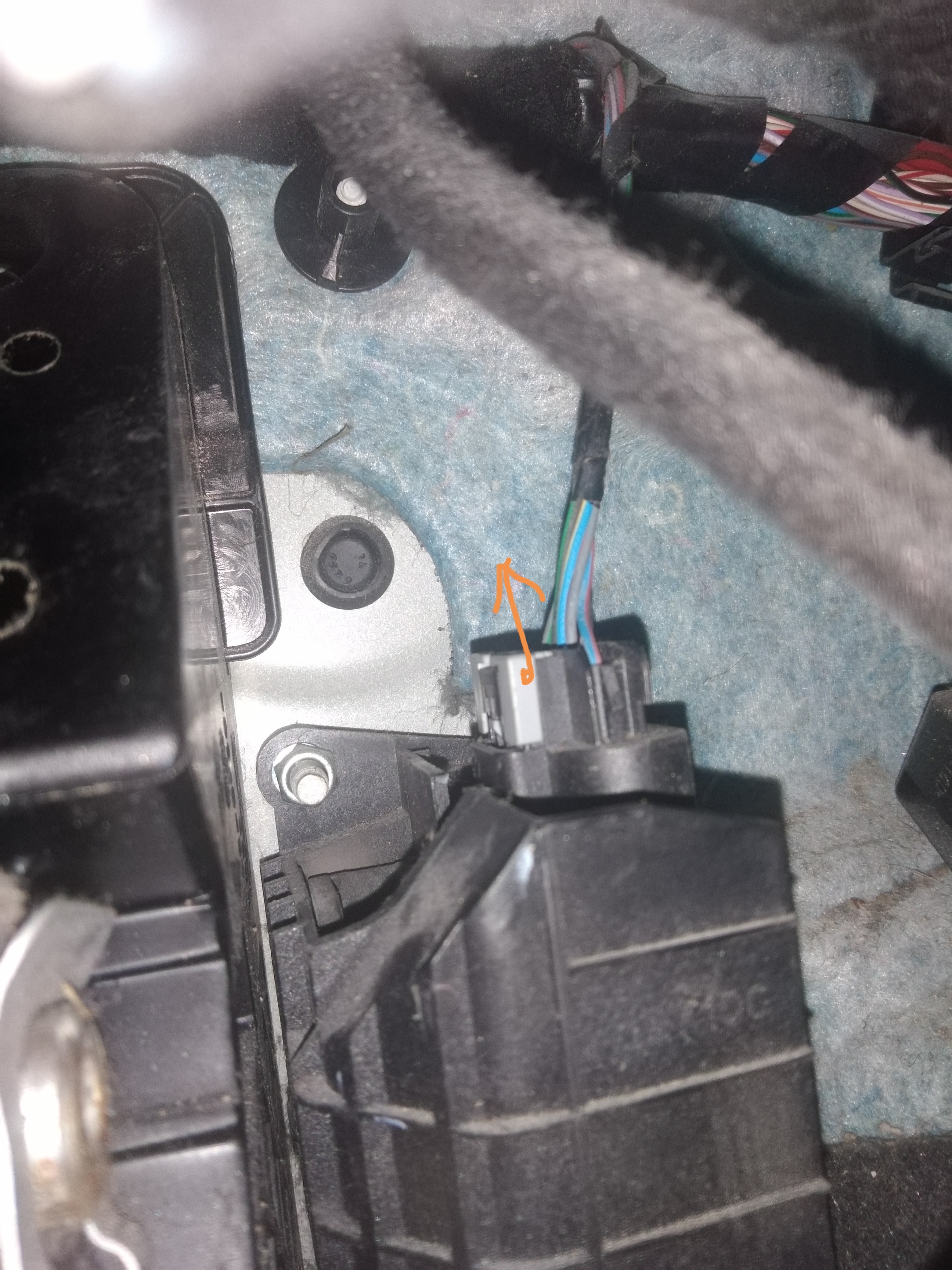

This part needs to be lifted up
Then this part needs to be pushed in while pulling the connector upwards, the easiest way I found is to push both sides while pulling up, left handed
Brake got in the way to try right handed
Engine does not run right, engine light comes on
The code does not self clear
As long as the code is present, the car doesn't run right, you can smell petrol
I used an android with car scanner to clear the code, clearing the code was a faf, Unless I pulled the blue tooth elm adaptor out before switching the ignion off it would return, have come across this before

Fantastic pictures and now I can envisage what I am feeling for - thanks.
Once the connector is off I can try to dismount the pedal? I saw in another post that someone had cobbled a flexi extension to do it which I can copy.
Once the damn pedal is off I can see about replacing it.
Fingers crossed you will not need to replace it
Pulling the connector off and pushing it back will normally be enough
But afterwards it will need the codes clearing

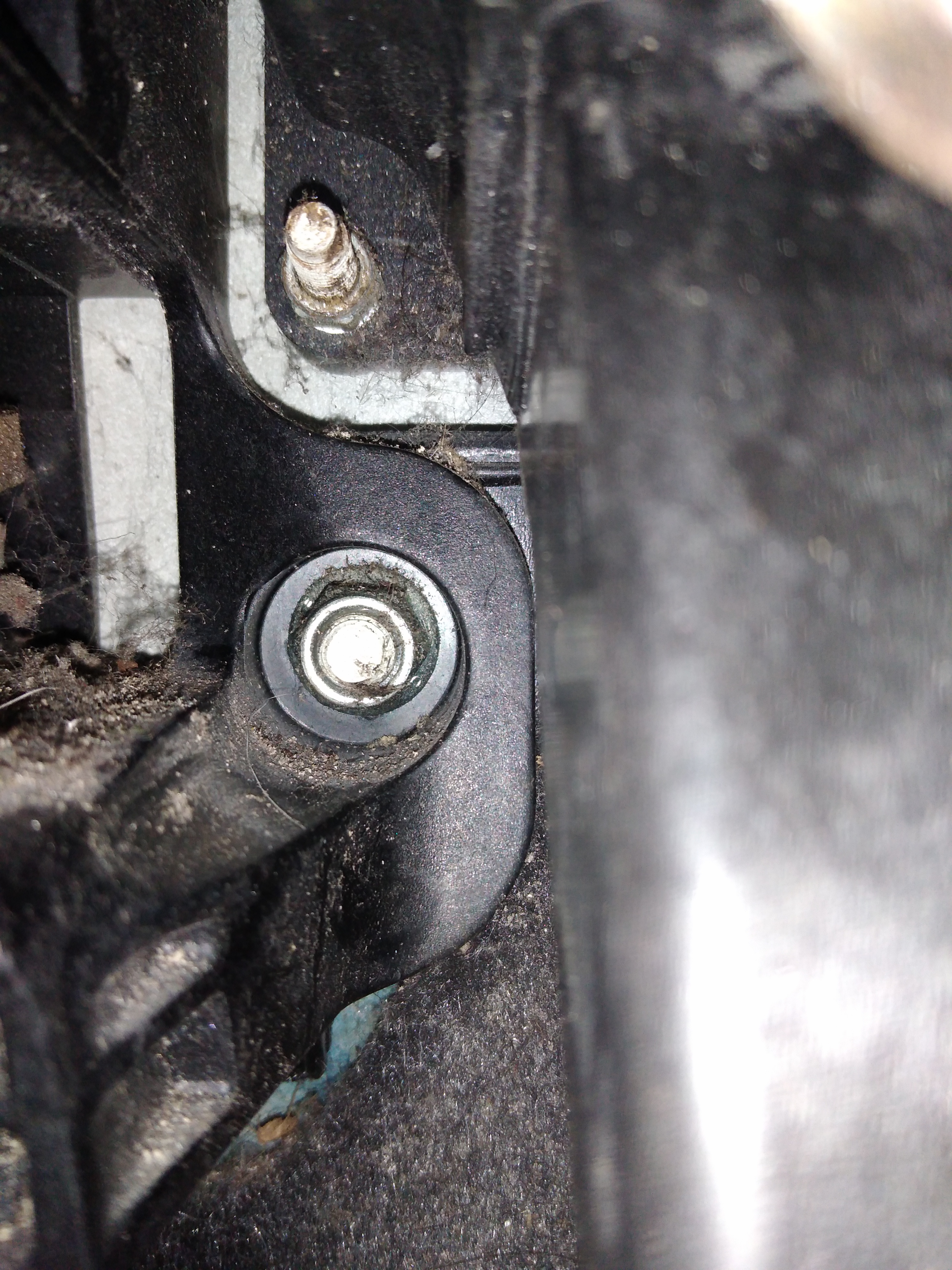

Can you tell me how many nuts are used to hold the pedal in please and where they are orientated? I have removed the one that I can see (bottom left!) and the pedal seemed loose enough to pull off but clearly something more is holding it so is there just a second nut to remove?
X4
One in each corner
You can see the one top left in post 21
Bottom right looks to be the hardest
Once that's done the rest is plain sailing

I can feel the thread of the stud of the top right one but cannot feel a nut. Despite this I have tried to get the socket I used on bottom left to engage top right. Likewise for top left, engaging the nut seems to elude me. The carpet seems to be in the way of bottom right.

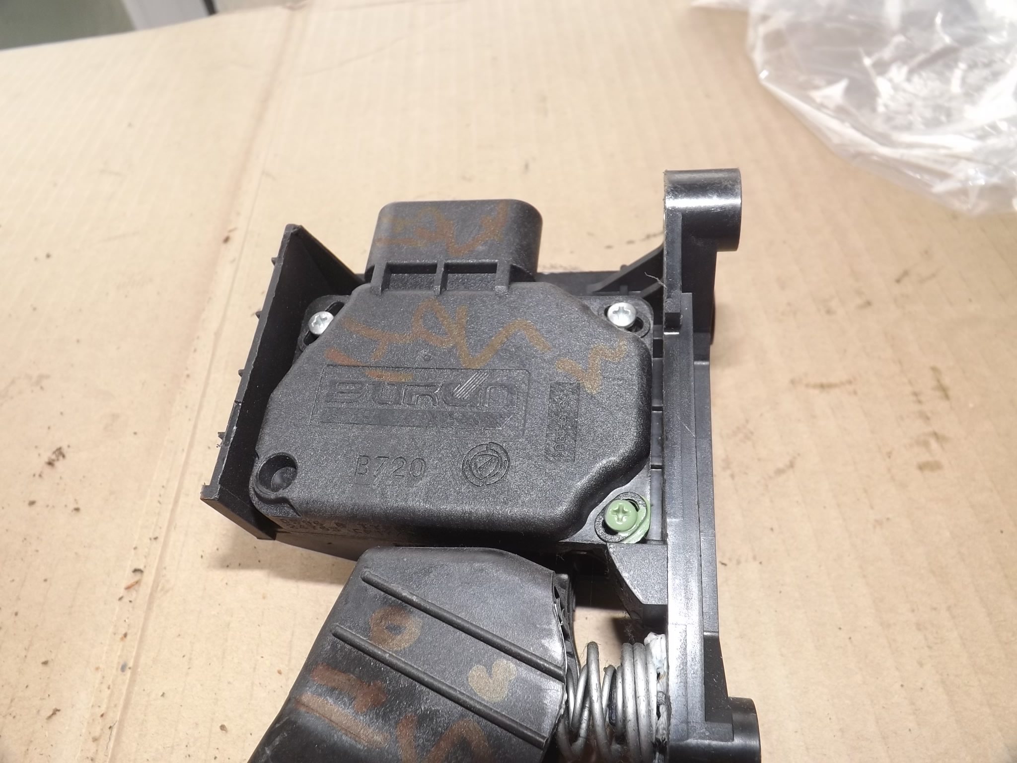

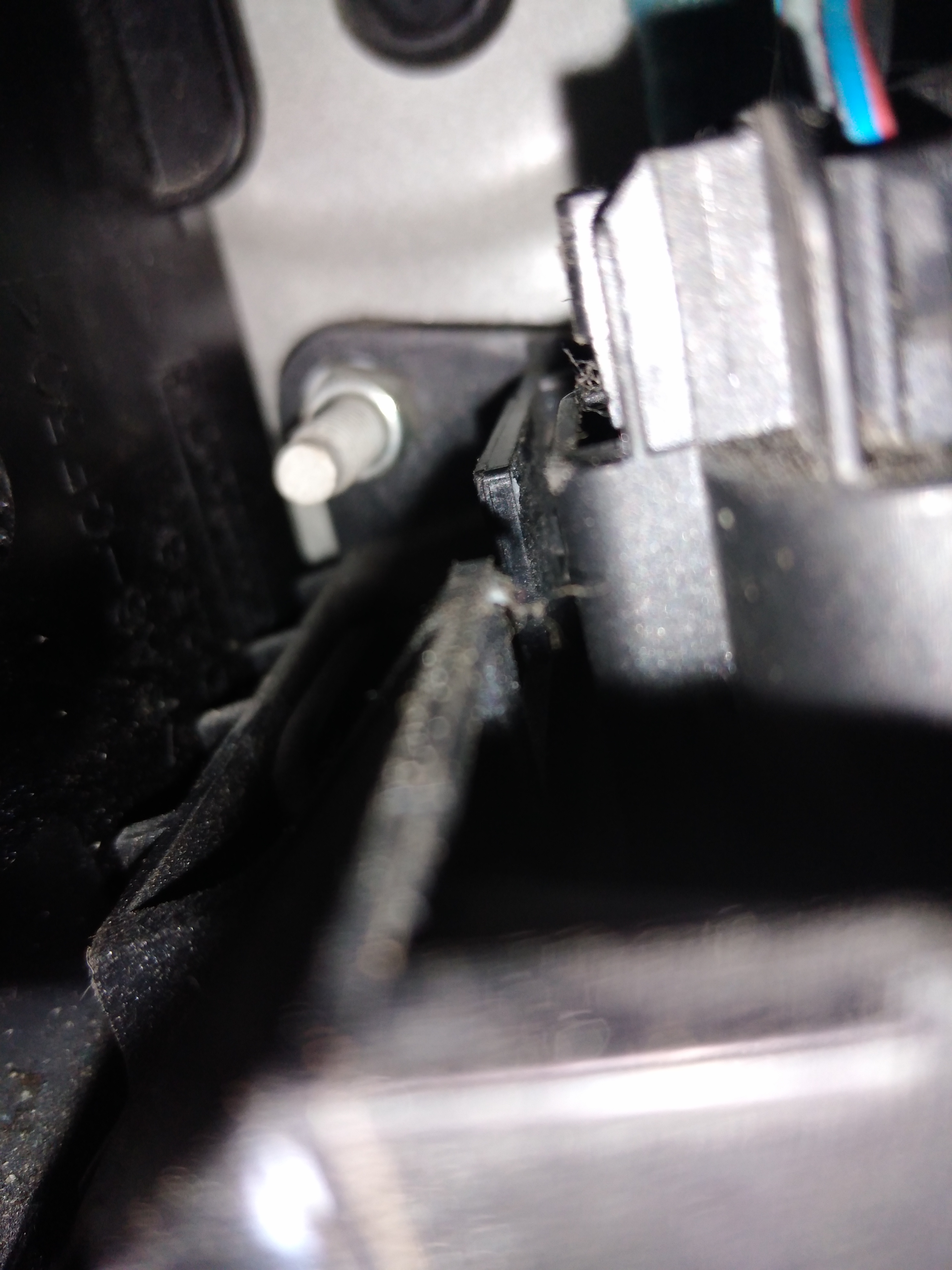

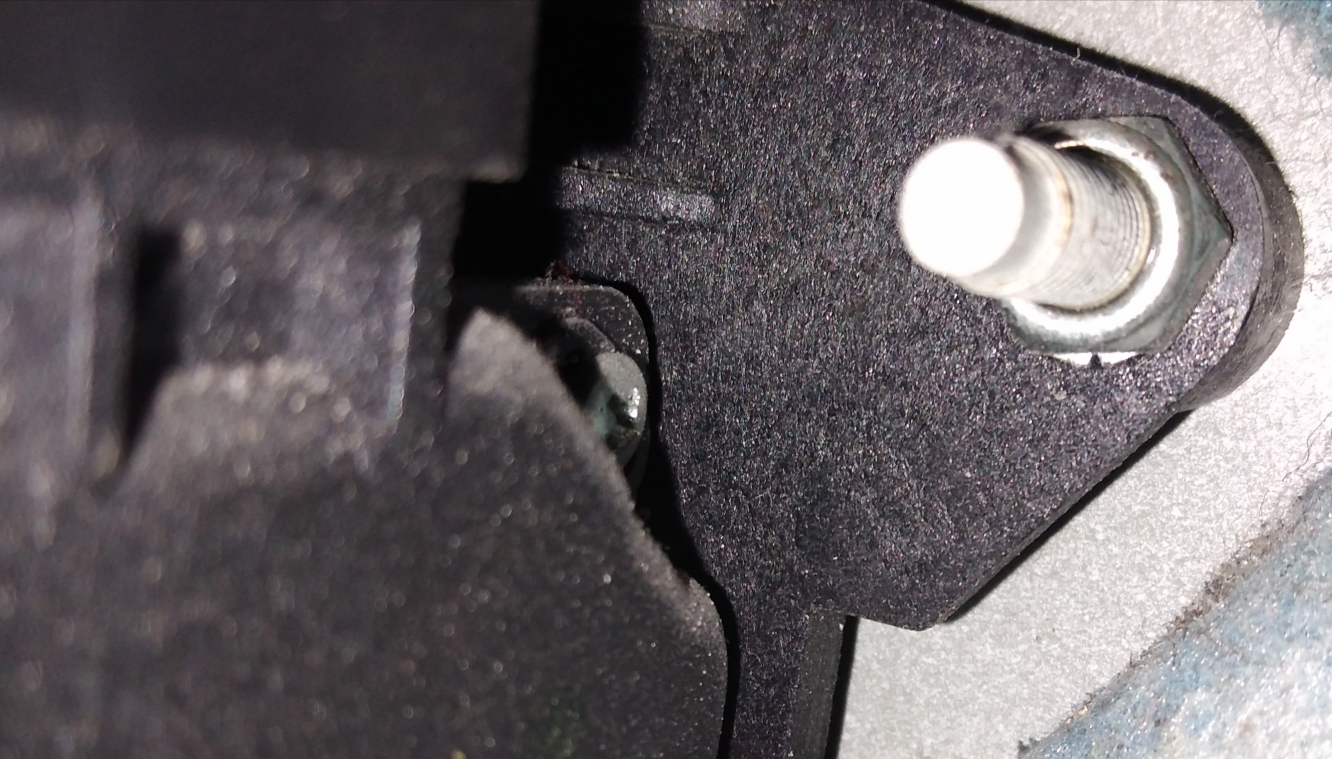

Well looky here.

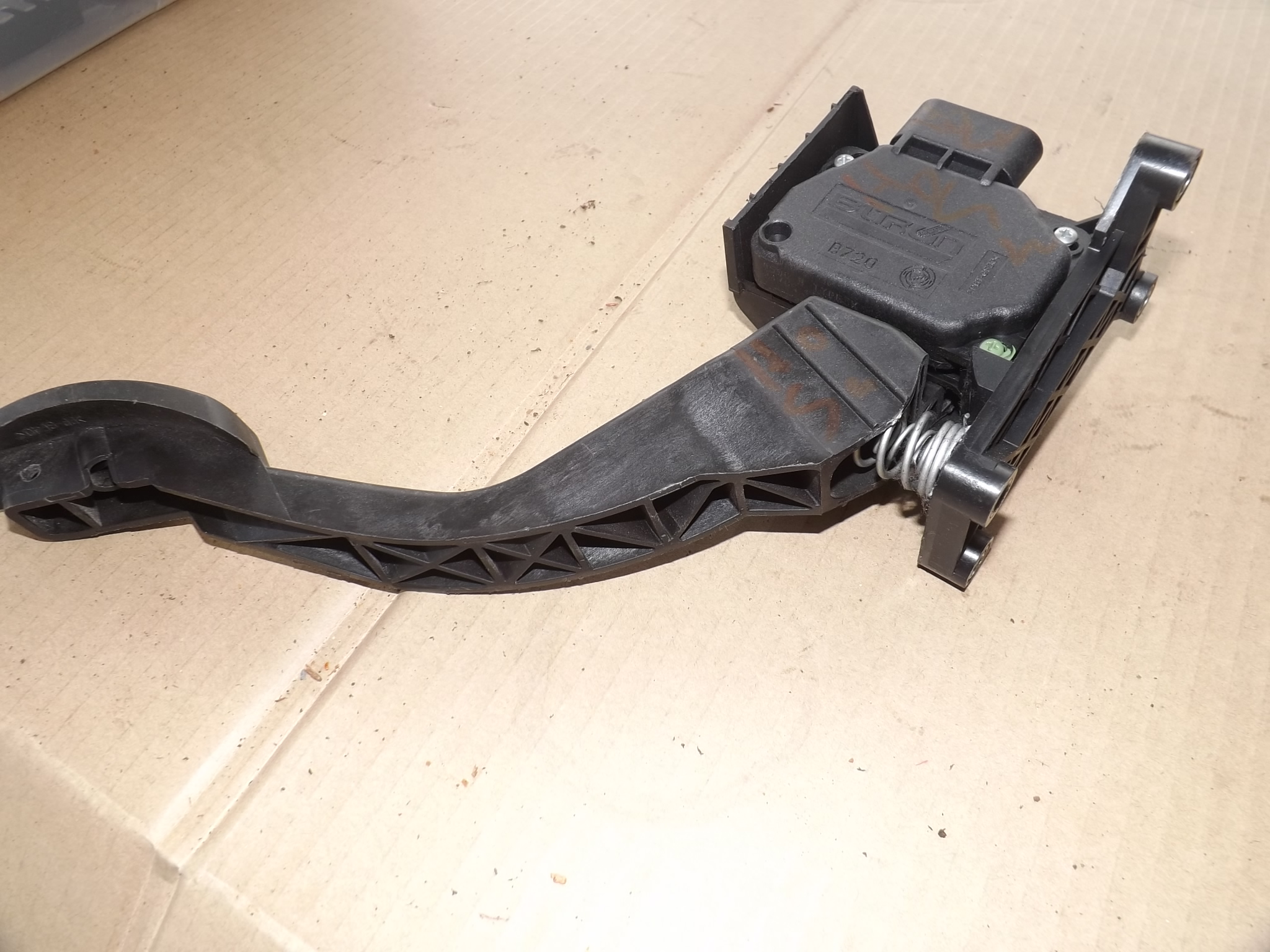

There was no nut on the top right but the insert on the pedal makes me think there was one once!!lol.
I had been using a ¼" flexible socket extension as you would expect in tight spaces. I thought about it and found my ⅜" flexible extension had much more bend and I was able to get to the top left nut and get it off. Then guess what, the pedal was free - yes there was no nut on the top right though there may have been in the past.
I am pleased to say I have the pedal on the bench so now I just need advice as to where to go from here please.
