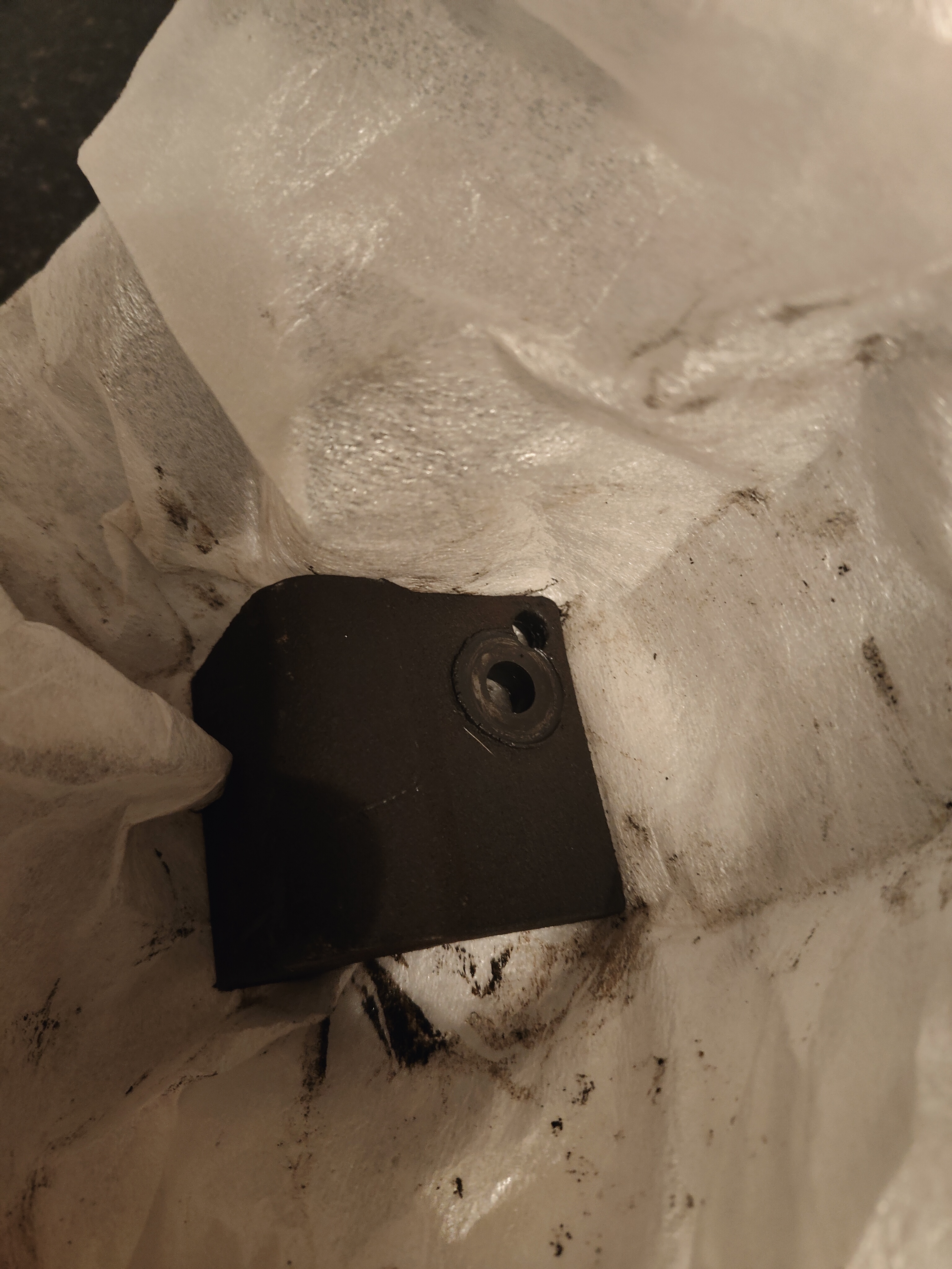

Hi i recently had my oil sump changed and after 2 days of driving i came home and this detail made sound as i was parking. What is this?
The neibour is doing mechanical repairs in his house property is it possible its not from my car? As title states its still hot

Hello,
It looks like some kind of mount or bracket. Could be from the neighbour's cars. It could make a sound if you drove on it with a tire, which made it move or even bump a little. That's how puncturing rear tires works. We drive on a flat lying metal piece with the front wheel, the piece bumps and changes its position to standing ang gets in front of the rear tires, which then drives on it and gets punctured.
What's the engine and year of your Panda?
You've got here the parts catalogue with diagrams, perhaps you'll be able to find something that looks like the part on the photos.
The file is tsv so i cant open. The car is fiat panda 2012. I drove my wife to work today i can not seem to notice anything major. But i do deliveries so for sure i will if something has unmounted. I asked my mechanic too and he also cant recall what this part is for. May be my neibour left some bits as he used the parking space in front of my house while i am working. I went under too but i can not see any damage
I think that looks a bit like a bracket or counterweight on the top, outside of the gearbox relating to the the cables from the gear-lever. The part marked number 5 here. In the car this is really hard to see as it’s underneath the metal tray the battery sits in.

Because it’s low down in the engine bay and on top of the gearbox — it gets pretty warm down there :)
Also, it could have fallen off earlier and sat on the subframe by the exhaust and then fallen from there where you parked.
I think it’s just a weight, which helps ‘swing’ the levers that the ends of the cables operate - you might find the gearchange feels like it needs more of a push into gear?
May be its possible that i do. I also feel some sound like a tiny bit grinding when shifting gears not sure if its related. The more i think about it the more i believe that may be when he banged the oil sump to disconnect it with a hammer then it might have loosened some bolts. Hopefully only this.

Whats this bracket called by any chance anyone know? I wish to check the m size of the bolt and washer i need to find

So number 5 is a damper. And i have two of them. Do i read it right? I have two of these:

Yes, Nuovo is all Pandas after 2012.
The name doesn't always help as it is translated from Italian, and not always correctly :)
But the part number should work -- 55194934 (you only have one: the engine sizes are next to each part number - the first one is the 0.9 TwinAir and the 1.2 Petrol. The other part number is for the 1.3 Diesel)
I'd call it a weight personally...
Yeah i found this but the damper part looks different on the drawing. So i wonder if ordering the bokd and washer would be same size.
Not sure that you'd need to order the bolt from a dealer - it's a pretty standard part. One EU based parts place shows it for sale for 32cents (of a Euro). Stoneacre Fiat show it as £13!! You know the thread size as you have the hole it screws into. I'd just drop into a motor factors and see what they have that fits. The original part appears to have thread locking compound on it, based on the photo here https://www.miprixauto.com/gb/fiat-...-alfa-romeo-lancia-original-oem-46429284.html -- a quick blob of Loctite Threadseal will do that for you.
You are right. We installed it! But sadly it looks like i have to change manual transmission cable and a clutch. I cant understand how all of a sudden but the clutch started to grind. Supposedly all liquid coming from the break fluit is ok.
