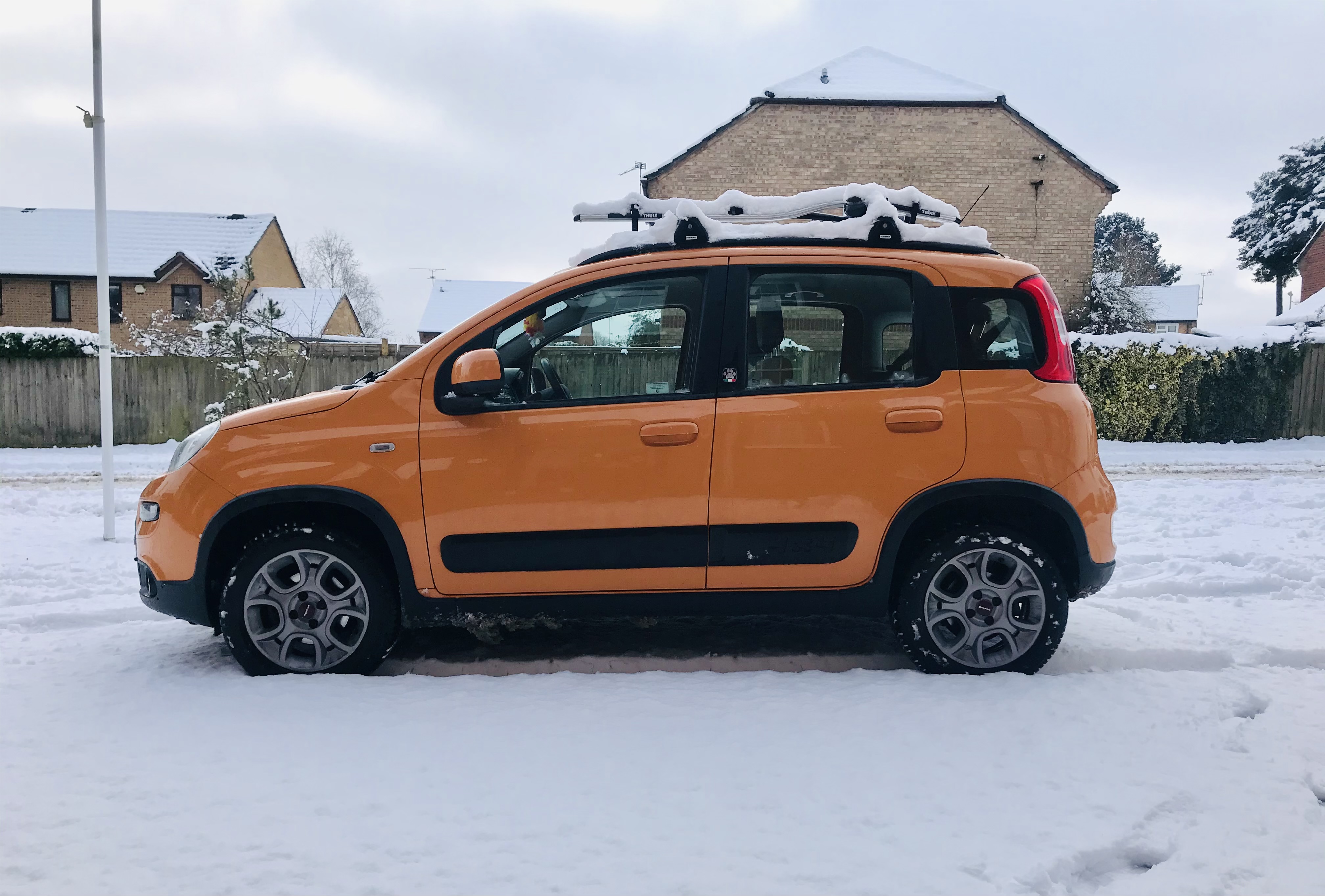

What is that loud, rotational, humming noise coming from the rear of my Panda 4x4? It’s been suggested there might be worn bearing inside the rear differential. Anyone had a similar problem? My Pandas done 84,000 miles, always serviced by a main dealer and never abused off road.
