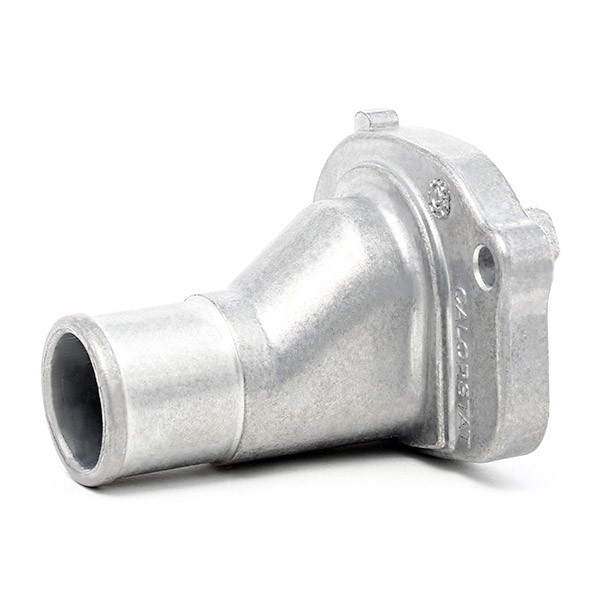

Darn, I still didn’t check the engine, is it the infamous version with the sensor plugged in the intake manifold side ? 😓
The other car (Grande Punto) has the version with the sensor on the thermostat body (and the infamous plastic spigot)
Every Fiat thermostat I replaced in the last few years came with a new sensor...
gr J
Should be like this I believe on a 1.1 and 1.2
05
06
Defently are
Later euro 5 are combined same as the 1.4
2011 certainly is
I assume the cross over is the euro 5 but I could be wrong
