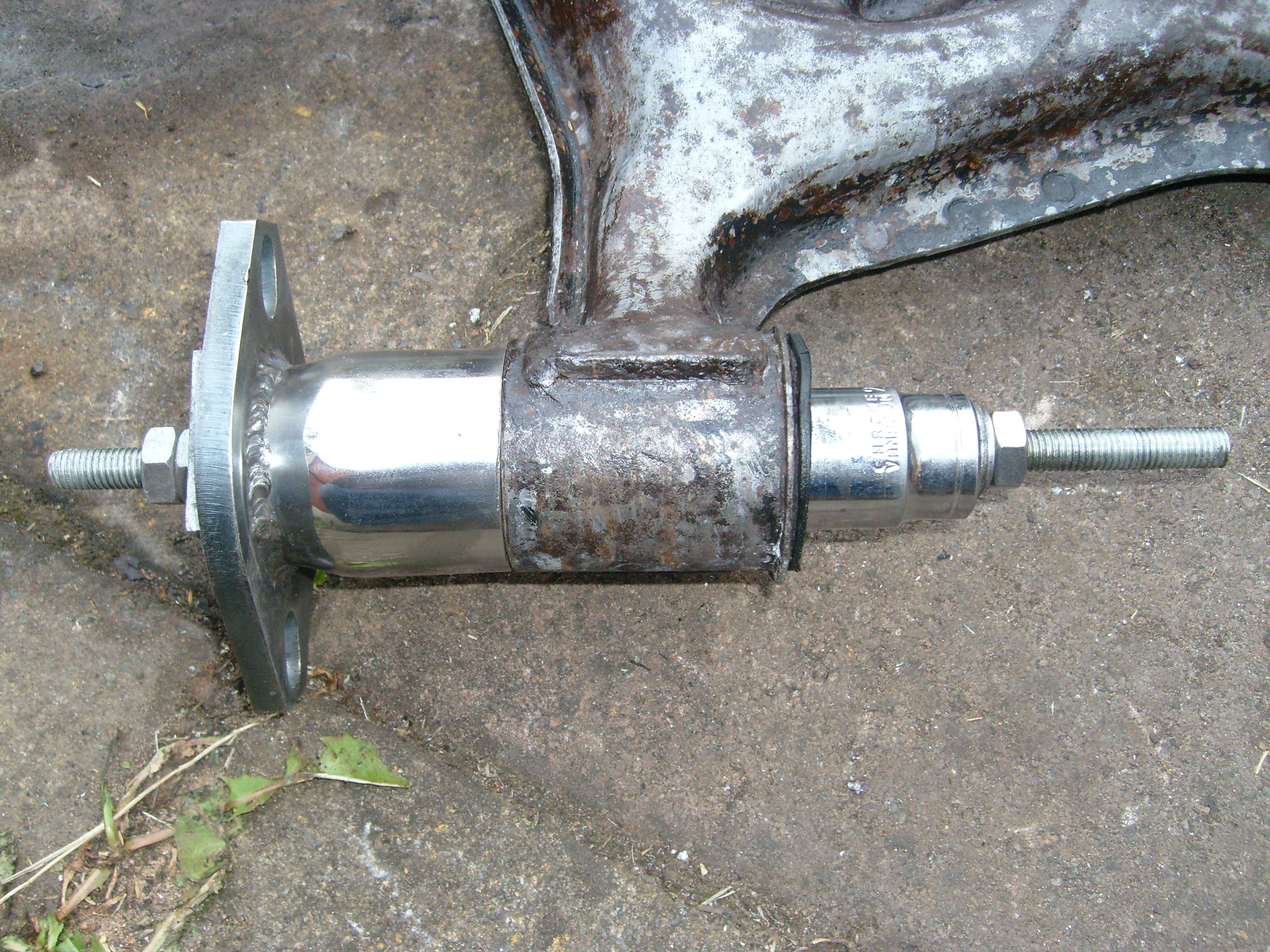

This is how I removed the rubber with metal insert.
Used a hacksaw to cut the outer tube.
I burnt the crap out of mine with the hot spanner...:slayer: not very technical I know but quite satisfying. Million points for identifying the engine on stand in background..
