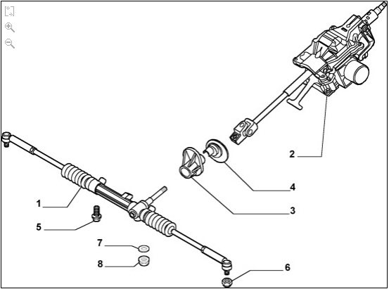

iirc you have a 1.6 so if you look down the back of the engine youll see a piece of equipment that looks like the item labelled (1) in the picture below.
coincidentally almost exactly where the marker for number (1) is, is almost the exact location of the inner ball joint, inside the ribbed gaitor.
now this will make more sense when your actually looking at it but your looking for a smooth transition in directional change when rocking the steering and looking at the relationship between the rack (silver bit) and the track rod (the thinner rod going out to each wheel) if it seems to 'clunk' or 'jump' then you have issues... you can also hold the track rod lightly and you would be able to feel if its 'clunky'... if its smooth then probably all is well.
