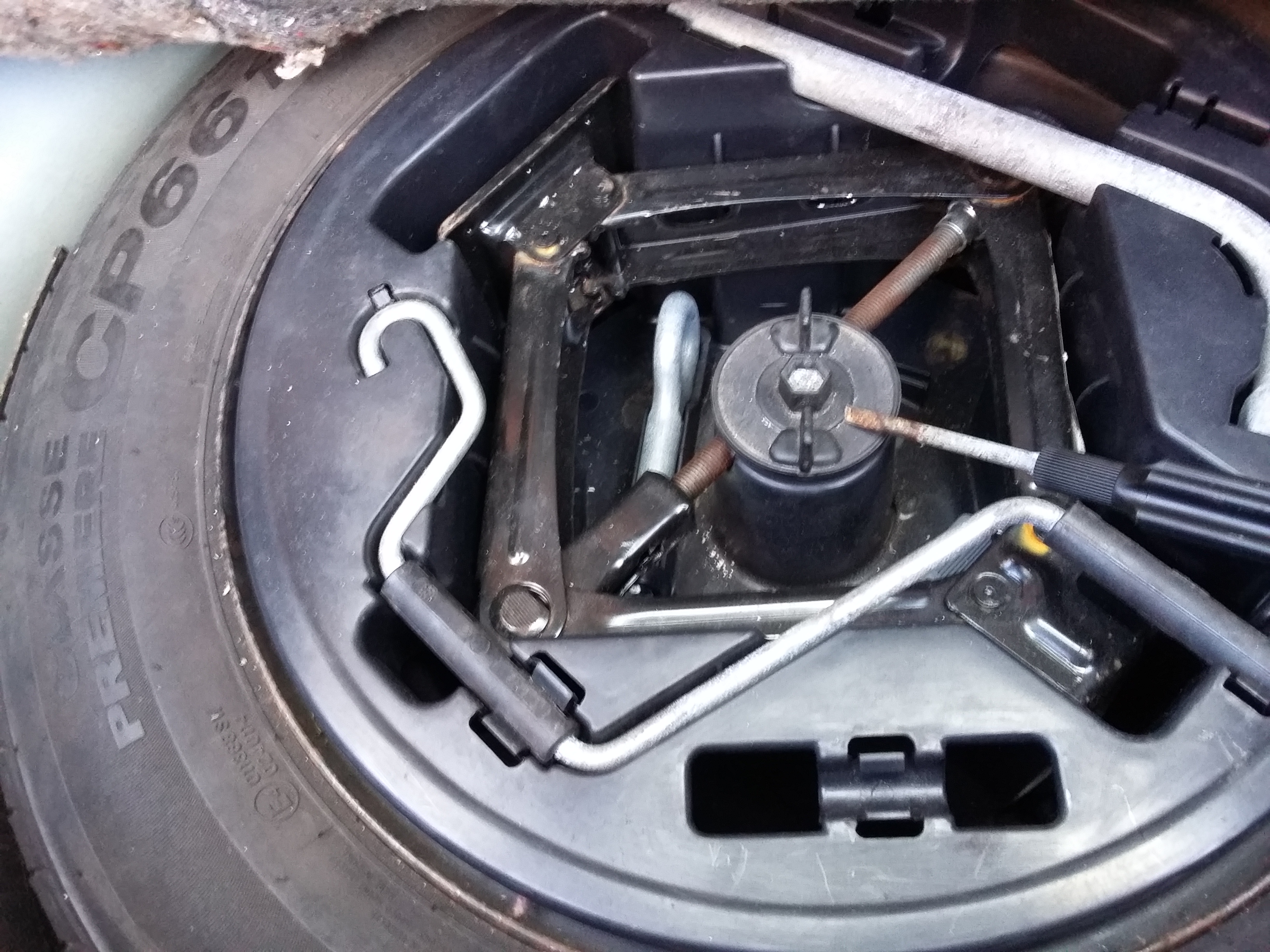

I nearly did that today..
Wanted to remove the spare..to swap it
Big plastic thumb.nut
Was stiff.. then clicking..
It was rusted in..and the plastic was riding over the Hex of its central bolt
'I know.. I will just..'
Use the screwdriver to pack out the hex..and turn the assembly
Screwdriver was phillips end out..and stuck..so no flat blade
I got out an array of sockets
The 17mm single hex was an ok fit
And it undid..a bit squeaky... but out
So lessond learned.. lubricate the thread.. and wipe the screwdriver too.. the flat and was red.rusty
The rust was holding it tight
Glad this was outside my residence.. not on the M4 hard shoulder :)
I peeked under the car.. expecting to see a rusty blob of thread poking through the wheel well
But its all inside.. perfectly hidden by wheel and toolkit
Thankfully.. the 17mm hex of the wheel brace would also undo this plastic thumbnut..at a push
