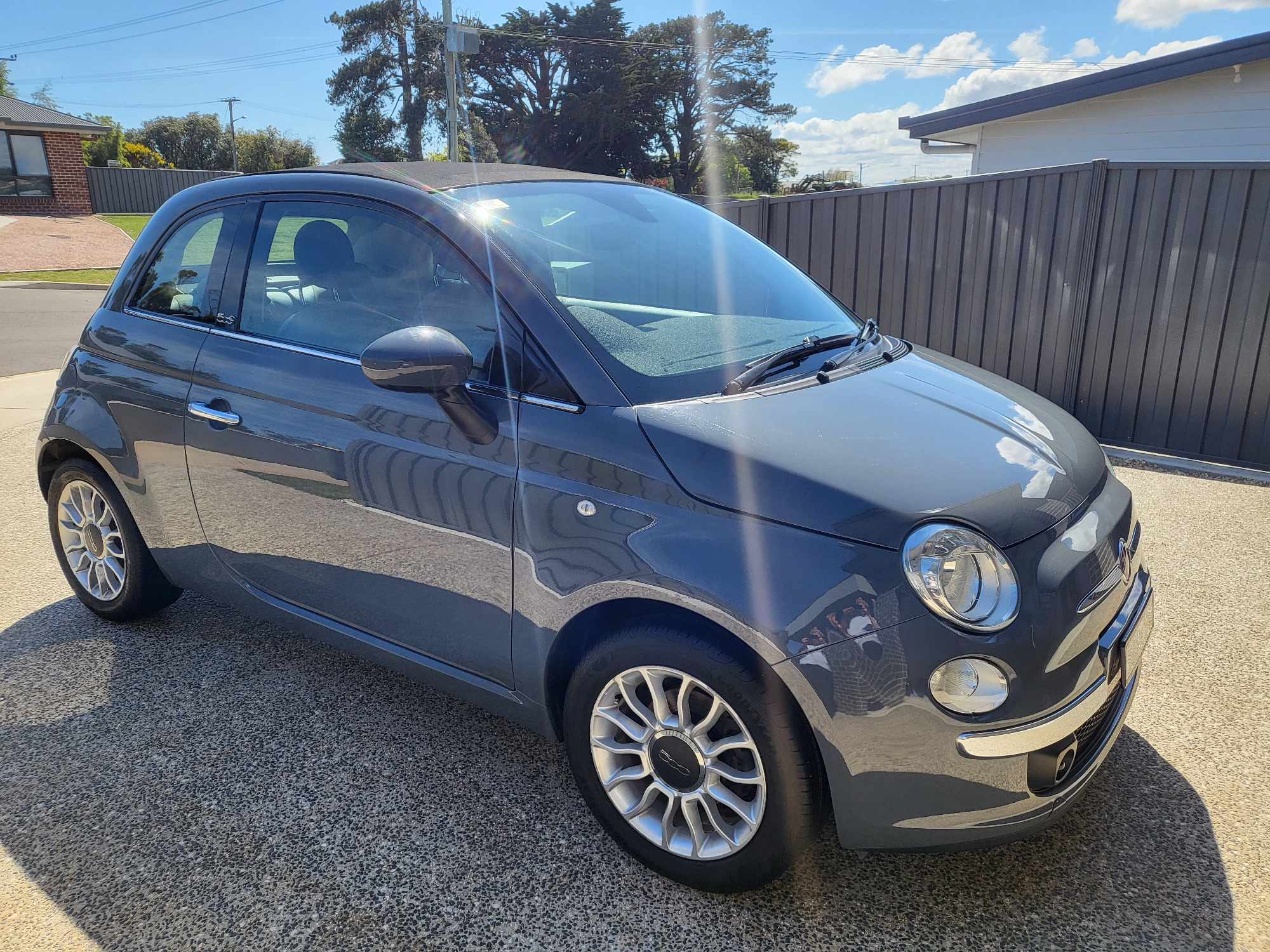

Hi,
I just had a brand new gearbox installed, have done less than 200kms since new gearbox/flywheel/clutch replaced and car is now making a little honking sound when I turn it off. Only when I turn it off. Seems like the engine cover? Local mechanic checked engine mounts and thinks is fine. He he isn't concerned by the sound, unless got worse.
The new gear box cost me 10k and the place that did it weren't very helpful and are over an hour drive away. So I want to get thoughts before I reach out to them
It's a fiat 500c, turbo twin air, 2014.
