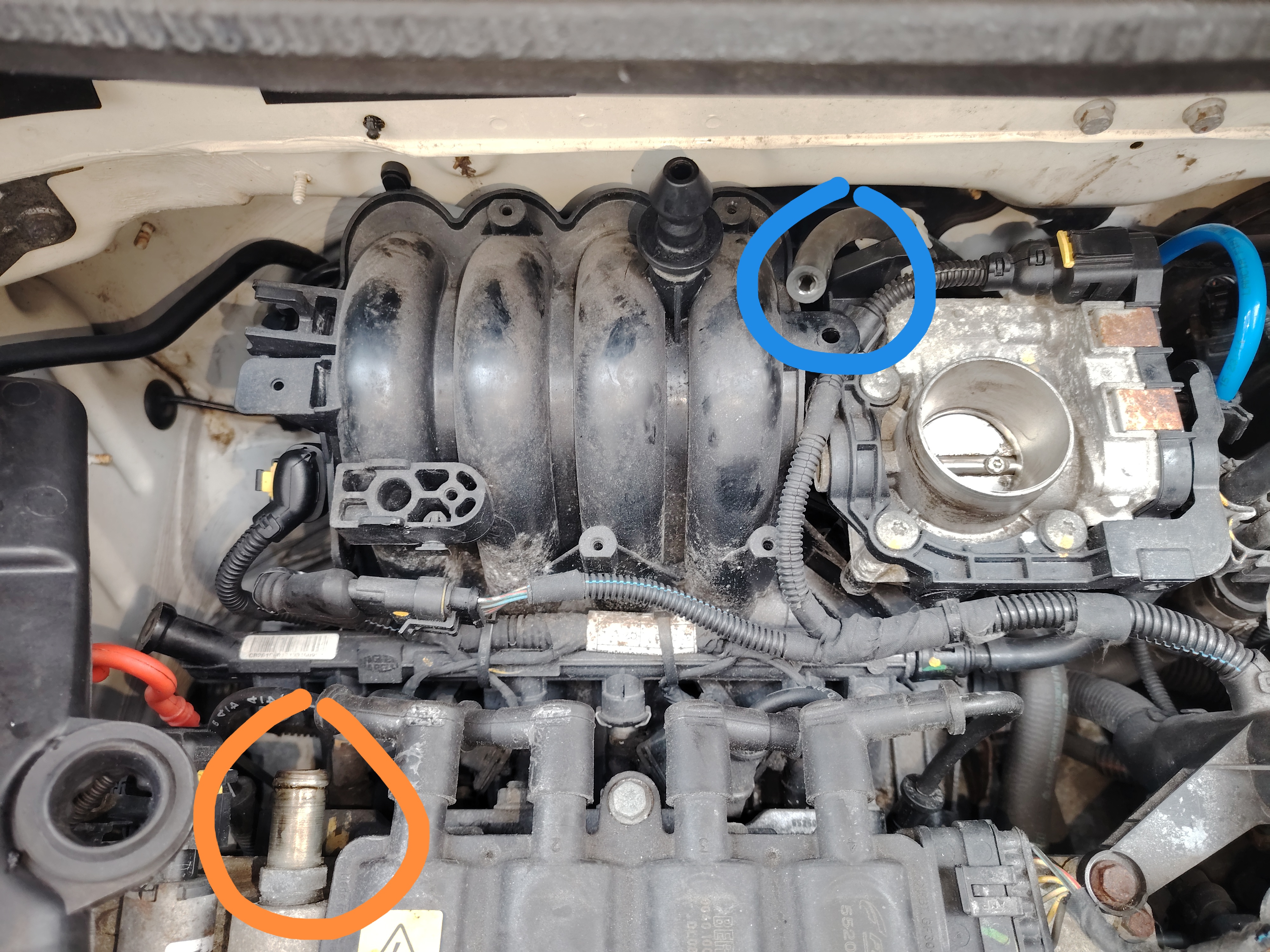

Hi, looking to carry out a smoke test to see if there are any leaks on manifold gaskets, pipes etc.
Excuse my ignorance but do I:
- remove map sensor and block hole.
- remove purge valve blue pipe and block off hole.
- Block off breather fitting (orange circle)
Feed the smoker down the smaller breather pipe (blue circled)
Please advise if I'm incorrect or there's a simpler method. Thanks

This guy uses a smoke machine regularly
So looks like there's no need to block anything off, just connect smoker directly into air intake on filter box. Thank you
Yes, I think I've only seen him feed it into the air intake. He has said that many garages don't own a smoke machine and wrongly diagnose many problems which are caused by air leaks.

Hi, so by doing this, blocking small breather and throttle the engine cuts off. What does this prove please
If put you hand over the throttle body and it carry on running you have a leak between the inlet manifold and cylinder head
If you have an issue here, it normally will not idle evenly
