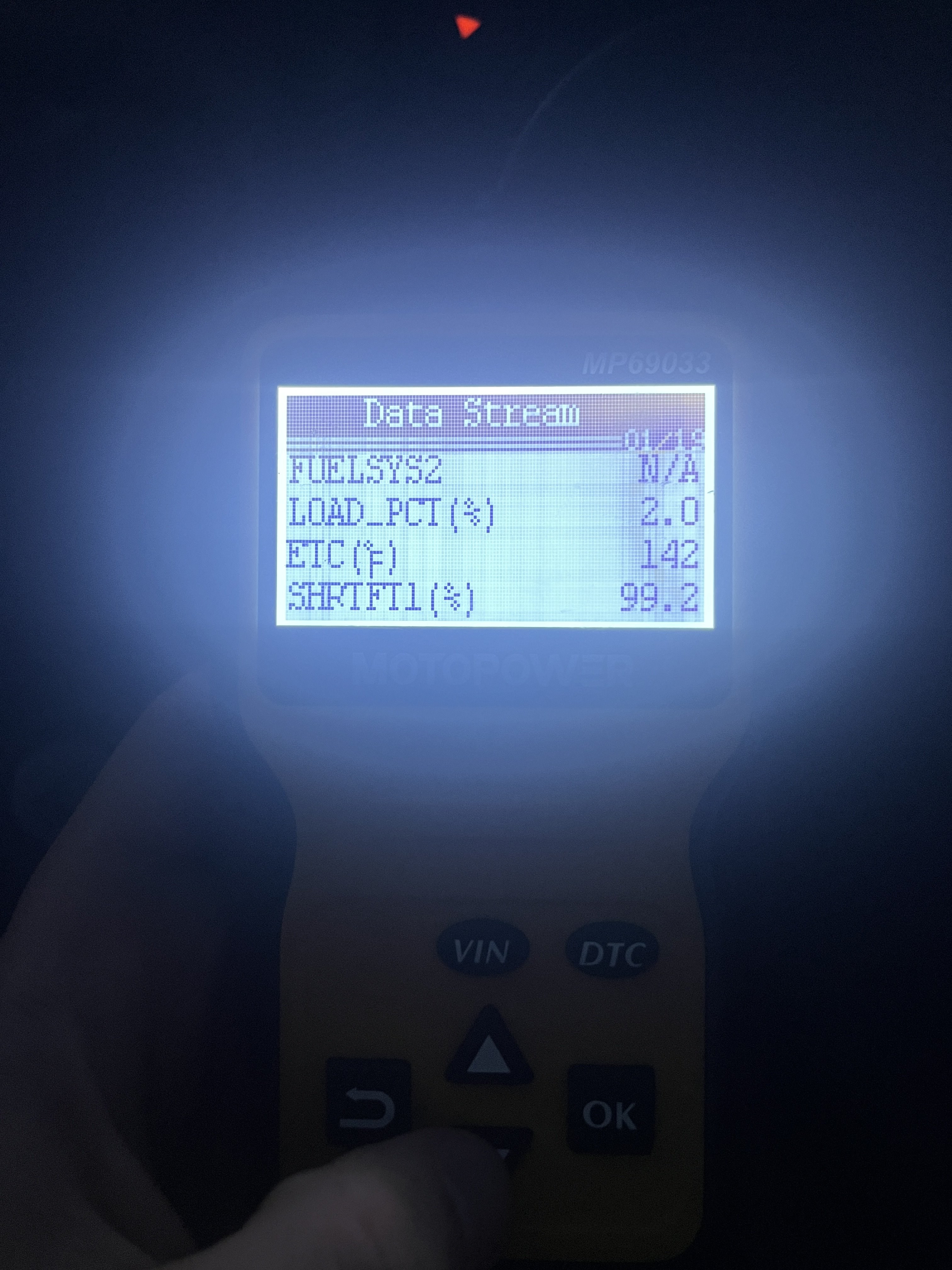

- no codes on scanner, and attached are various load readings, etc.

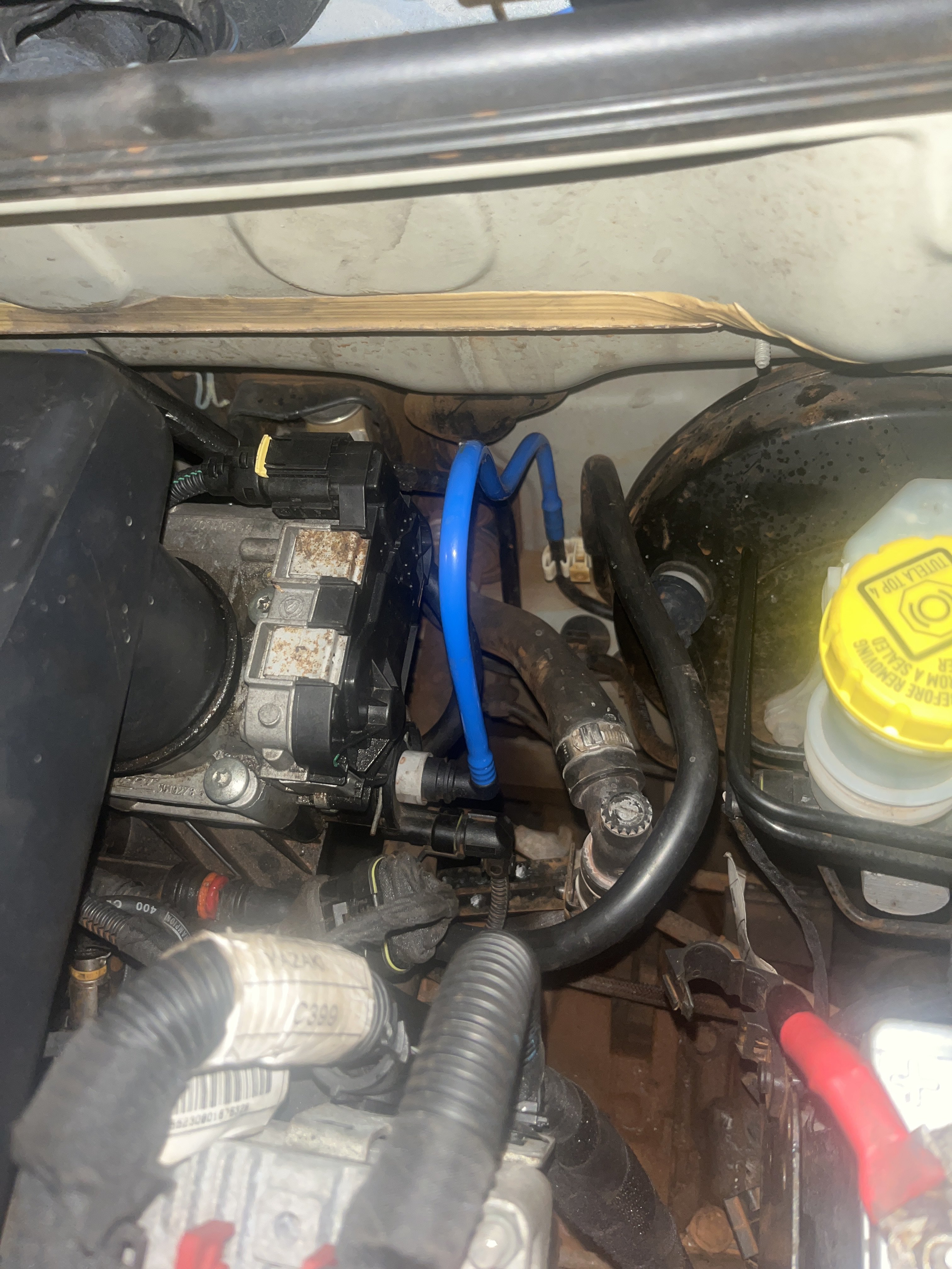

The evap system can cause fumes
Daft question, the blue pipe on the passenger side of the inlet manifold has been connected back up, the car will run fine with it disconnected
If you lift the rear seat up, you should be able to tell if the smell is from the front or back fairly quickly
Cars without split rear seats are very easy to lift up
It’s physically clipped in as much as possible
Idk if the connector itself got weirdly situated or something

Assuming the scanner is reading right
Stft are maxed out
LTFT are maxed out
What's the inlet pressure engine off
What's the inlet pressure at idle
What would those be abbreviated as?
Sorry
STFT and LTFT are the standard abbreviation for
Short term fuel trims
Long term fuel trims
On your scanner
Shrtft1 looks like it means
short term fuel trims bank 1
Normally the trims are around 0 give or take a bit
But If one is at 50 and the other is minus 50 it's still around 0
But you have both maxed out in the positive, either the scanners wrong, you have too little fuel pressure, too much air going in, O2 sensor reading wrong, or something I have missed
If it's a large air leak we should be able to see by just by reading the inlet pressure via the scanner it should read 1000 at engine off and 300 at idle

I only just realised the scanner is meant for American cars, so it’s not EOBD
I may have to have my mechanic hook up too it
