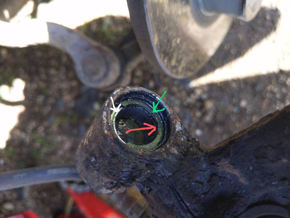

Never mind in one of you photos you can see a green semicircular ring , in the same photo at the the open end of the semi circle shiny metal is visible.
The green semi circle is all that's holding the remains of rubber boot in.
The shiny metal is the base of the hole that stops the boot going too far into caliper.
So you need to find a screwdriver that you can push under the green bit but above the base of the hole. I'm thinking start with a thin blade, it may have to be Sharp after all .

Green arrow metal semi ring retainer
White arrow gap in retainer ring , shiny metal caliper metal at base of hole .
Zoom in on pic the black line between green ring and base of hole is remains of rubber. Put thin screwdriver blade or a pointed spike on this black line and push.
The rubber will give way enabling penetration between ring and base of hole.
