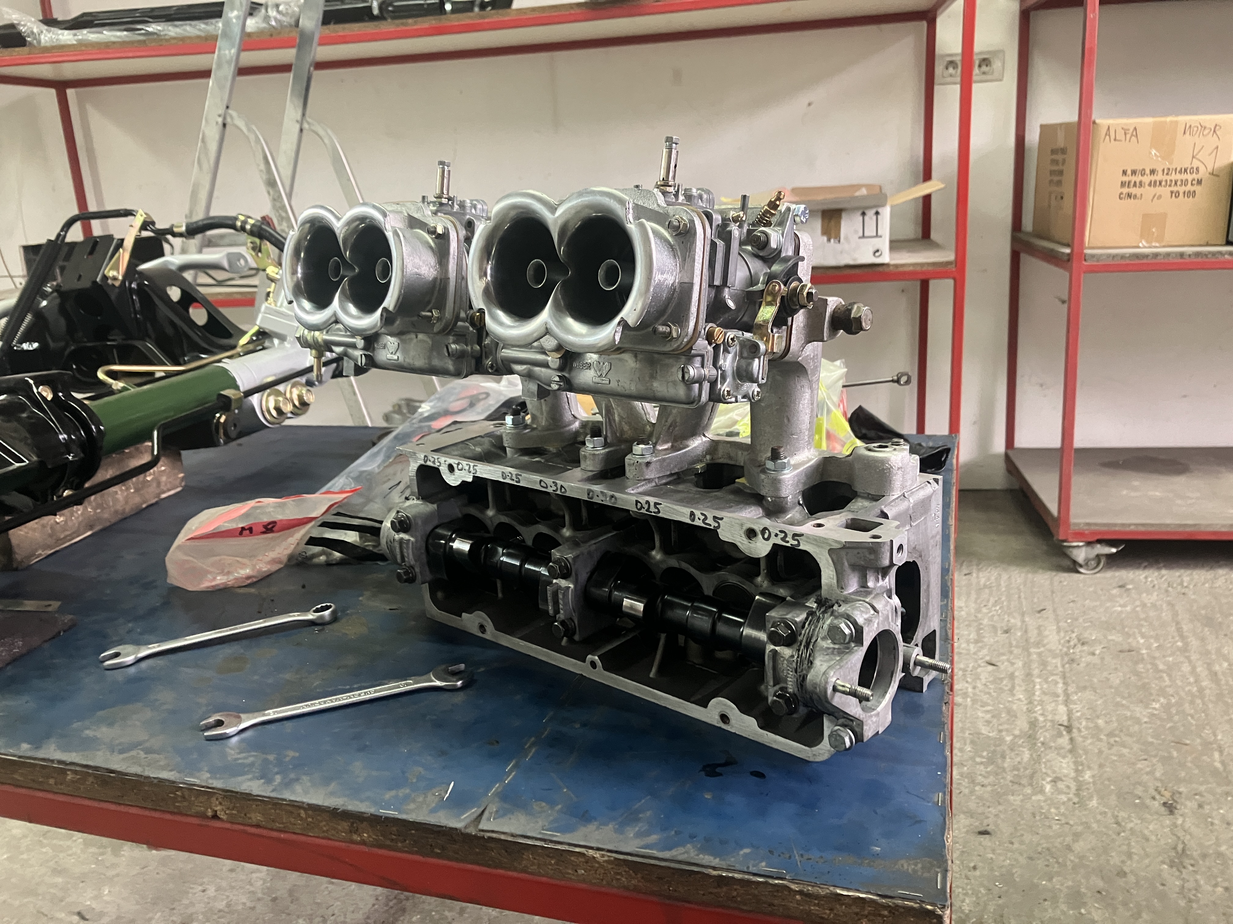

I mocked up the engine to measure clearances and to verify it will work so everything is disassembled again for decoration and storage.

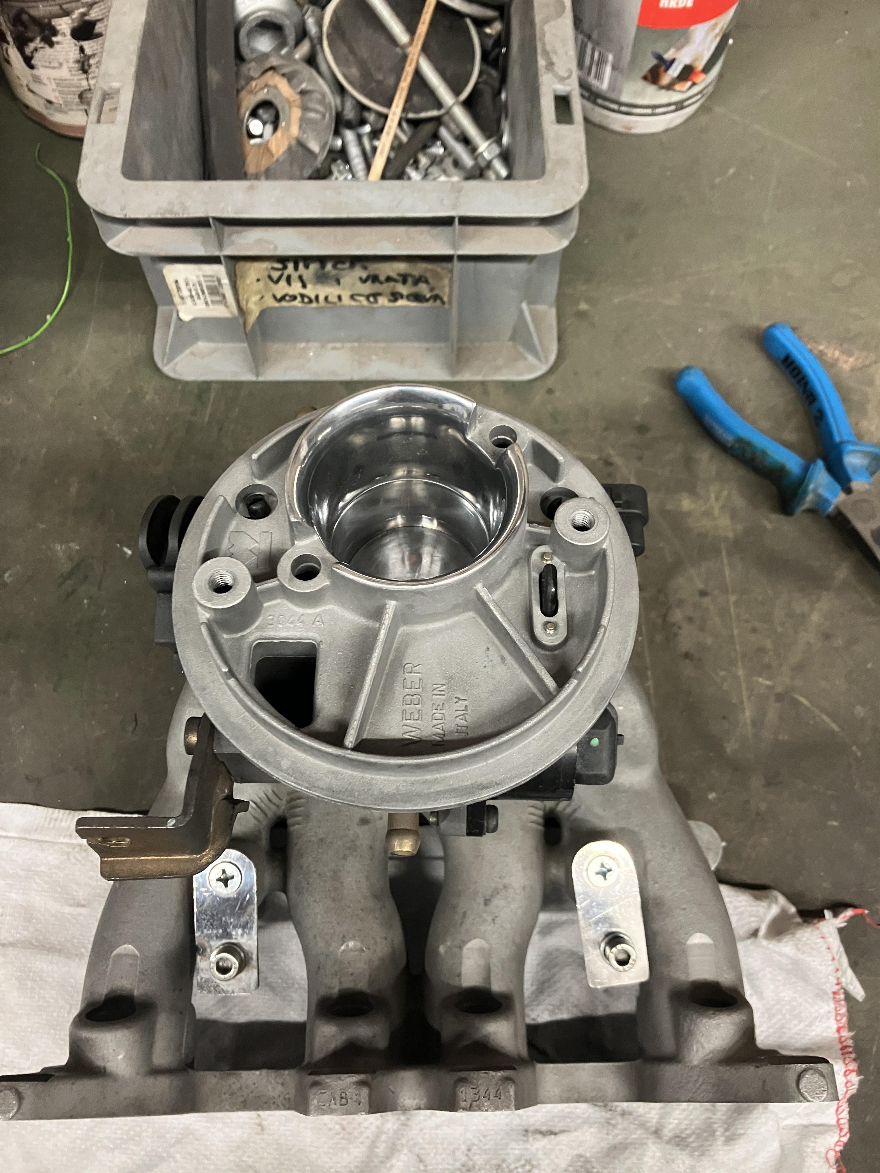

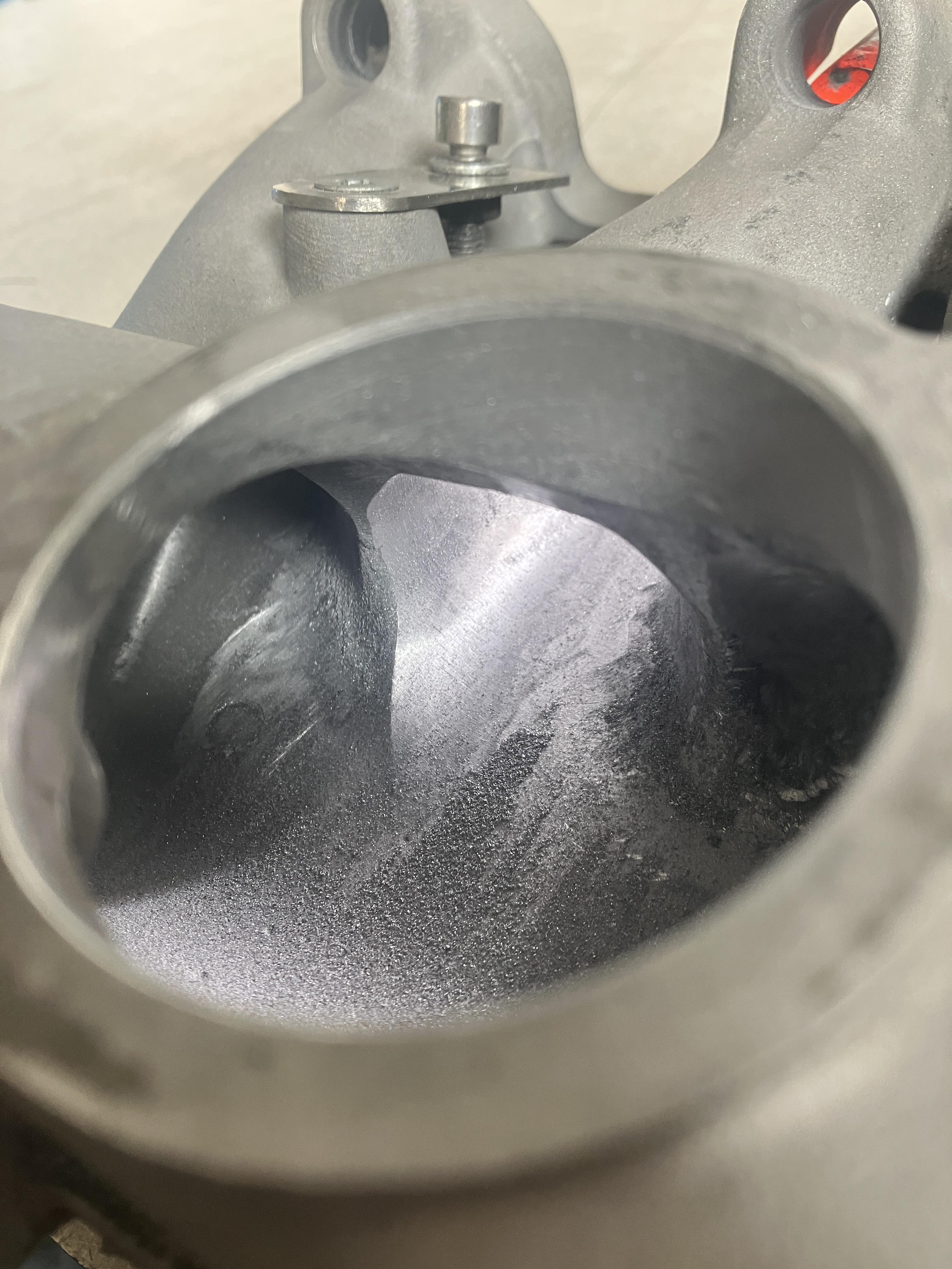

I also went inside my intake manifold again to match it better to my cylinder head - I'm afraid of removing more material although it would be good.
Eventually I will probably figure out an ITB setup again as I've bought a set from an R1 with a bit better spacing - but that's a long term idea and not important at the time.
Ordered a set of MTS Technik coilovers that arrived - really nice item I must say.
Also reworked the throttle body a bit.

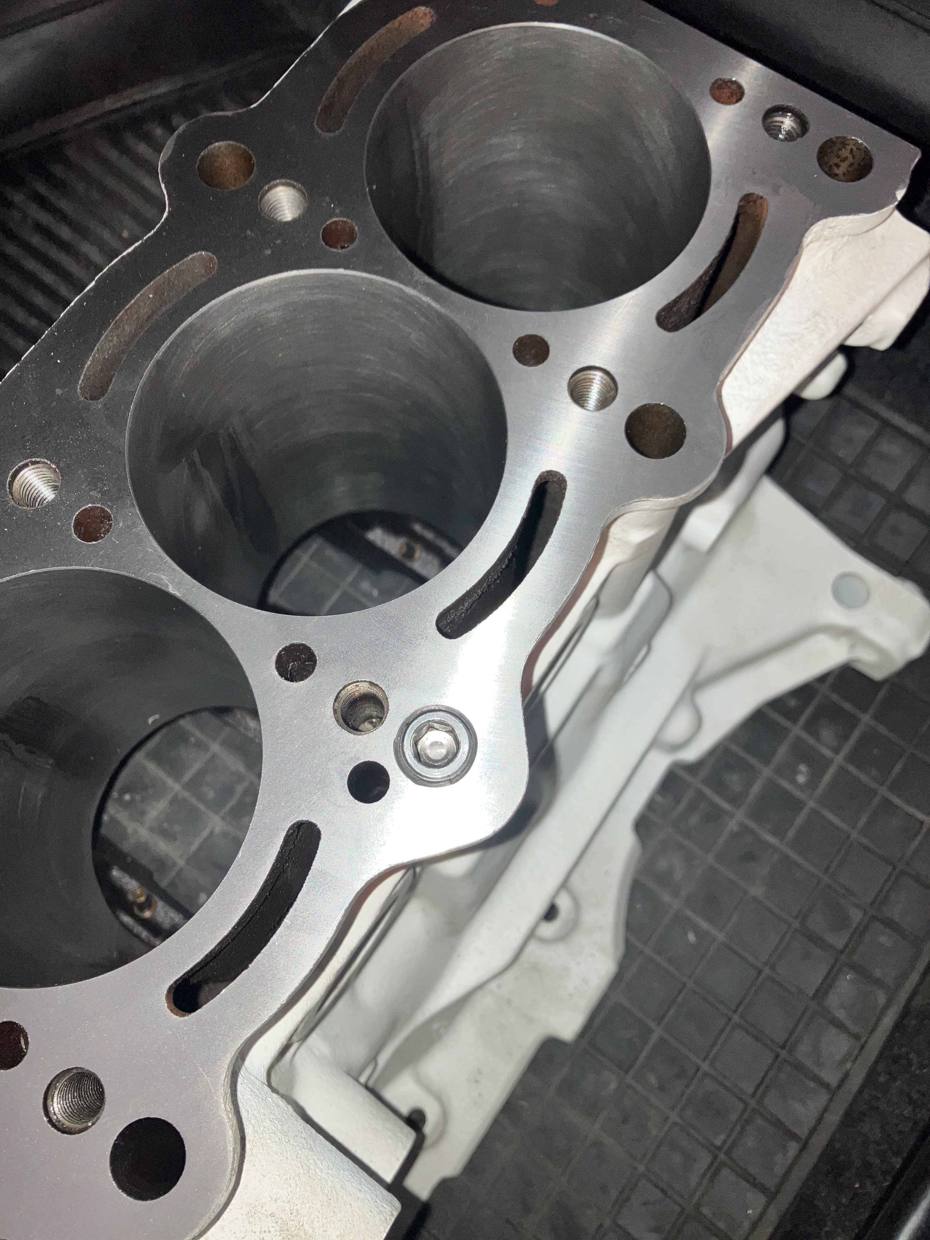

It ended up being a 72.5x84mm engine at 1387cc
T-JET bottom end with some plugs to take 8 valve head
Opel A14NET pistons milled to take T-JET rods
Rods T-JET bushed/honed to take Opel pins

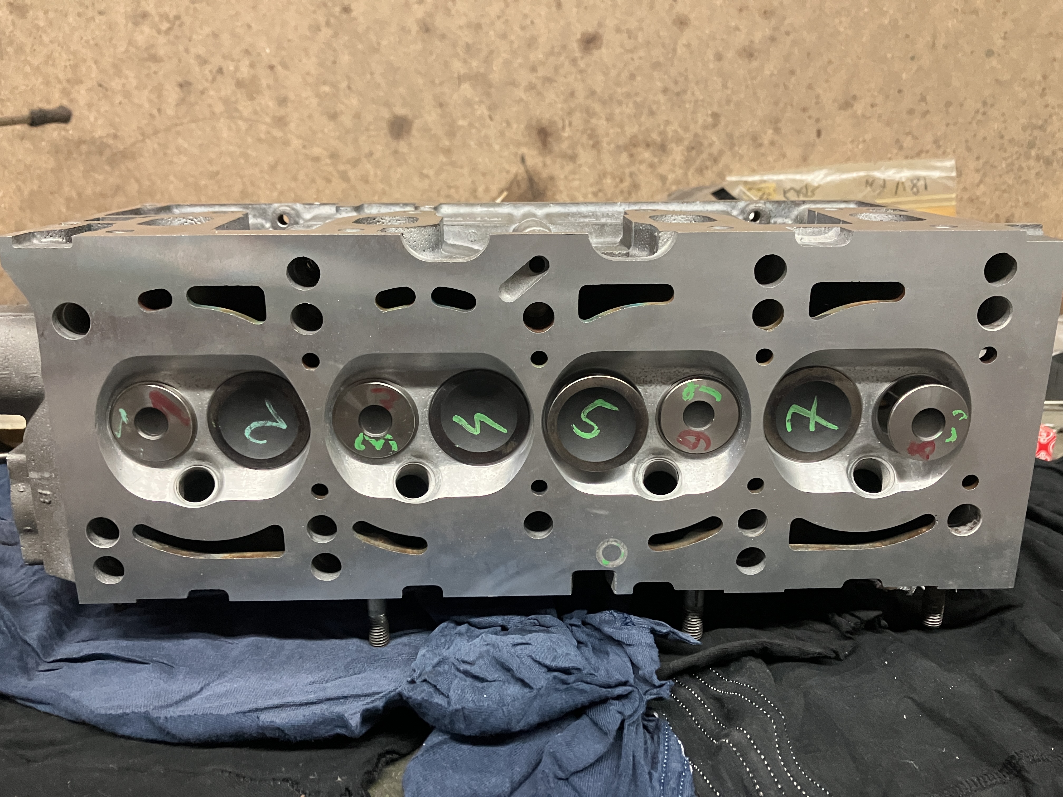

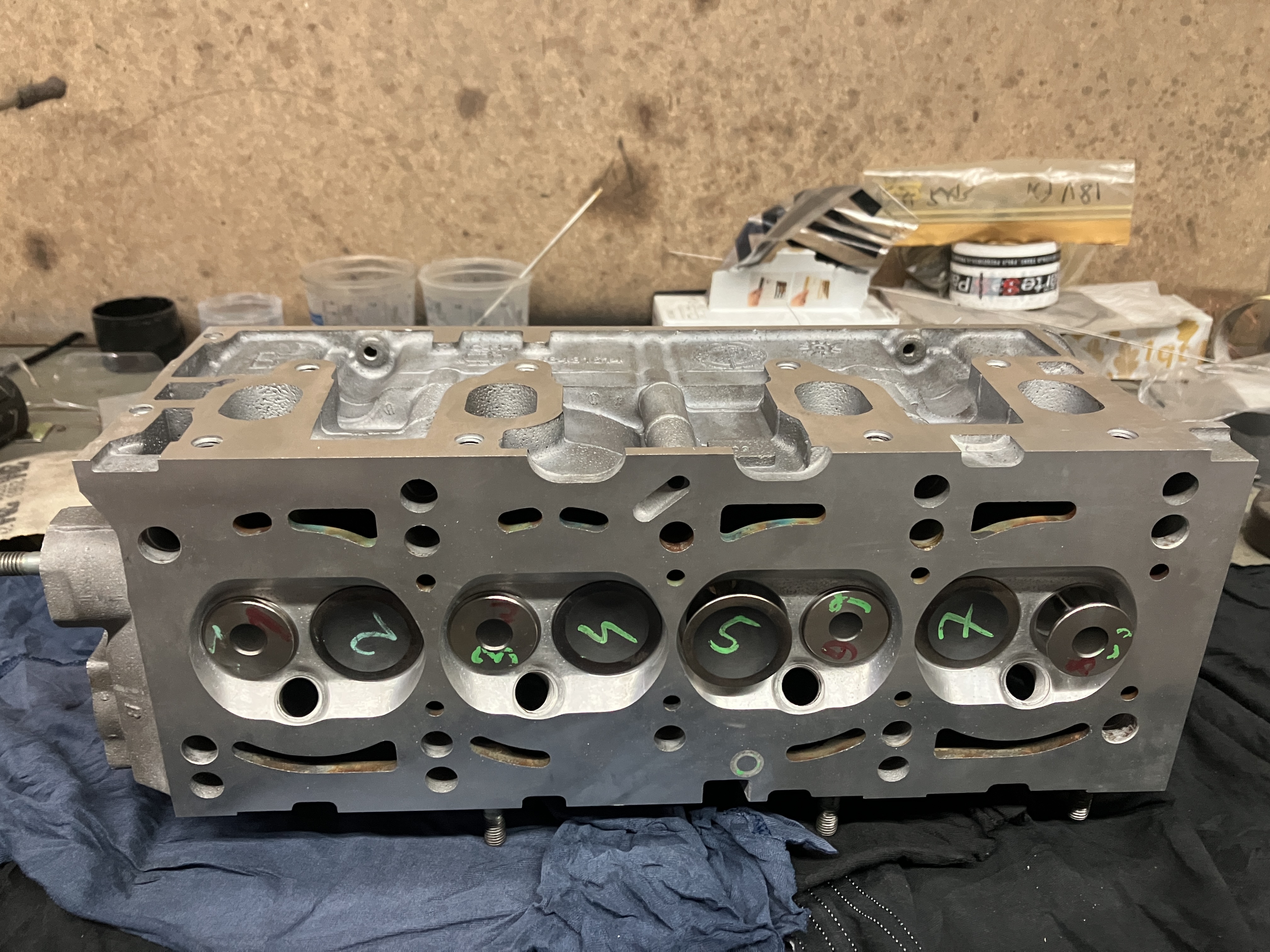

Head base 1108 Seicento SPi ported
Valves 35.5mmx6mm intake and 28.5x5mm exhaust
Catcams springs
Custom retainers

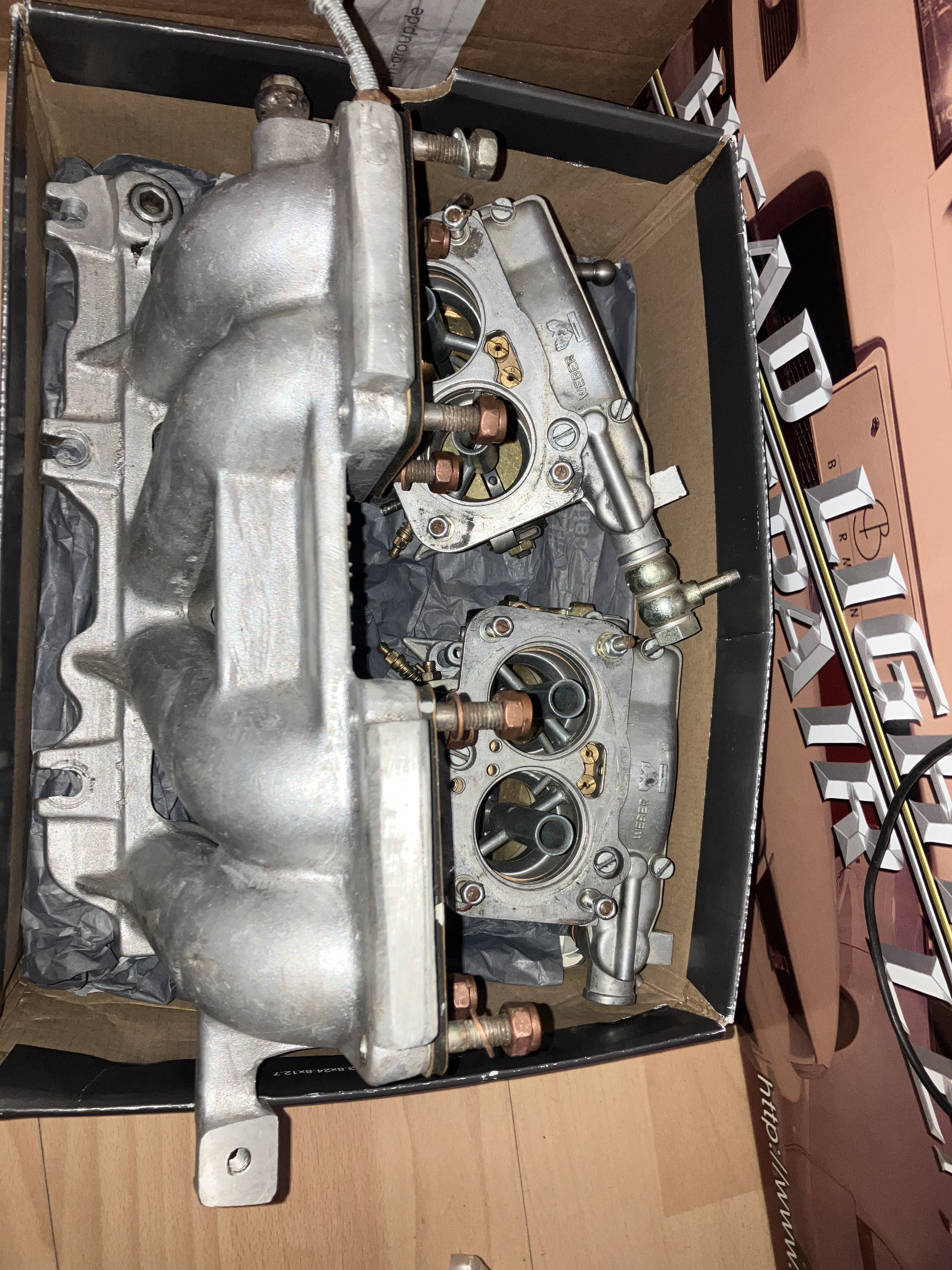

Alquati DCNF manifold ported
Weber 44DCNF carburetors
Currently running on modified distributor
Cam at the moment same old Cat Cams giving me trouble with carburetion as I have a lot of overlap ( have two more cams to try)
Exhaust still old CBR1000RR modified to suit

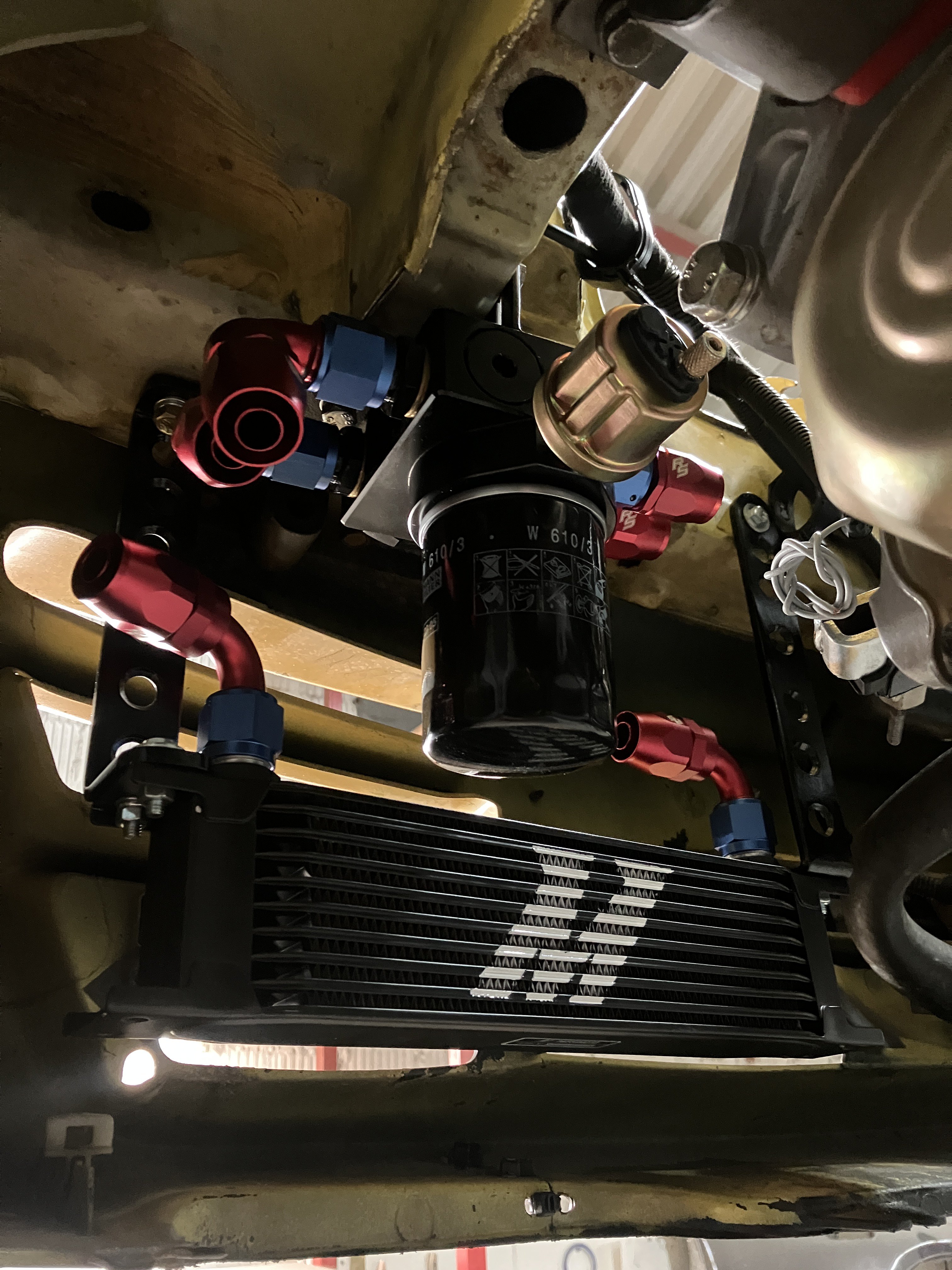

Added oil filter relocation and Oil Cooler with thermostat
Steel flywheel with ARP bolts
and stuff

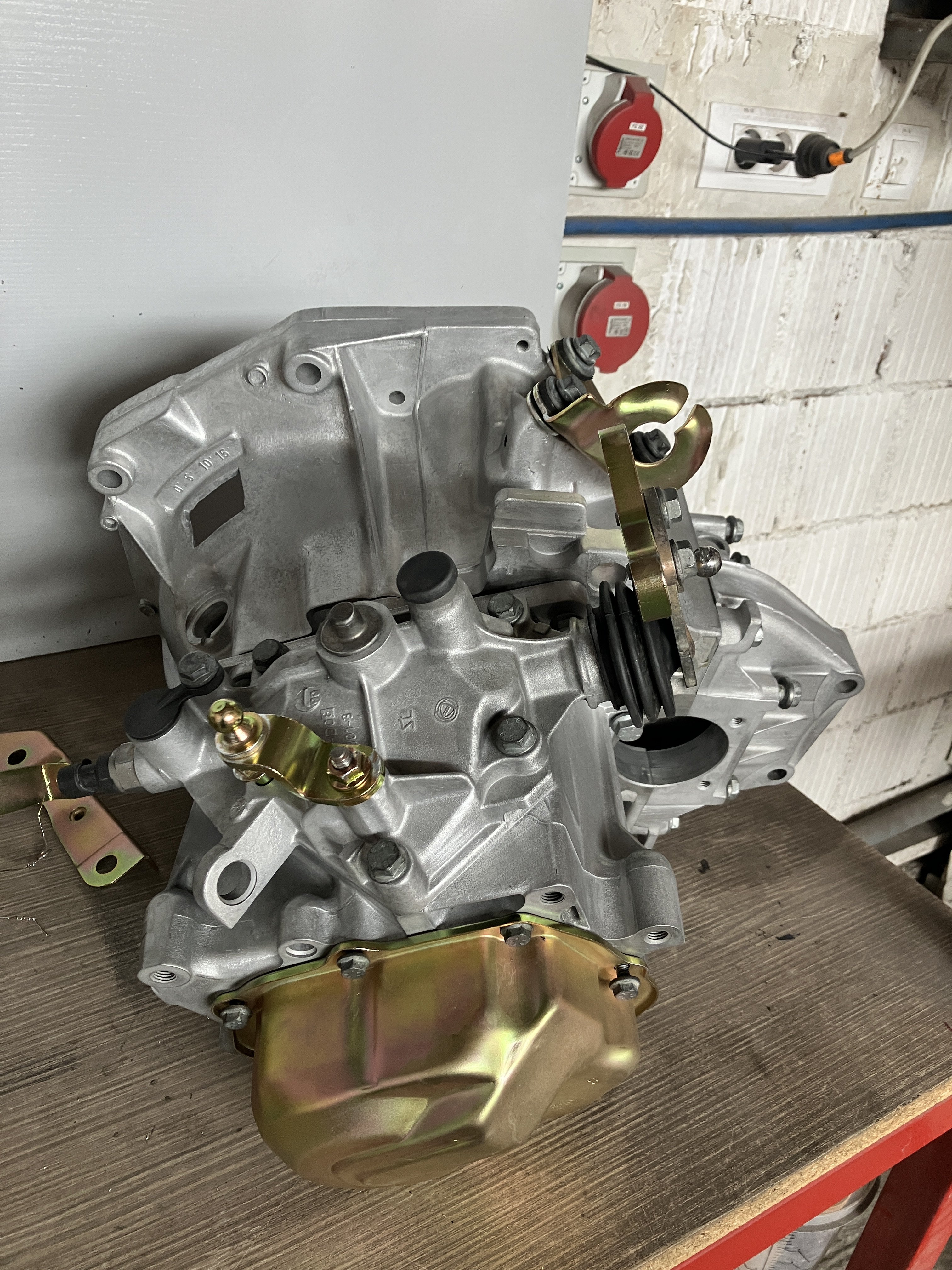

I rebuilt the box with new bearings and seals and put a longer final drive and shorter 5th gear ( Punto MK1 16V ELX) also hand sanded it to be flat so I can wash it properly vs the pitting on the casting.
Redone the complete suspension, brakes and stuff as well to get it ready for the track when there is a chance.

Carbs are staying as the manifold was a gift (rare to get those) and I also managed to find 44mm DCNF that is quite rare.
I love carburetors due to nostalgia and I had 40DCNF on my Fiat 128 when I was 18.

it’s an extra oil return that the 8v doesn’t have and would lose oil pressure from.
I had standalone ignition on marelli coils, there is no need to use ford coilpack.
So Kruno you are saying that you can use a 1.4 TJet block, with original crank, rods and pistons, block the extra oil hole and use a 1.1 head on it? Just like people do with the 1248 block and stock head?
Or the TJet is more complicated than the 1.2 block conversion
