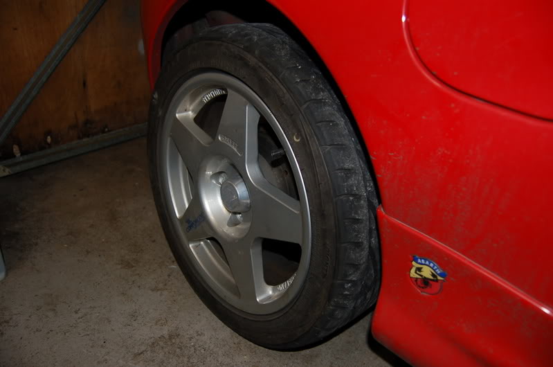

On sunday Aaron and myself went all the way over to wales to pick up these mint condition 15x6 Compomotive Mo's in fiat fitment with an offset of 19.
Also on monday Aaron put H&R 35mm springs on, keeping the standard shocks for now, as the bigger wheels need more clearance room.
We are having a few issues with the rears, so arch rolling will be needed in due course.

Wow.. what a project!
How are you planning on stopping this wee beastie? On 15's you have the option of anything upto and including Coupe 16VT brakes!
Waiting on delivery of a full set of front and rear callipers from a Marea 155 estate that was getting broken on eBay, got them including delivery for a great price. Fiat models do lots of part sharing so I believe its same callipers as Punto GT as shares the same part numbers on the discs 257mm fronts vented, 240mm solid rears which so happen to be Seicento fronts, again same part number, don't you just love it when Fiat make it easy by part sharing, don't even need to buy discs for back as the fronts were new in the summer :D
