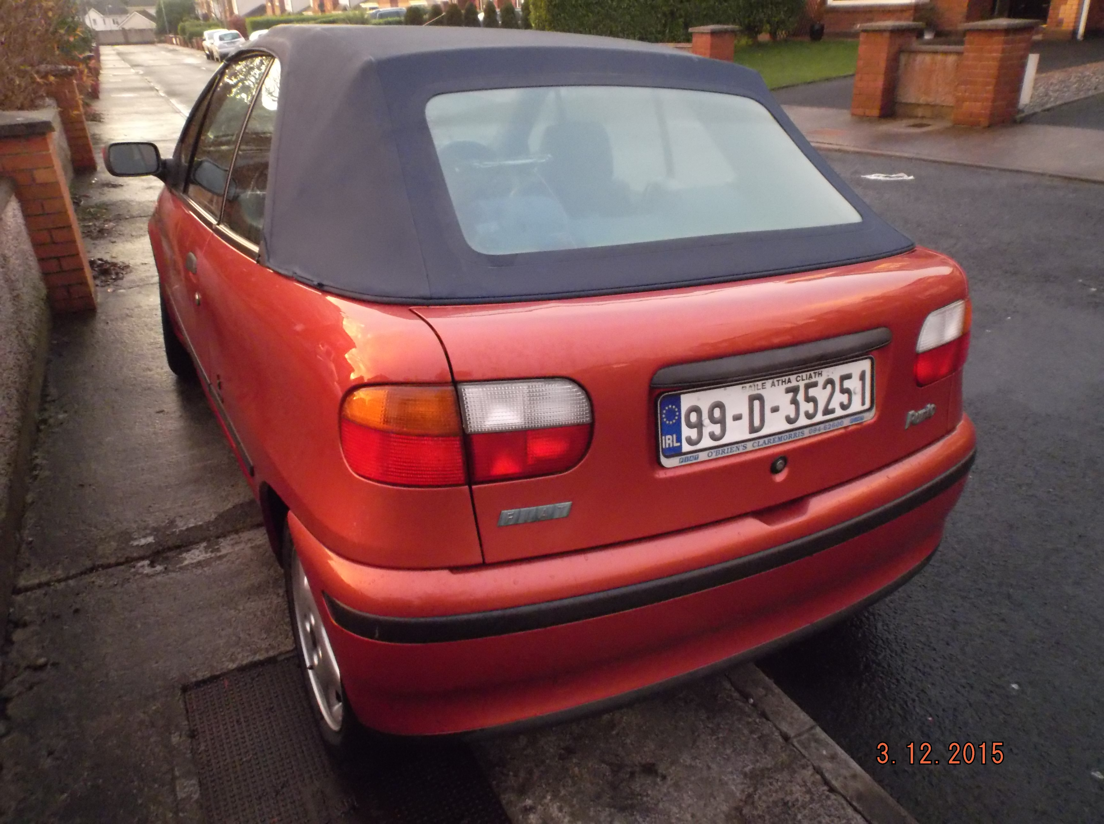

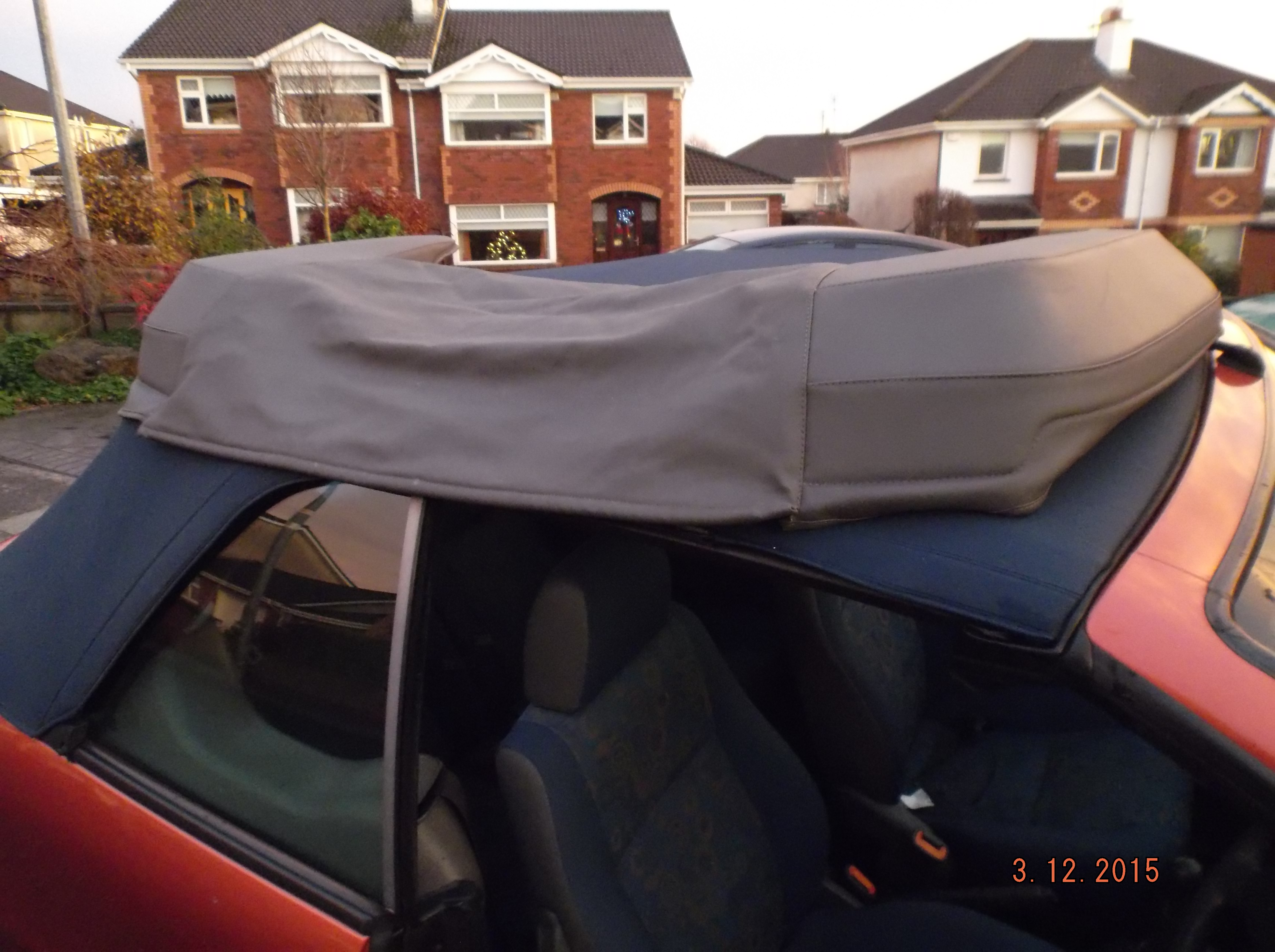

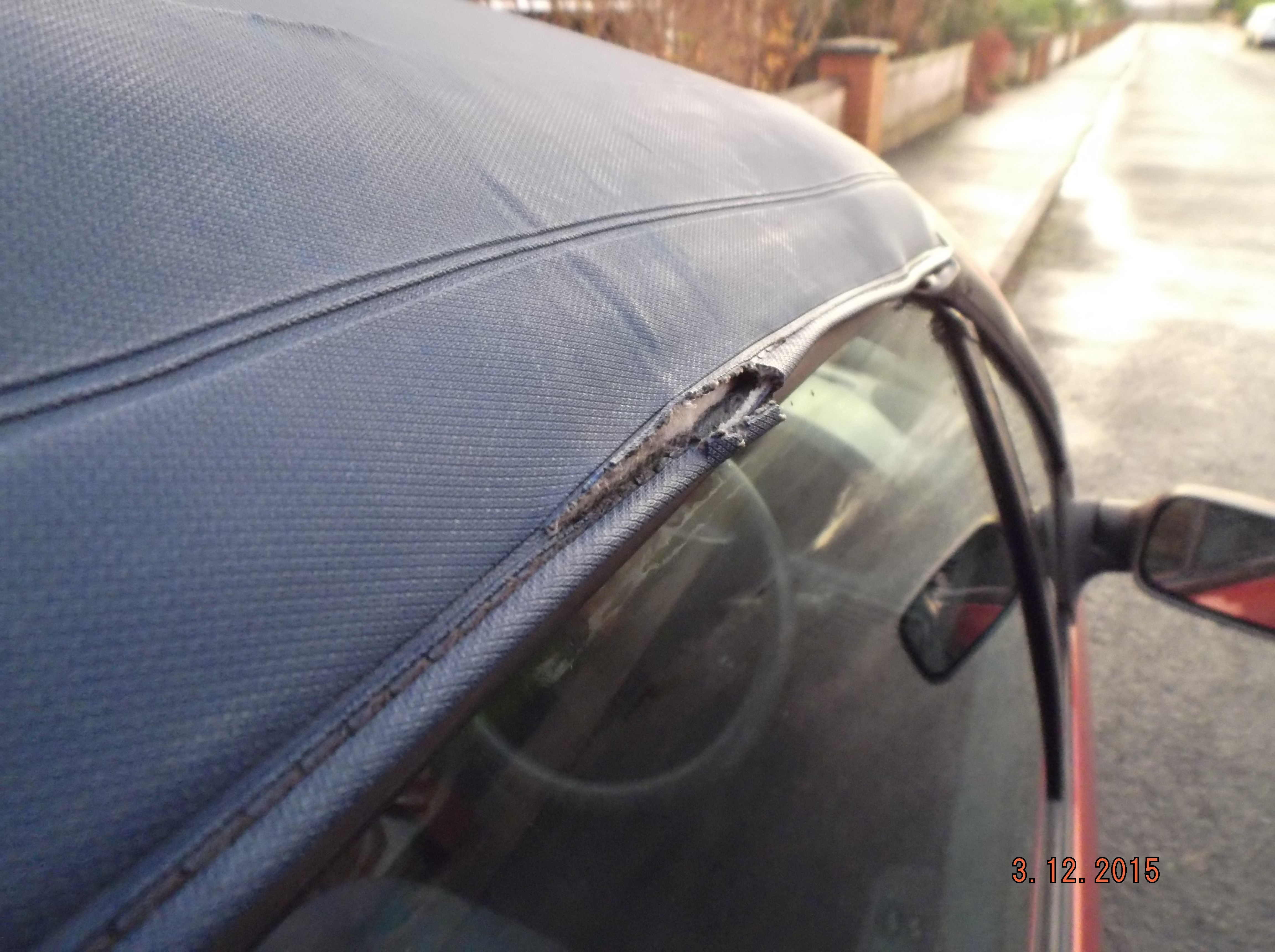

Bought it today. Nice little car. Few marks but nothing major. Even has original tonneau cover. 65K Mls Needs clutch and exhaust.
Alright for €630 or £455! Now the work begins. Need new back screen and a repair to the edge of the roof material, looks like it was caught in something. All ideas welcome,

The owners handbook should have a supplement at the back for the Cabrio. The Haynes Manual does not cover the Cabrio, but the Porter manual does. The chafing to your roof looks like the typical cabrio roof problem which also causes splits above where yours is chafed. This is caused by the position of the central roof bar when the roof is lowered. You will find full details on this thread: https://www.fiatforum.com/punto/351131-punto-cabrio-roof-issue.html
If yours is a manual roof, it shouldn't cause you any inconvenience to ensure it opens correctly. The problem comes with powered roofs where you have to stop halfway and position the bar manually.

Thanks for the input, I knew the Haynes didn't cover it, I didn't get any book with it! Mine is a manual roof, the damage is only on the drivers side. The post about the roof bar is very interesting. That is probably my issue. have it in a shed at the moment to dry the roof before I take it to be repaired, new back screen and the side! Any idea about thee two handles on the sides, one is broken and the other doesn't seem to do anything!
