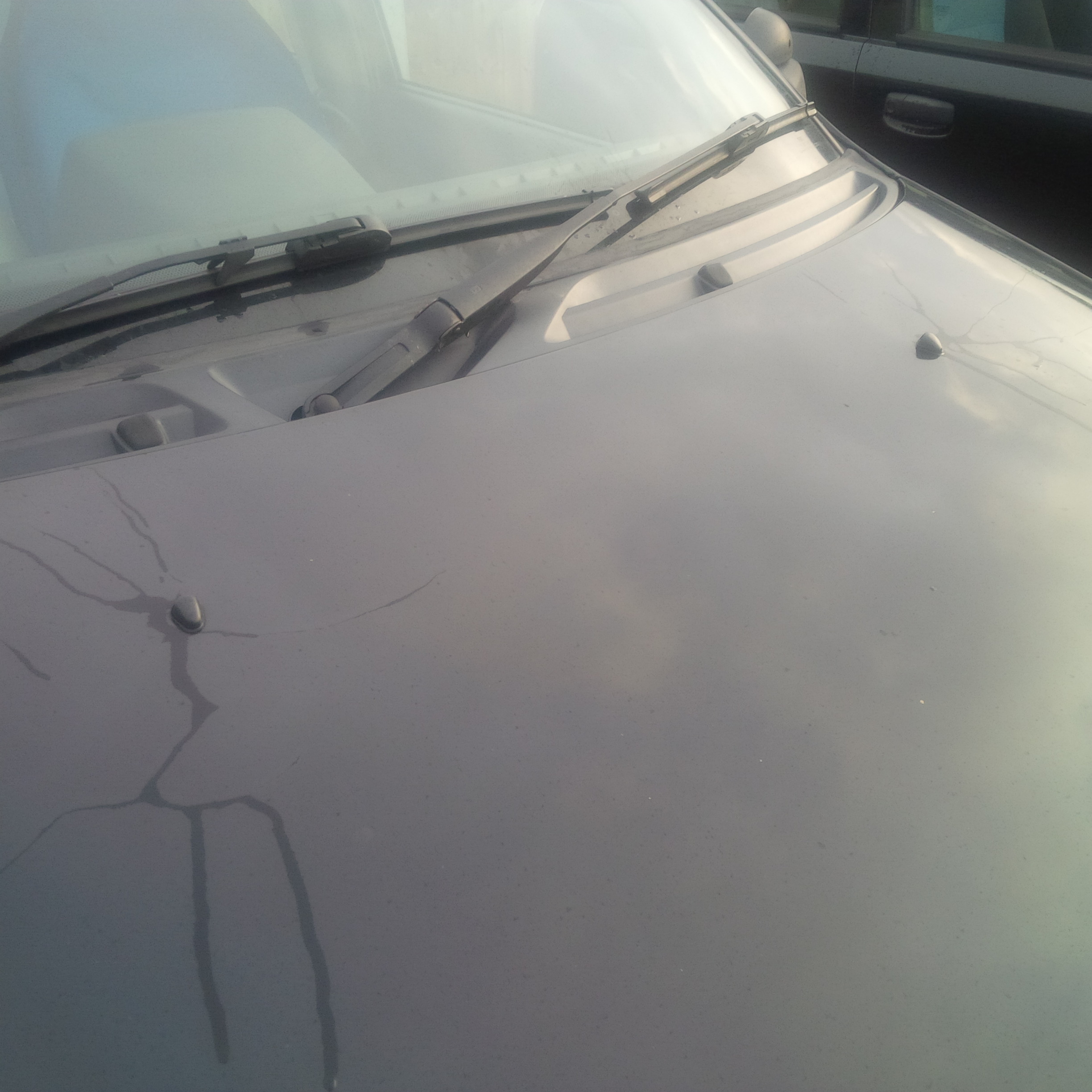

I have a 2009 Panda Multijet and I got tired of the wiper arms getting in the way of the washer jets, so I relocated the jets to the bonnet.
I drilled 2 holes and fitted standard jets with nuts to hold them in place, I now have clean a windscreen without without the wiper arms getting in the way, and a bonus in that in cold weather the engine keeps the pipes and the jets warm and ice free.
