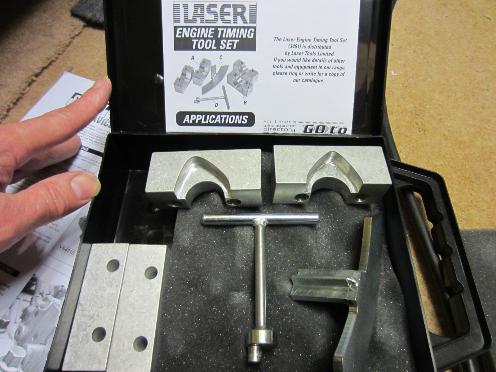

It is essential to use the proper timing tool (camshaft lobe locks) as this will ensure the timing is correct and in doing so correct any possible timing errors that may have been introduced the last time the belt was replaced. If previous belt replacements had not used the proper timing tools then it is almost certain the timing is not spot on.
With regards to the camshaft pulley being loosened then the chances are you will not have to do this but it is always better to do so. I was prepared and ready to loosen mine when I did the belt change but found that 1) the nut was so tight I bent my sprocket locking tool and 2) there was no tooth/notch misalignment at all anyway. Was a perfect snug and tight fit.
It is essential you lock the crank flywheel down. Also use the TDC marking in the top of the gearbox bell housing window as these are far more accurate due to the diameter involved.

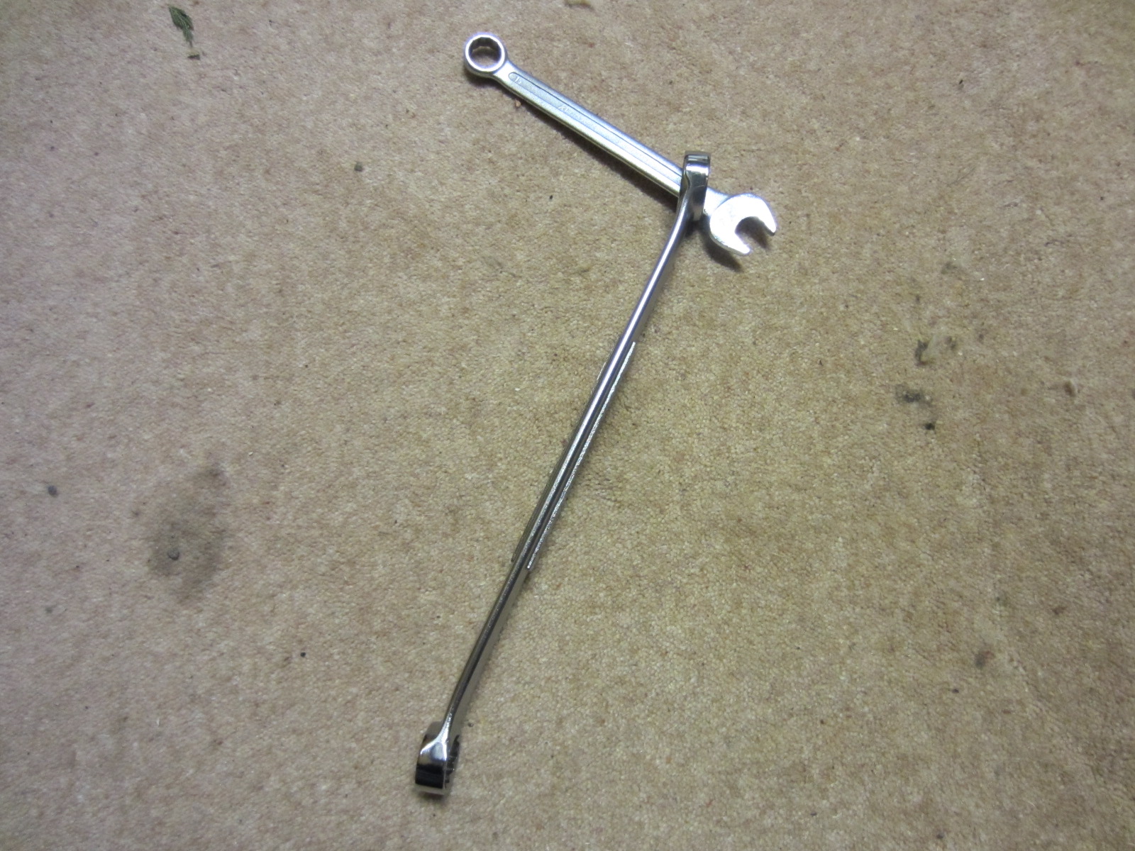

Page 19. Auxiliary belt removal.
The tensioner nut is 15mm. To increase the leverage of a regular spanner, I slipped a much larger spanner over it (see 1st photo).

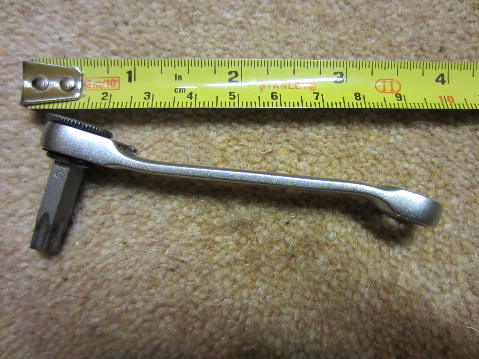

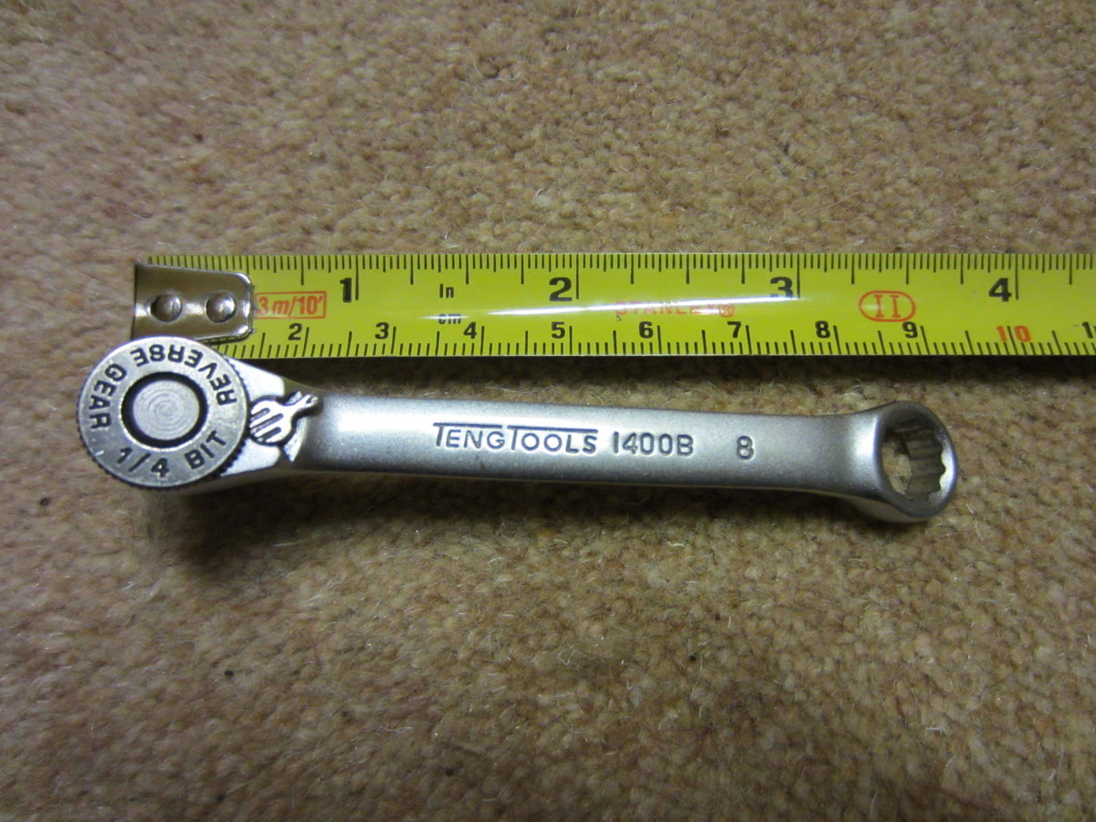

The 3 lower & 3 upper screws are Ribe keys. You can use a Torx T40 instead. The middle 2 screws are 5mm Allen keys. I removed the header tank fixings to give better access to the top 3 cover fixings or you could remove the header tank altogether. I used a mini ratchet with T40 Torx bit (see photos 2&3). The left hand upper screw is exceptionally difficult to get to!!

Page 20. TDC and cam locking
Before locking the cams I removed the auxiliary drive pulley from the crankshaft (page 22). I locked the crankshaft by wedging a prybar into the flywheel through the lower cover (page 22, pic 1)
When finding TDC the cam lobes on cylinder No1 inlet shaft should be facing towards the rear of the car.

Page 21. TDC and cam locking.
To turn engine over I used a socket, 14" extension to clear bodywork and a 16" knuckle bar on the crankshaft nut. A piece of dowel in cylinder No1 spark plug hole is sufficient to judge TDC. Cam locking tools should fit the appropriate lobes easily. If not, "tweak" the crank until they do. With the cams locked I Tipex marked the flywheel through the lower inspection cover. I didn't bother with the top inspection cover because its difficult to get at and see the marks. The lower cover is easy to see when working in the wheel arch area.
