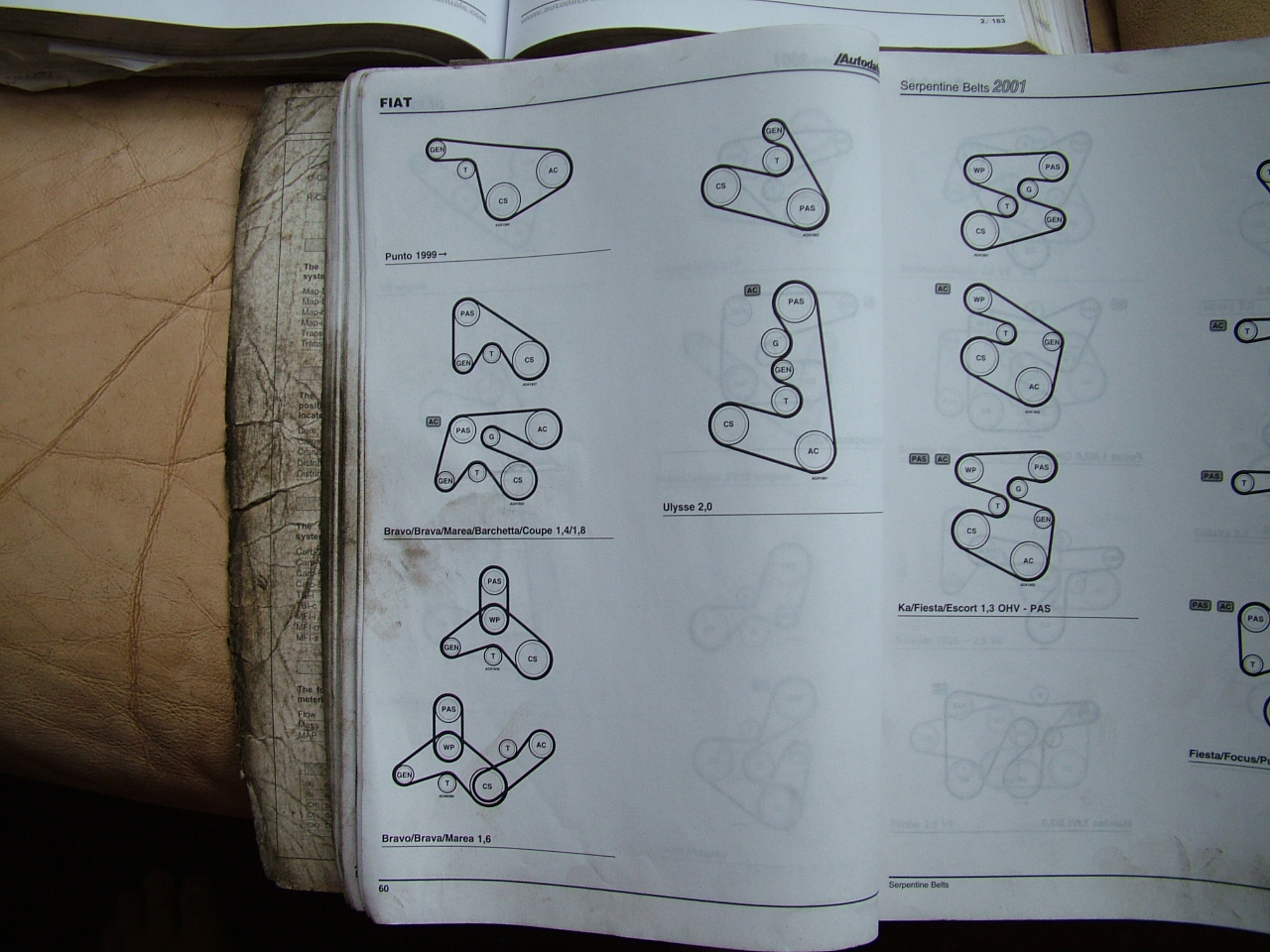

Others on Forum may have more specific advice.
All I can find on Fiat belts is in photos from my technical manuals, but not specific to your Barchetta.
I would say if you are unsure even after inspecting it then get a experienced mechanic to verify before cutting anything off, as it is too late then if wrong. Usually if it is a separate belt you will see the two separate lines they take, one in front of the other. Obviously the crankshaft pulley if visible will be wider to handle two drive belts if so as most newer vehicles just use one "serpentine " belt.

Looking the the workshop manual then it appears to be a single belt that drives the alternator, power steering pump and aircon compressor.
It is also a serpentine belt and when these start to fail they normally shred stands, runs of cord, that can get into the cam belt area. You need to get a new belt ASAP.
