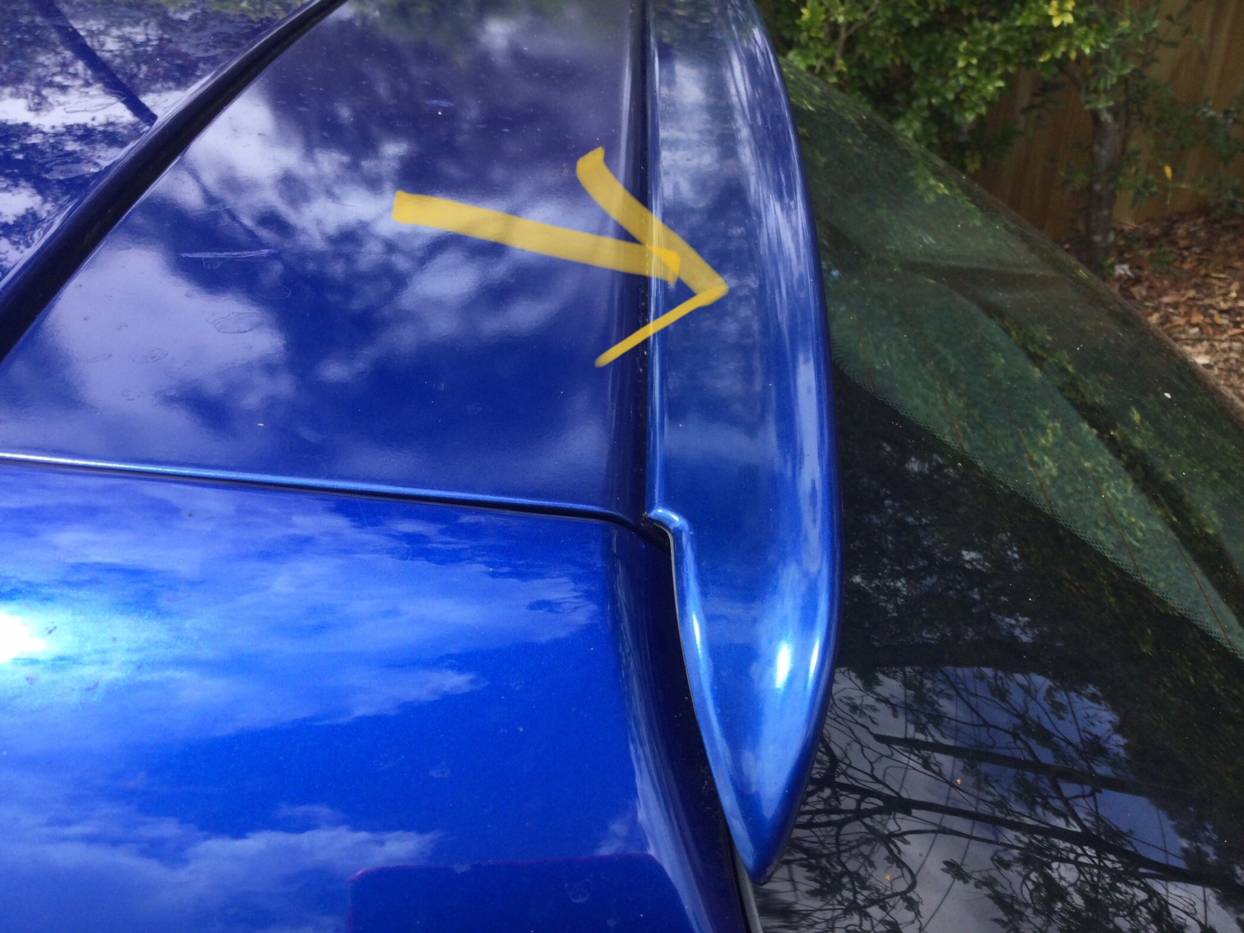

Anyone have any knowledge of removal please. Cannot find anything. Dealers no help. IMG_1576.JPG
