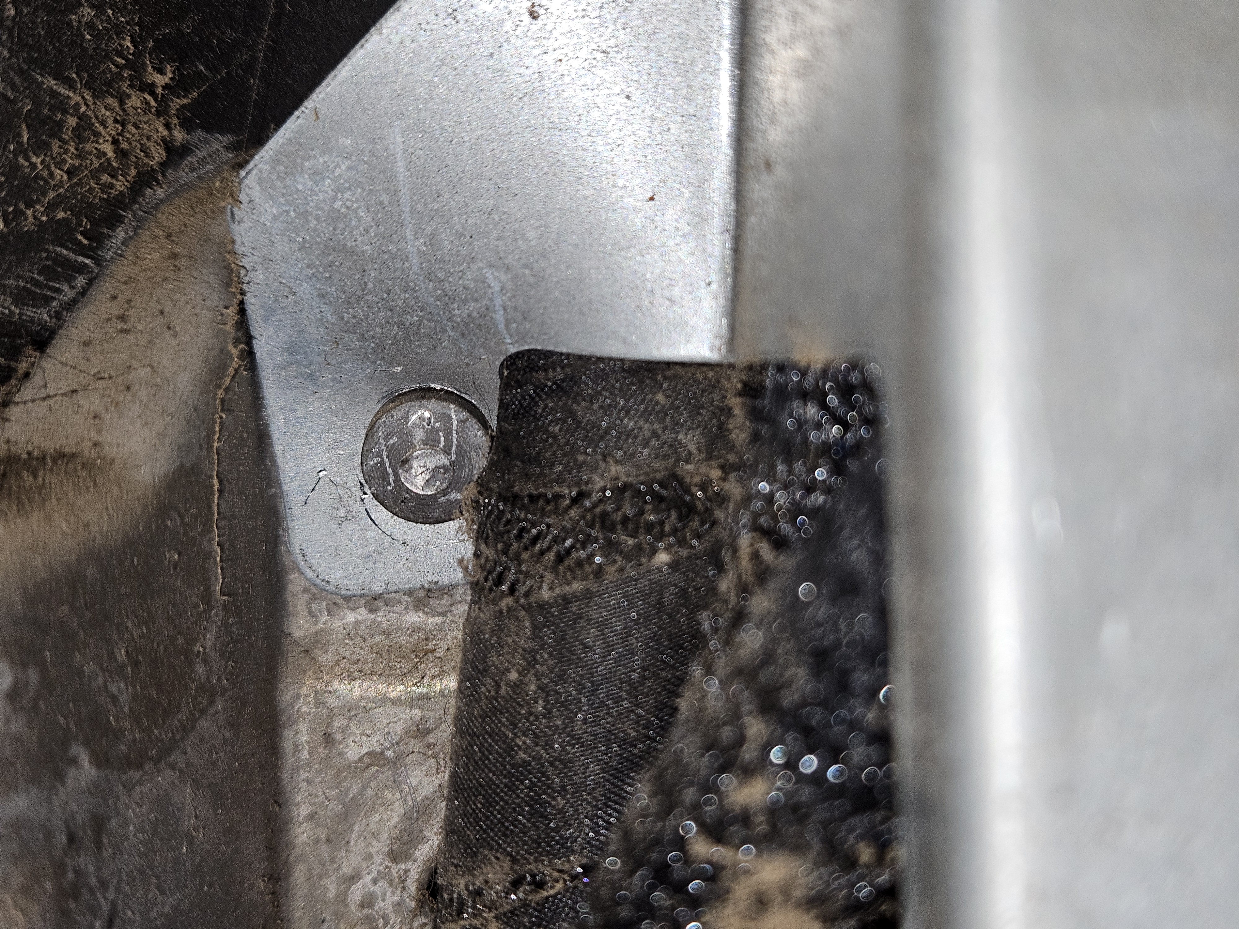

P Panther96 Member Joined Mar 17, 2016 Messages 36 Points 67 Feb 24, 2024 #1 I'm trying to remove the fuse box from a 2010 bravo so that I can access the BCM however it has a steel cover over it. Any idea how to remove this, it seems to be almost riveted on.
OP OP P Panther96 Member Joined Mar 17, 2016 Messages 36 Points 67 Feb 28, 2024 #2 Turns out these are the bolts where the heads shear off at a certain point, had to drill them out and then the fuse box and BCM were easy to remove.
