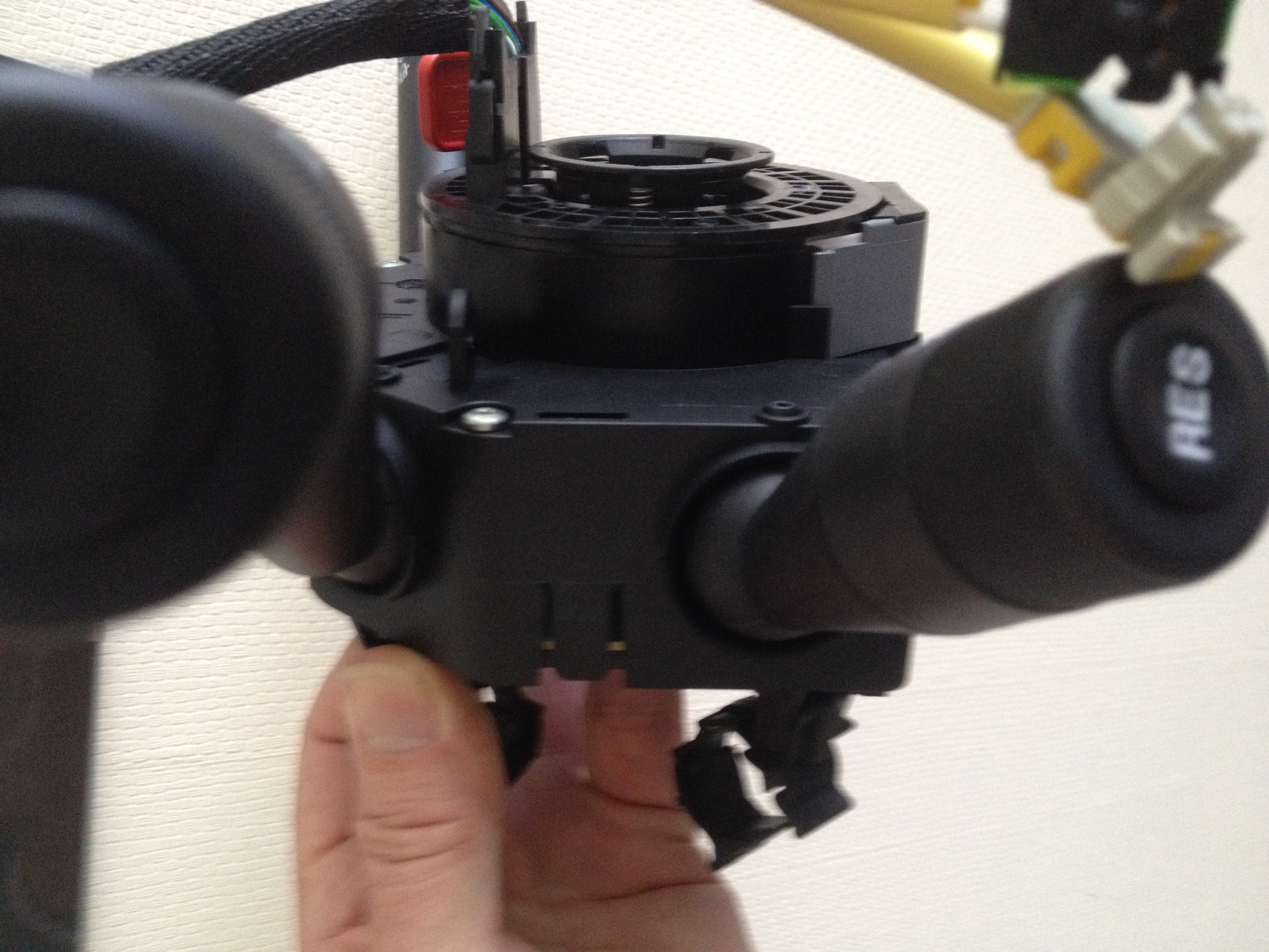

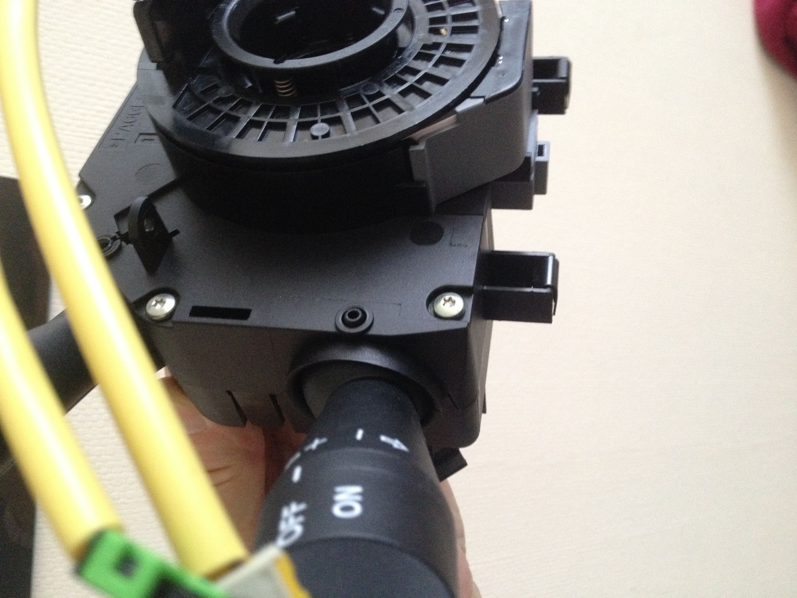

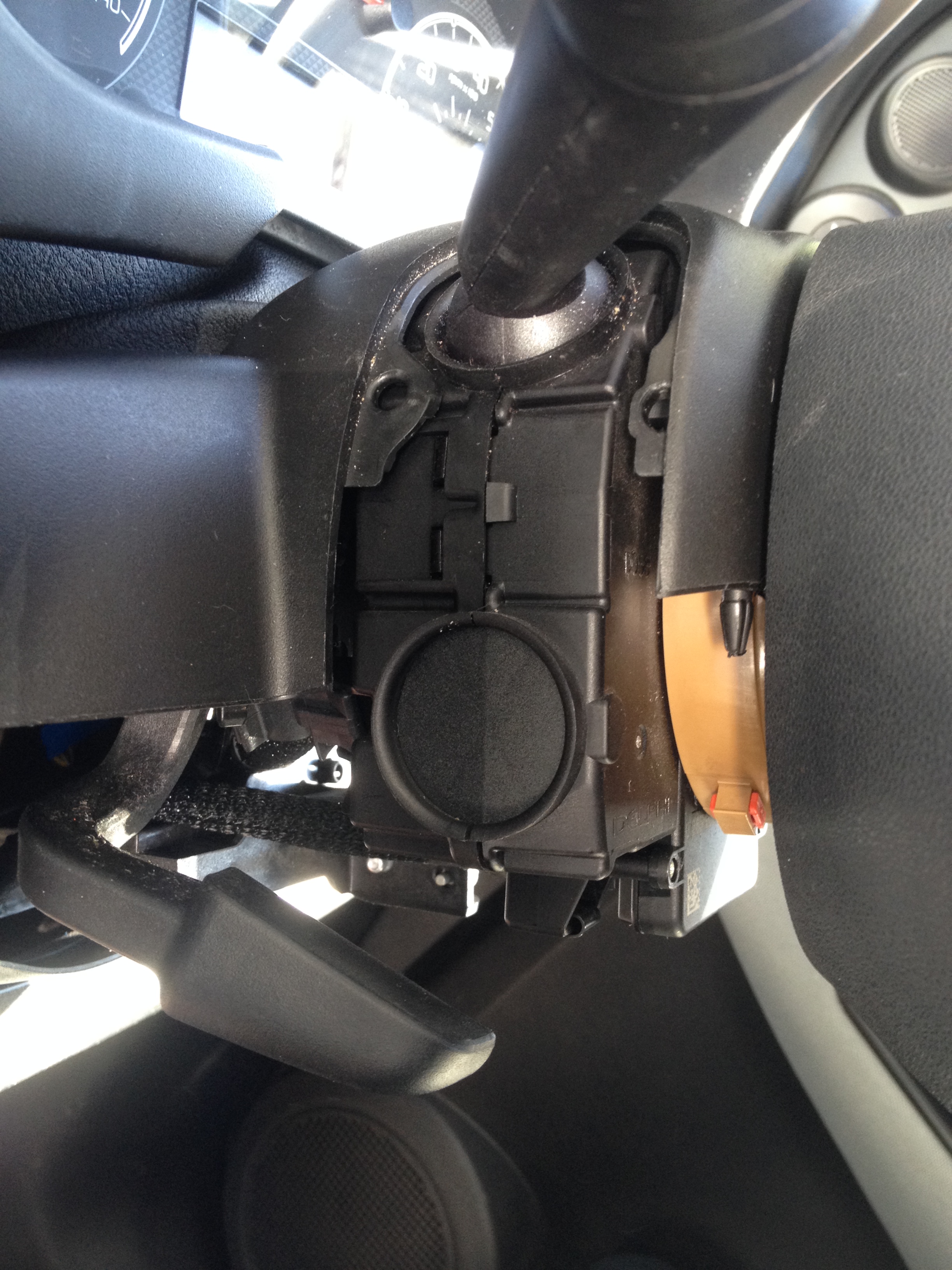

After a couple of hours+ spent having fun with steering wheel and wires and socket sets all over my lap/the floor/dashboard etc. I discover to my disbelief and chagrin that my 2012 Qubo is completely bereft of a spare connector to make beautiful contact with the third connector on the new-to-be-fitted squib unit so painstakingly sourced... :mad: Grrr.
Any road up, to give some info (to you Steve in particular), here's a pic of the Alfa unit I think you'll have bought (an Alfa 147 stalk).
Its mount is quite different from the Fiorino setup as the blanking block where the cruise stalk goes is a block, not a slide-in space and it's a different shape too. Here's the Qubo in-situ unit followed by a similar side view of the new unit.

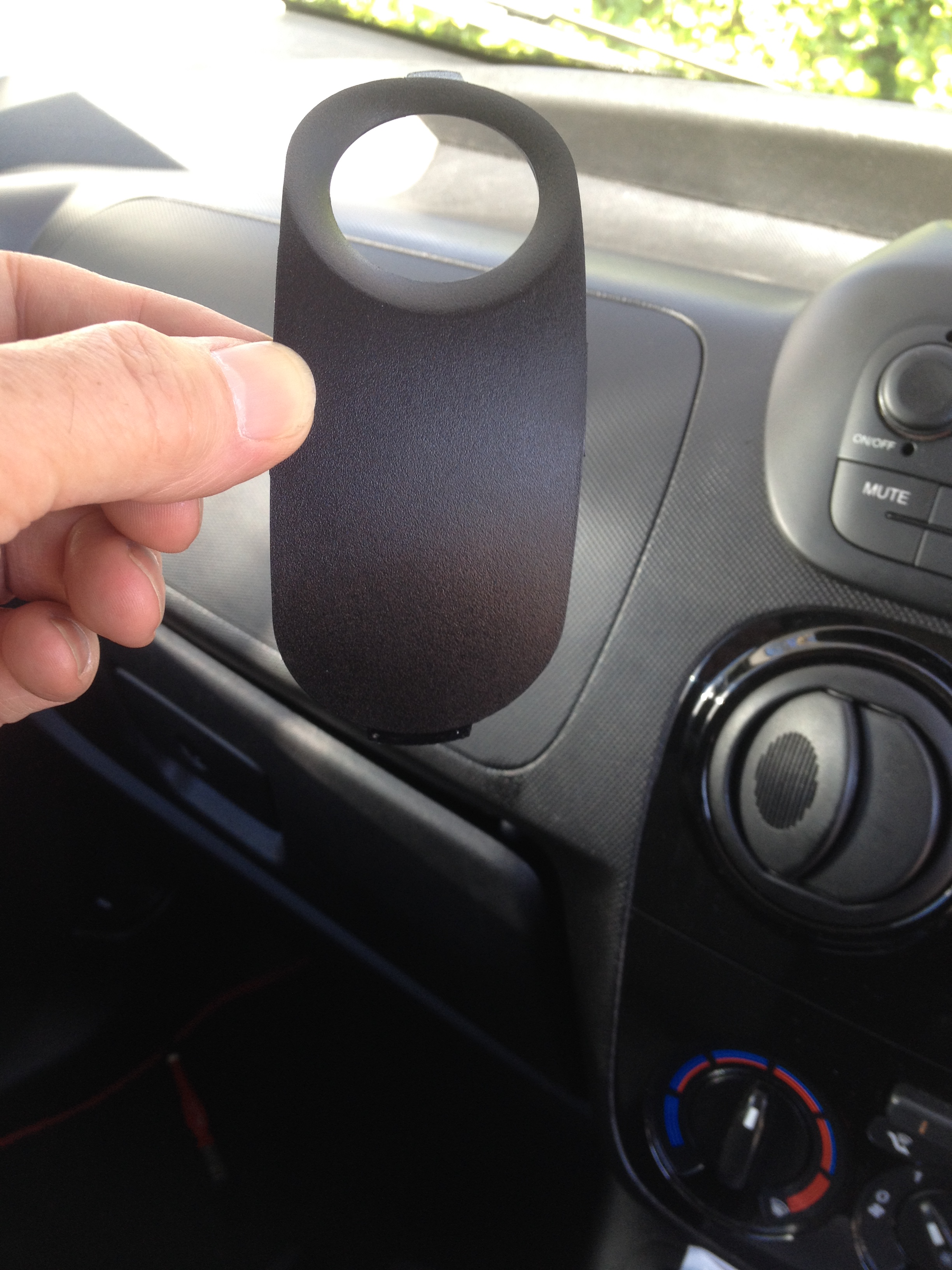

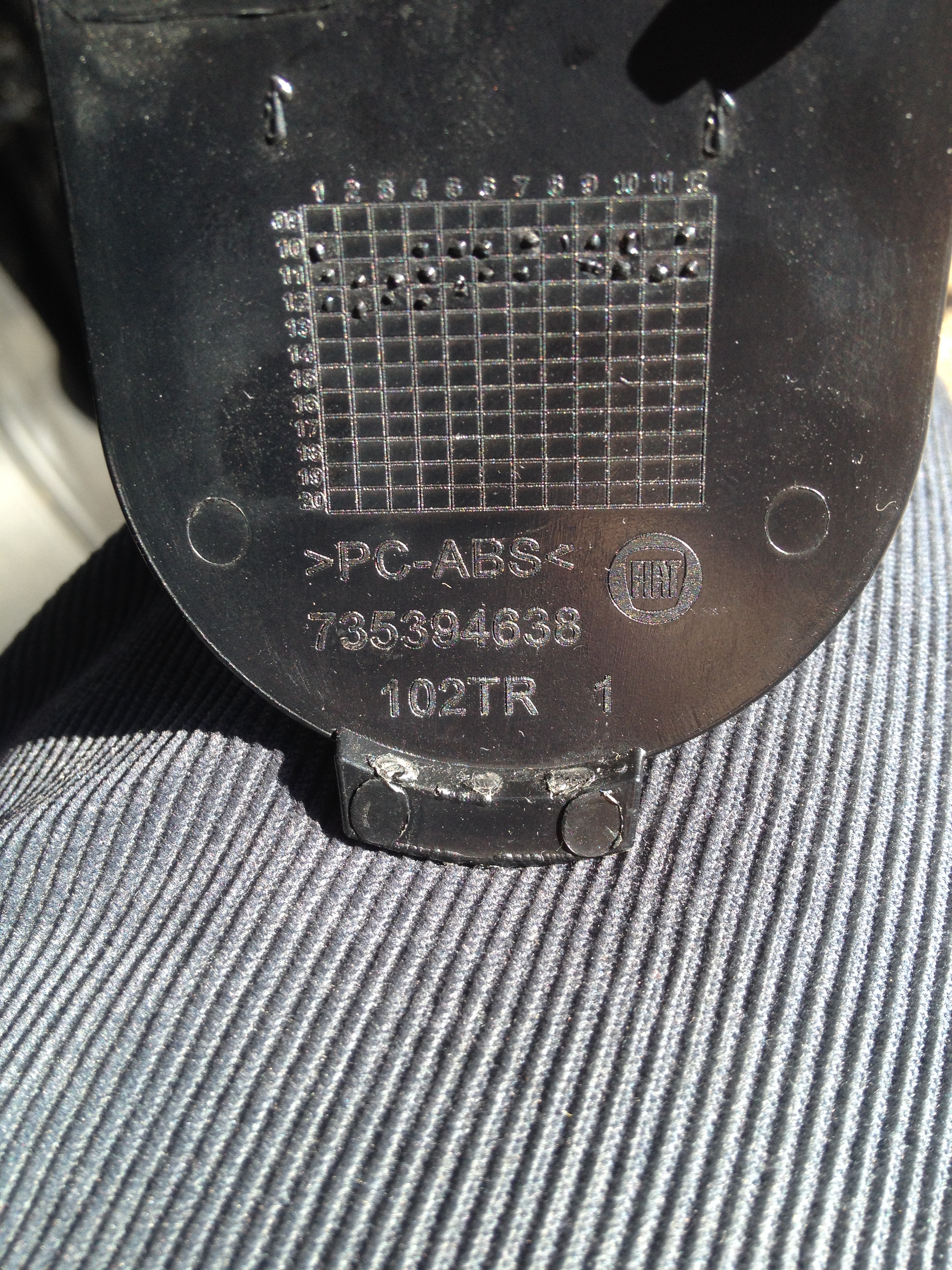

This is the only shroud piece that will need changing (a bit of research hasn't yet turned up the two-hole version) so a bit of care with the knife or a drill and filing with a half round file might do the biz although it won't have the countersink like the upper stalk.
The Grande Punto dissemblement on this forum says you need a 45mm or 50mm Torx socket to take the wheel off, mine was an ordinary 15/16" nut. As advised elsewhere, only undo the nut so far and then pull the wheel towards you to ensure it's free to slide off the splines - the nut staying on prevents you getting a broken nose :) - then you can take the nut off and slide the wheel off and disconnect the wires. I put a vertical pencil line in the wheel boss, the nut and the centre spigot too for re-alignment on re-assembly.

I'm still attempting to see if this CC stalk unit (complete 3-stalk assy.) I have will fit the new Qubo I got a few weeks ago.
Luigi, you mention a 'spare' connector but when I take the shroud bottom off and feel around, there is only the loom going to the stalk unit and that has two connectors, a lower and an upper and on my loom there's no floating spare.

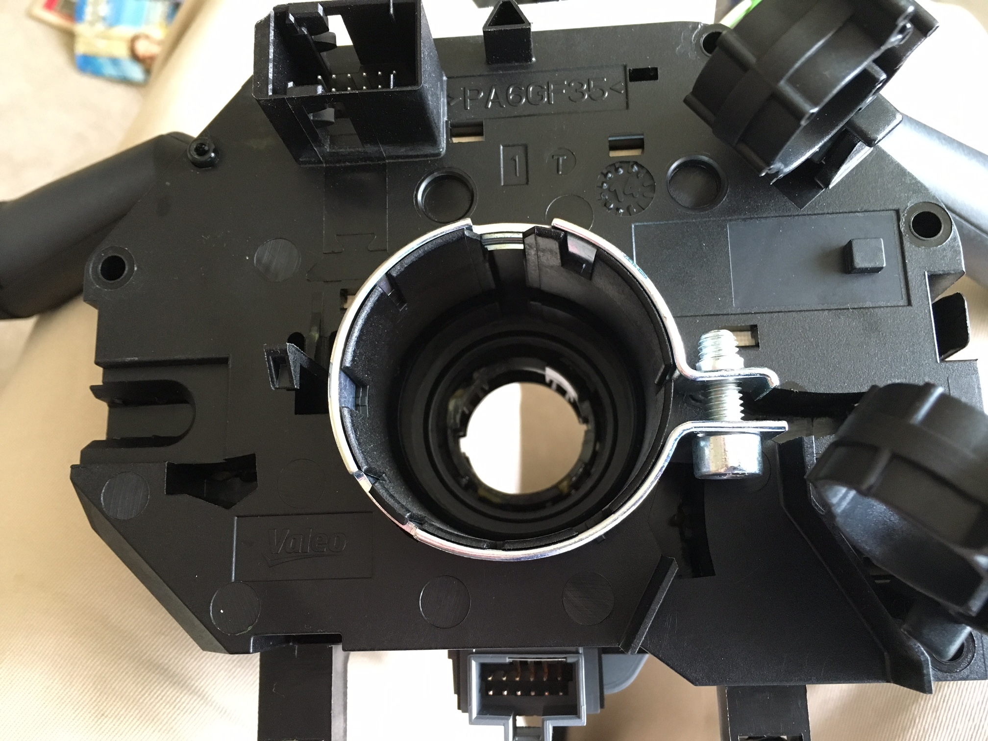

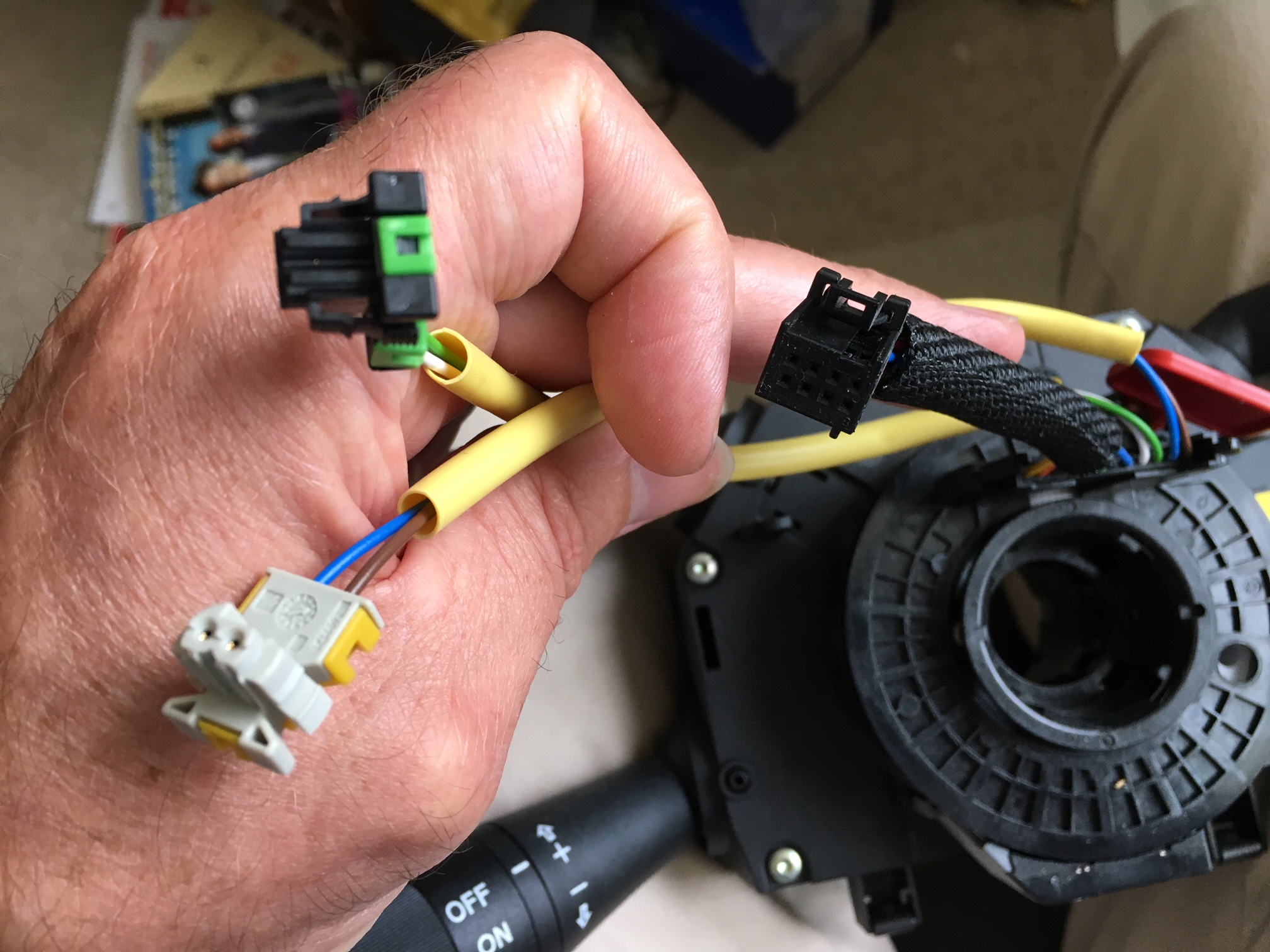

SO I looked at the rear of the 3-stalk unit I have and it looks like this,IMG_5890.JPGshowing ONLY two connectors on the rear
IMG_5891.JPGThe three front ones...
being the Airbag and steering wheel controls which plug into ports under the airbag unit when you've learned the magic of how to pop that off..
From this I deduce that the bottom connector is probably the one that has extra contacts for the CC stalk so I doubt looking at the new stalk that there is a connector for a flying lead which if unused would be taped back to the loom.
Can anyone who has a CC stalk confirm this? I know the insert where the indicators go needs a new piece (has a cutout for the extra stalk) but that's all after doing all the wheel dismantling.
