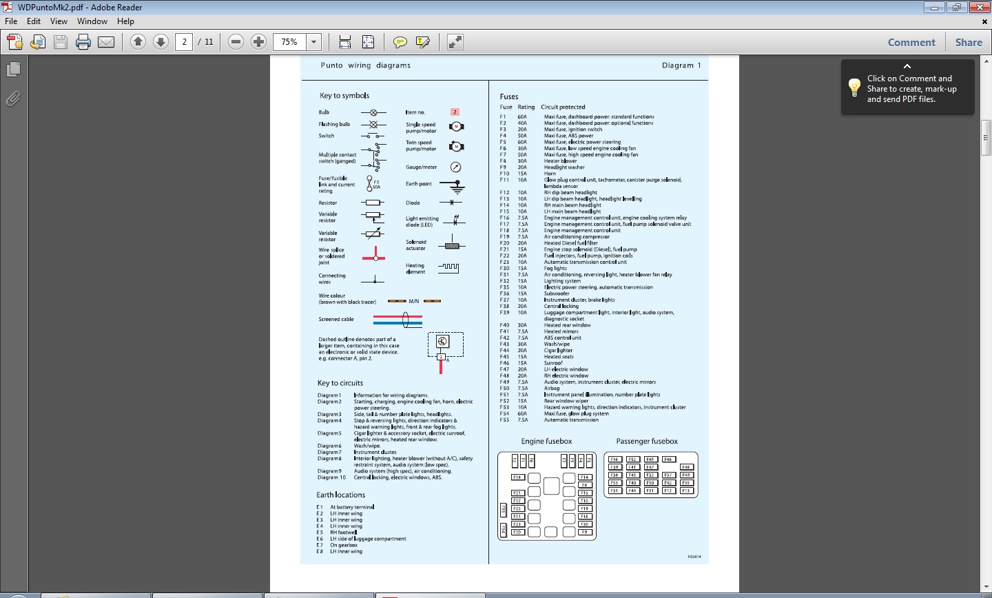

manual attached

F5 maxi and f35 on that manual
