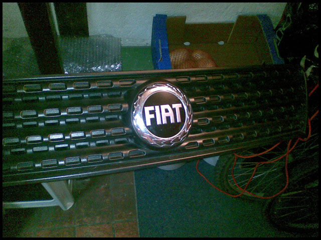

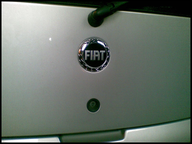

The light are going to be hard..
The bagdes, u take them of the car, pull the middle "glass" part off - its just attached with doublesided tape, then u take away the blu color and spray it with color u want and that's it :)
Does this work with mk2 badges aswel how do you take the clear plastic off? how do you get the blue bit out and do you just spray the blue bit and put it all back together?
Cheers
BTW punto's looking good mate i like
Re: Punto HGT mk2b 1.8 16V
Cheers
It should work with all the badges, usualy u have a small hole behidn the badge and u push the plastic part thru that hole and it goes off.
The blu part u use sand paper (i hope its called like that) and u sand it off but be careful that u sand off only blue and not silver letters! Than u spray it :)
Tnx for the car, your car is great too ;)
And look what we have here:
Cant wait to put it together ;)
