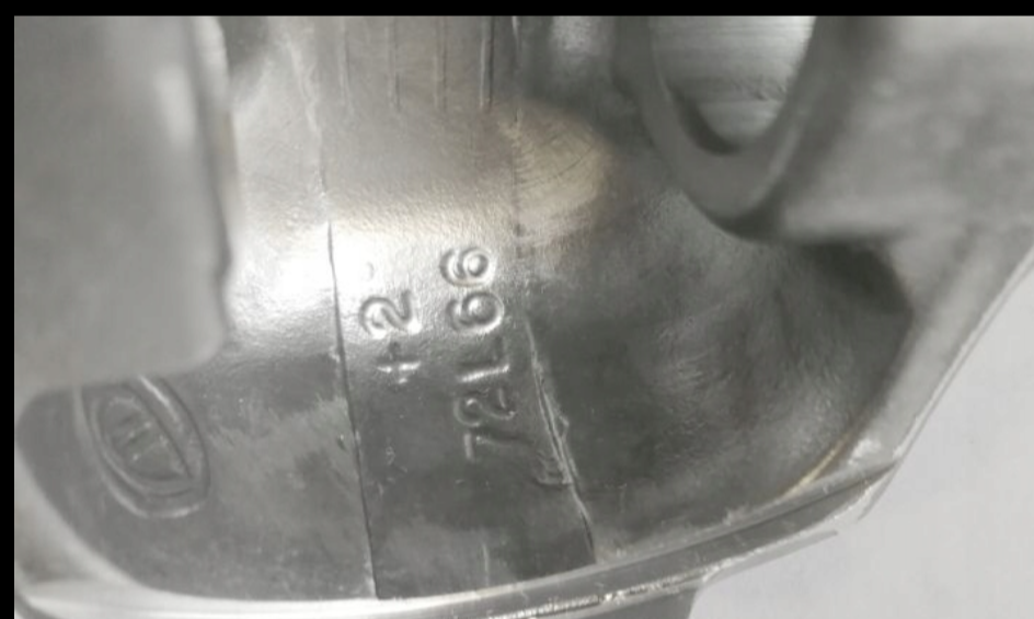

The part number is normally cast on the inside edge of the piston
Eper part numbers will be different as they are a kit including the rings
Unfortunately I can't find any decent photographs of your piston from underneath
Heres the other side of a Tjet piston with some other manufacturers numbers, the fiat part number is on the other side

55277579

55277579

As long as the numbers in the pistons match all is good
You can search via vin number, it will tell you which piston assembly is correct
